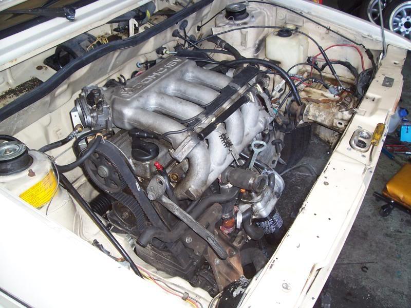

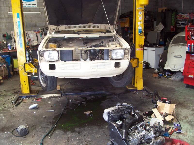

    I pulled the deisel out on wednesday and set about converting the Passat
    9A twincam 2 litre to fit the Caddy.
    I have kept everything in it so as to be able refit the 1.6 deisel if needs be later on. It needs a rebuild though.
    Anyway, heres my progress over the last 2 days...
    Before...
    Out it comes
    Pretty filthy, took some cleaning!!!

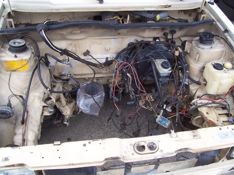

    Where the 2L twincam belongs!!
    Oha... Valver
      It should be a bit of fun. The coilovers will go in after its registed I think. I have the 4 wheel discs off the Passat, after the rust repairs, they go on.The engine pipe and exhaust will hold me up a bit but I should have the wiring and pumps fitted this weekend, Its all fun and I cant wait to have it to use for work duties.
