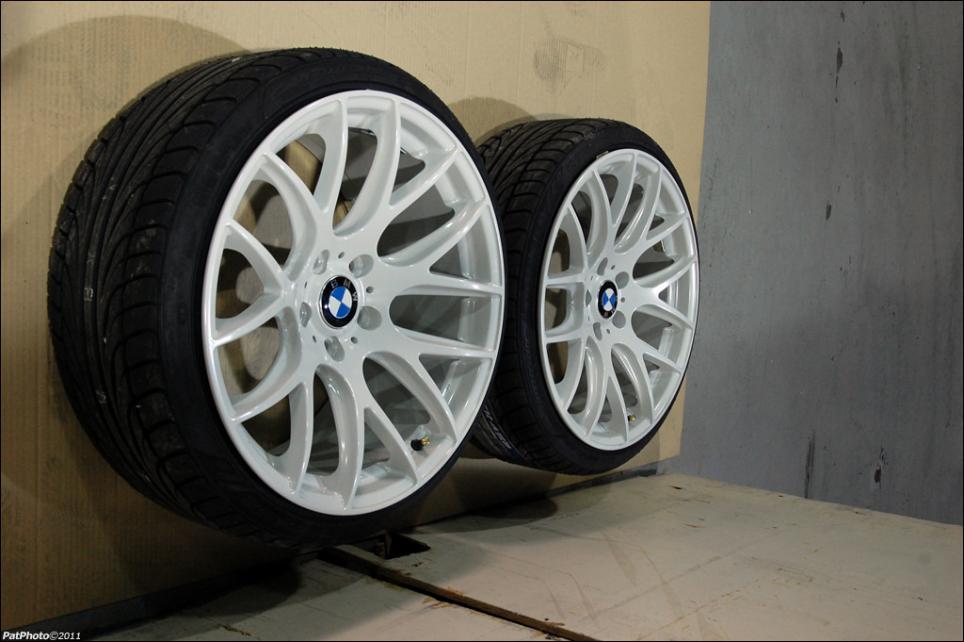

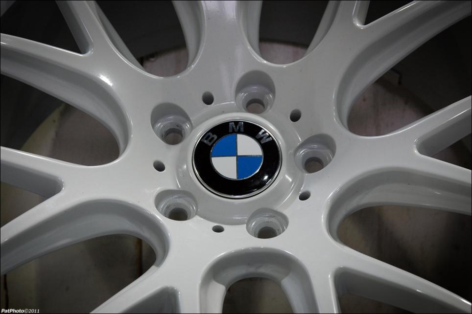

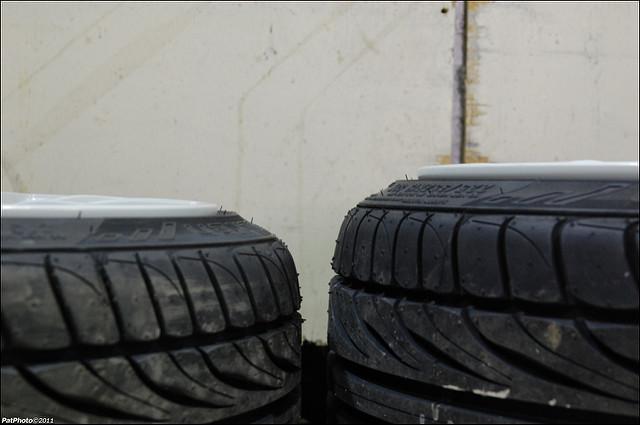

The wheels are 5X120 so using my current adaptors,but to get the rears to sit how i want them it required loosing 3mm off the offset.I had planned to have 3mm machined of the back of the rear wheels,but due to the spoke design it wasn't possible,a solution had to be found fast.The idea came up about taking 3mm off the adaptor face but this would leave the bolts that hold them to the hub sitting proud 3mm(they can't be chopped down,for head strength),so it was decided that we should make little pockets in the back of the wheels to accommodate the bolts.

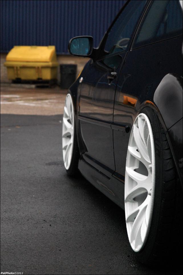

These are 8.5JX19(215/35/19) up front and 9.5J(225/35/19)at the back,both are ET35 but after adaptors they come in at ET19 up front and ET22 at the back,should sit very well once aired out.

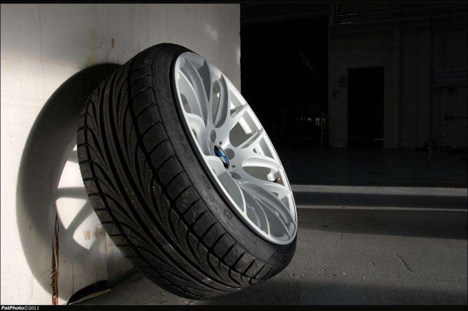

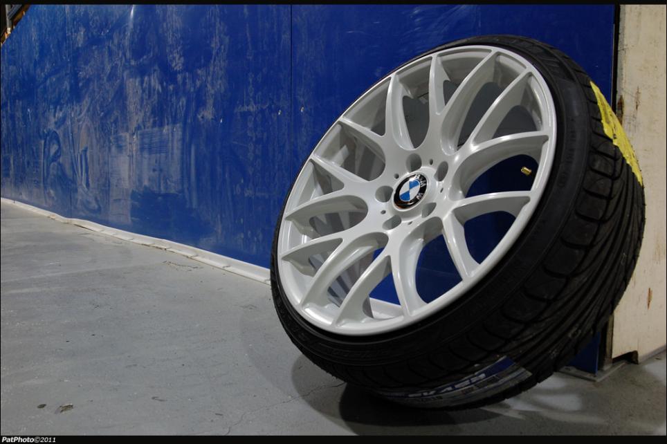

After viewing the wheels in sunlight i wasn't so keen on the colour,they almost look chrome and cheap.......................this couldn't be left alone.
I chose a light grey base coat,a white pearl over the top and a satin lacquer,came out perfect in my eyes.They change colour depending on how the light hits them,from various shades of grey to almost ice white when the sun hits them.

I just had to chime in here, someone showed me a link to this page and holy crap, I am in love. What wheels are they? And hats off to pearl white on wheels, I wanted to do it before I sold my car, they look exactly how I thought they would!!!
If you EVER need to sell those wheels, I'm your man. My new car isn't in the vag family but it has the same stud pattern......lol.
