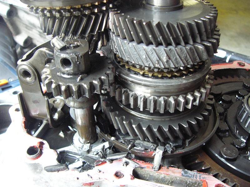

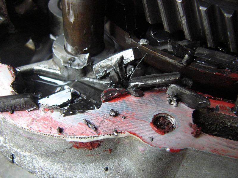

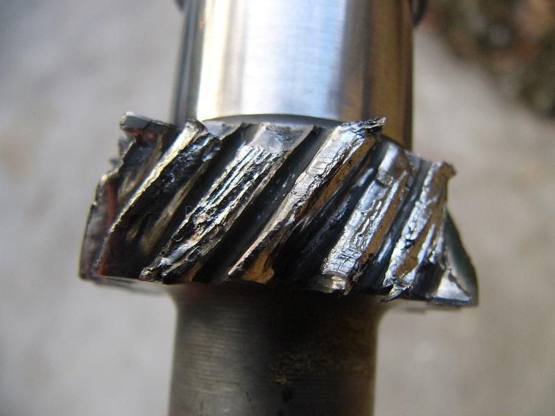

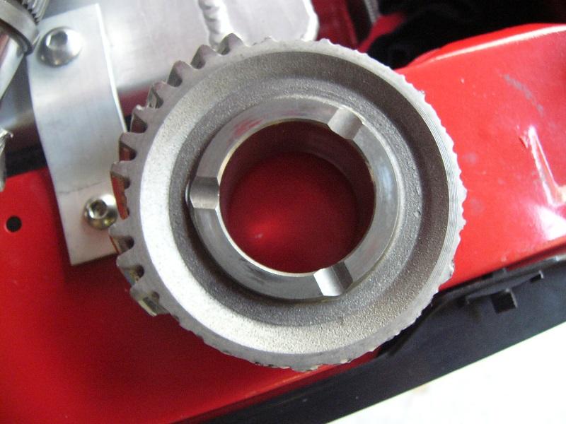

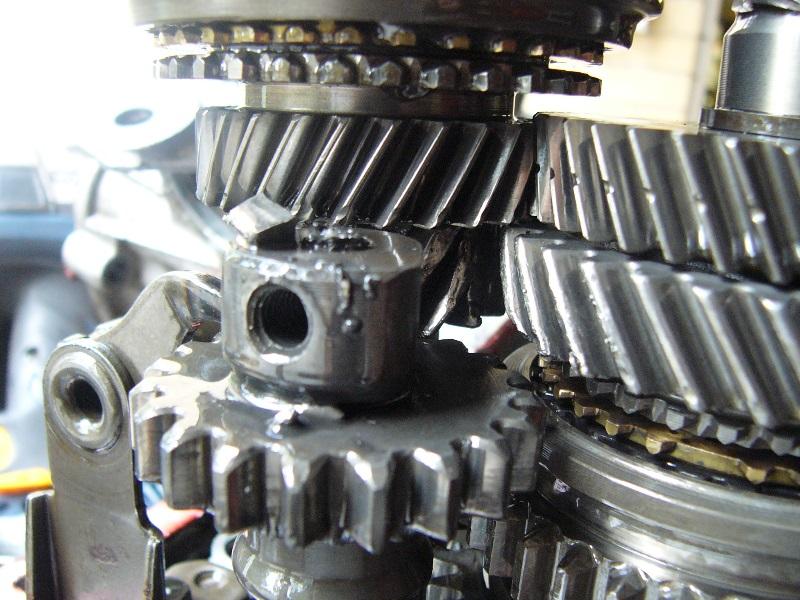

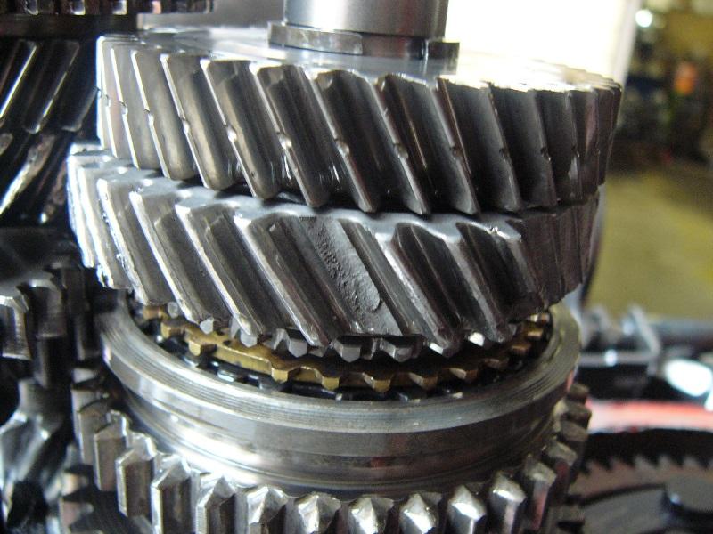

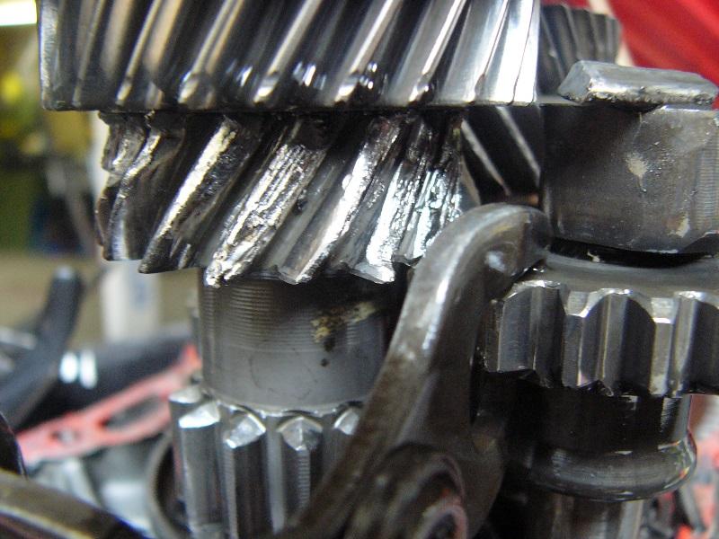

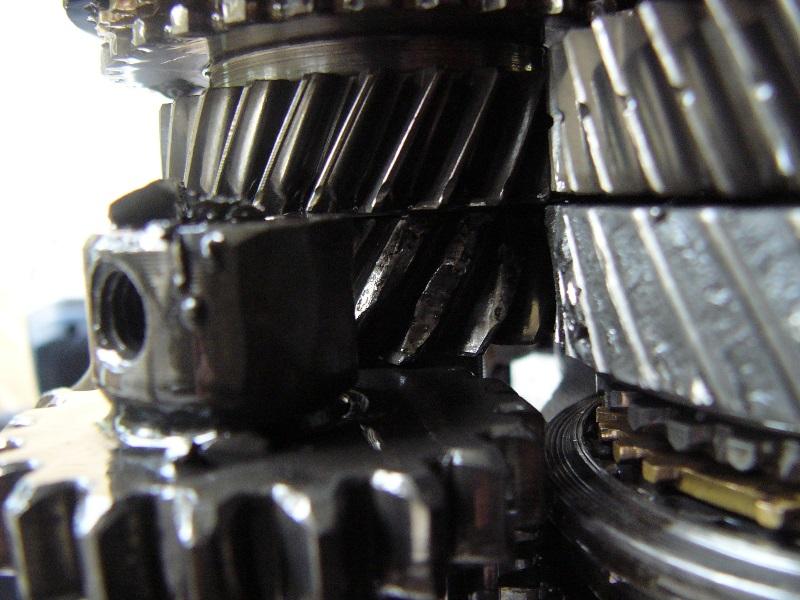

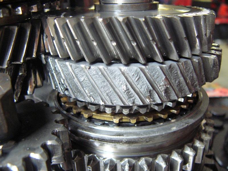

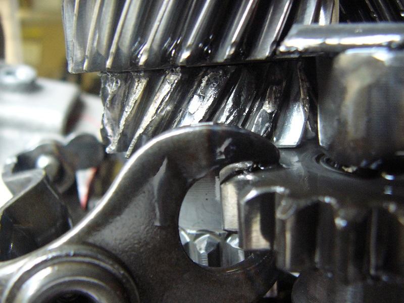

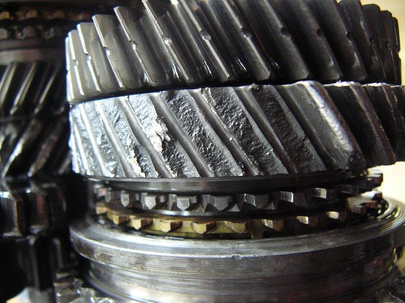

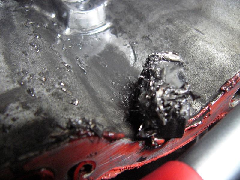

      • Remember that gearbox I blew up at the end of last season? I pulled it apart today to find out what it was that went bang.
        I was in second gear accelerating out of a corner and second gear clearly lost the will to live.
        Rest of the gearbox looks OK. I just need a close ratio input shaft and a new second gear to put it all back together.

          • Given the strength of VW manual transmissions I would think this is not a common parts failure, i have seen first gear cogs stripped because of enthusiastic launches but second gear cogs, could there have been an issue with the clutch engagement that contributed or marginal input shalf alignment to second gear cog?
            Just a thought please continue.
            2.0 TFSI Stage 2 Tune by DriverMotorsport
            • Impressive.
              Just how much power and torque is this engine making?
              • These 020 gear boxes aren't renowned for their strength although it is usually the diff rivets that are the cause of that reputation.
                All these boxes are getting pretty old now could be an age related fatigue thing contributing too I guess.
                Box has about 1000km of race use since rebuild so all the bearings should be OK and looked alright when I dismantled it.
                Redline synthetic oil too.
                Clutch was fully engaged when it blew.
                I down shifted to second on the entry to Honda and was feeding the power back on through the corner. At exit I went full throttle and the gear let loose.
                I captured it on video too!
                I think the difference this time was traction. This is the first occasion I'd gotten my Hoosier slicks up to temp. Normally I'd be spinning the wheels out of this corner, This time it hooked up and blew the gear.

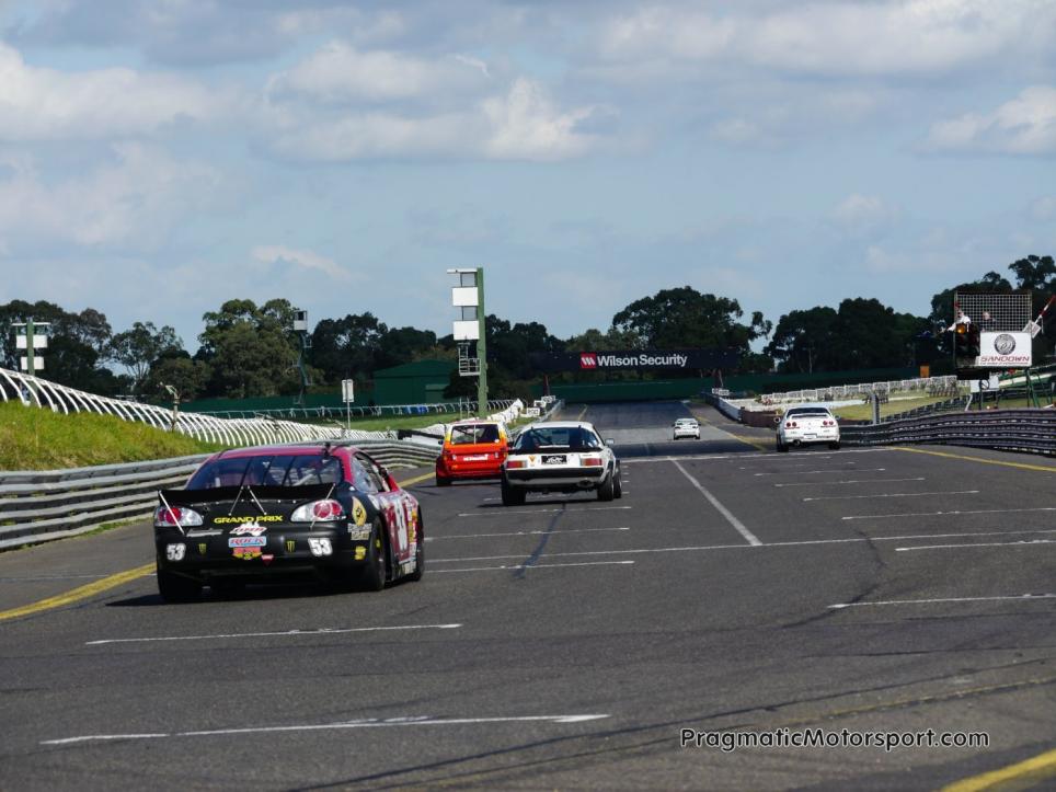

                    • Crappy day of racing at Sandown today.
                      Cam Angle sensor issues kept shutting me down.
                      My best and only timed lap was 1:32
                      However I was still faster than the only other competitor in my class and about 28th overall in a field of 81.
