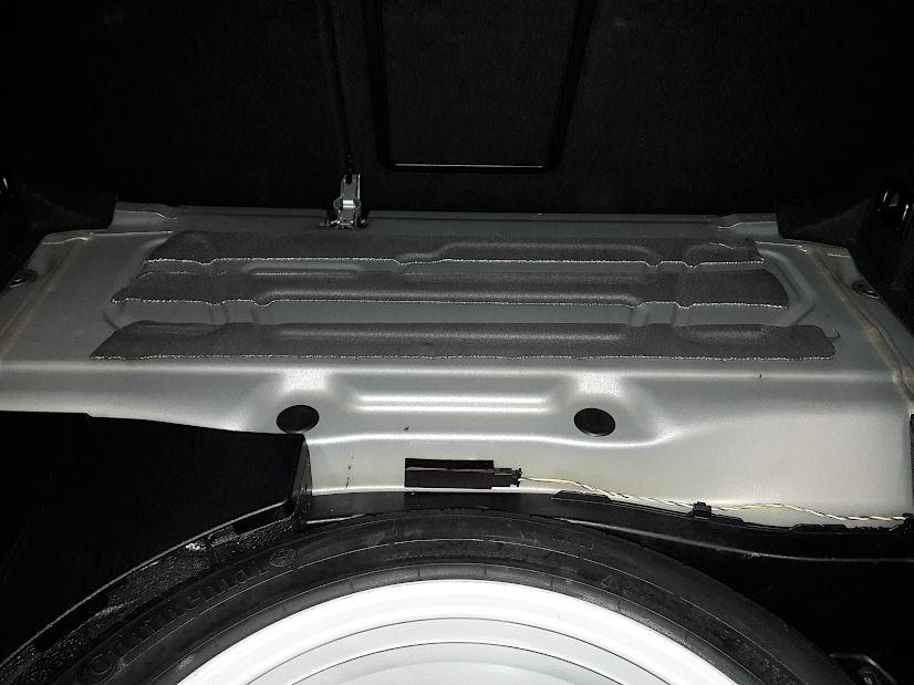

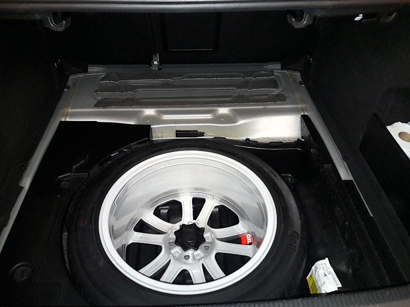

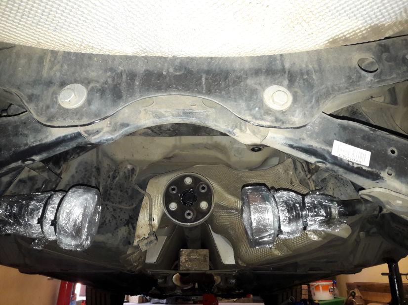

Before I can take out the diff there are two bolts that I need to access from inside the CC.
This will be from the boot area.

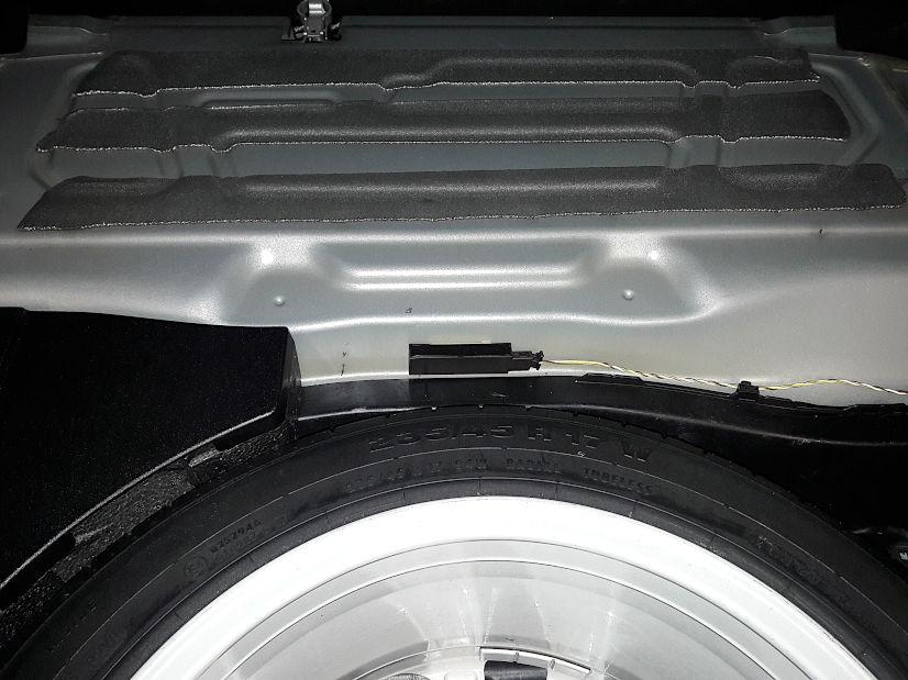

I need to drill two large holes in the body to access those two bolts, to loosen them for the diff.
You'll see two dimples on the body, just above the spare wheel.
The two holes drilled.

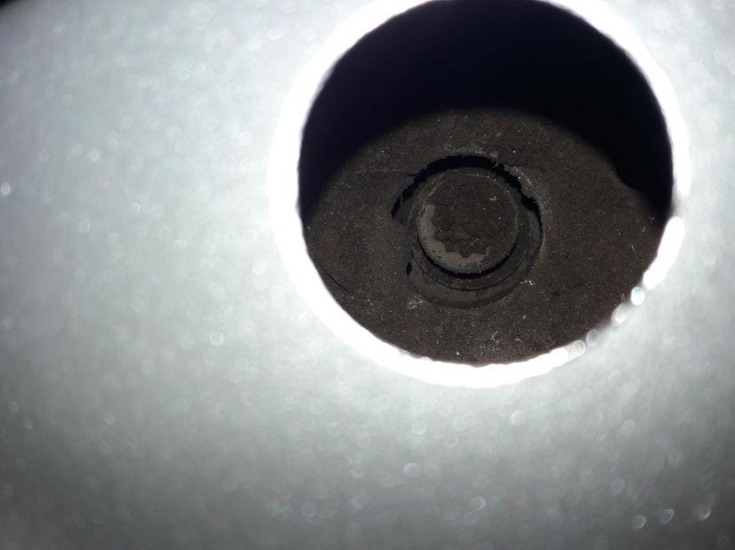

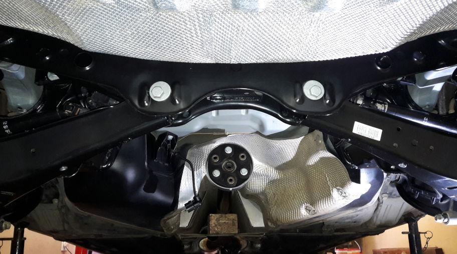

The bolt that needs to be loosened for the diff to come out.

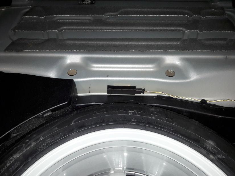

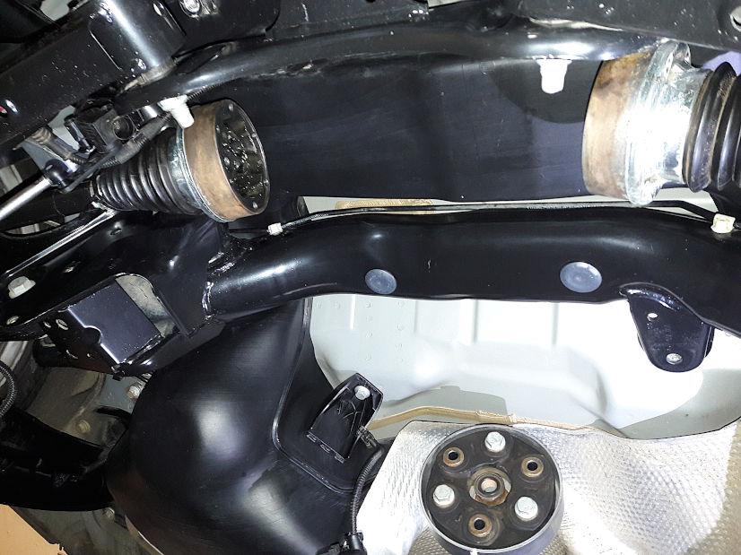

Once the diff was installed, I need to close off the two holes that I drilled through the body.
VW has the plugs for it which I bought and installed them.

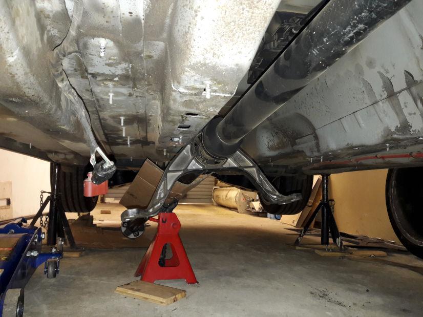

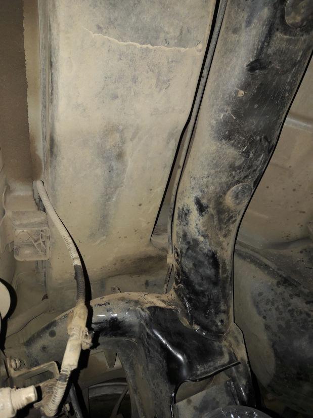

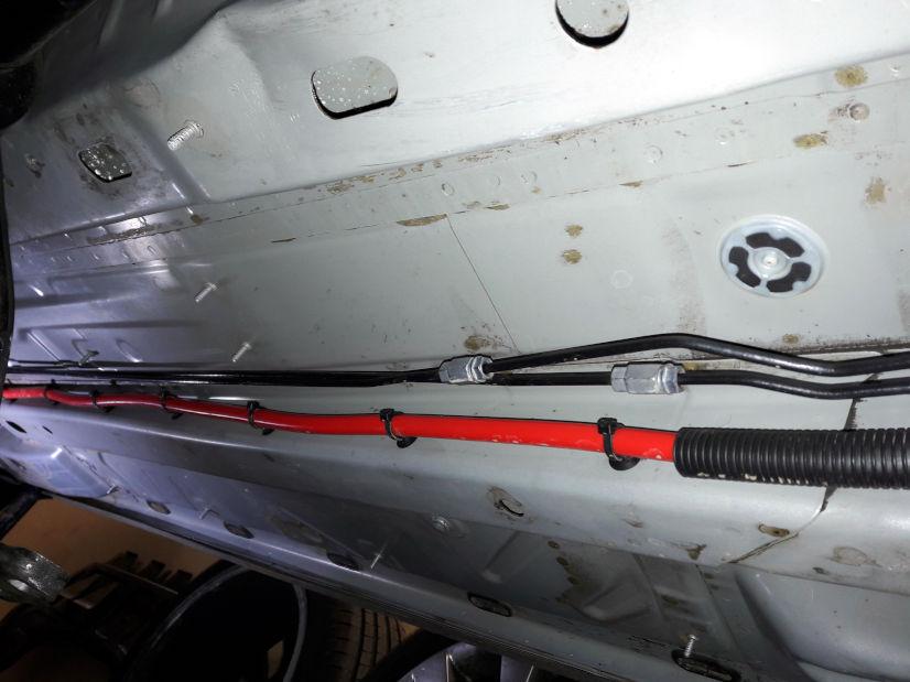

The undercarriage covers has seen better days so I decided to strip them out.
You can see how dirty it is under there.
So I went on a cleaning spree.

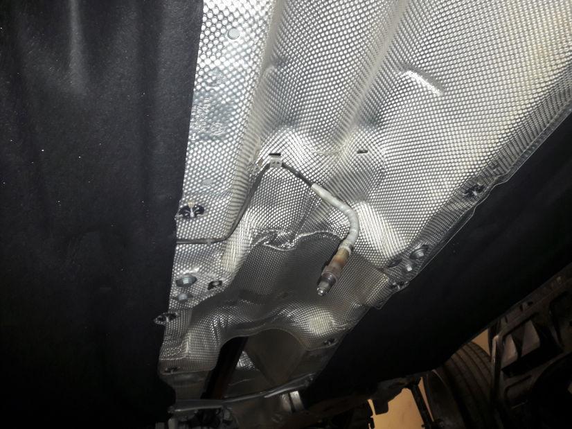

I stripped out all under linings covers, including all the wheel arches.
It wasn't easy cleaning everything, laying on the creeper, scrubbing, water running down your arms, etc...
Also it taken some considerable time as well, but the results was really satisfying.
Just need the last rinse, but looks far better than before.

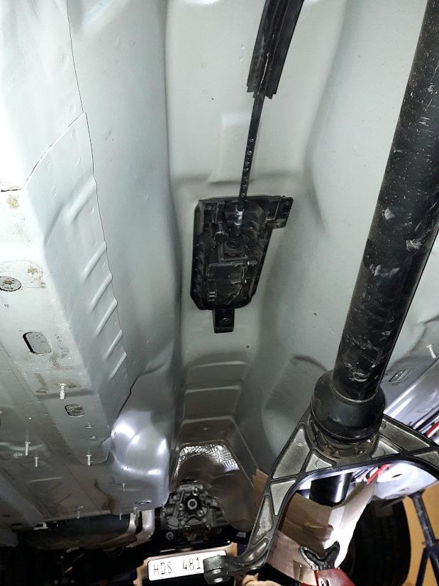

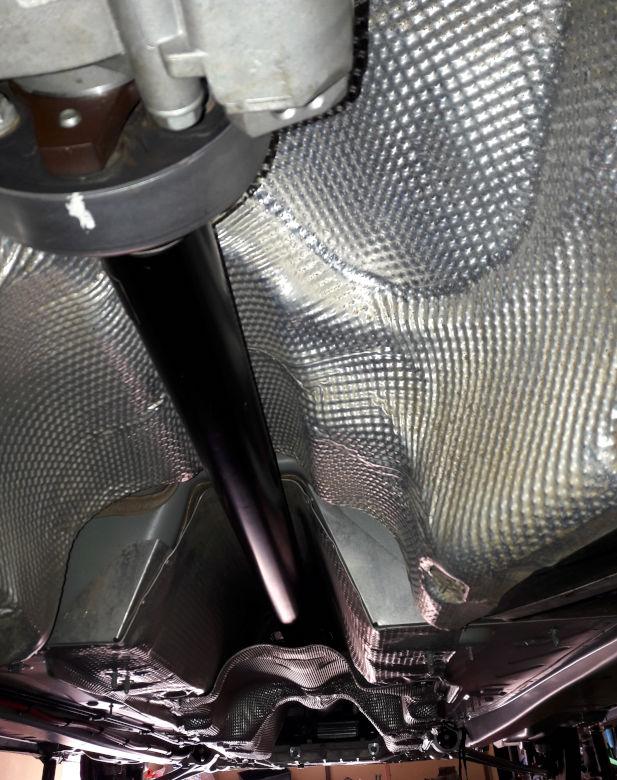

The propshaft, the heat shields installed and the new undercarriage covers installed.
From underneath it looks like a new car.
