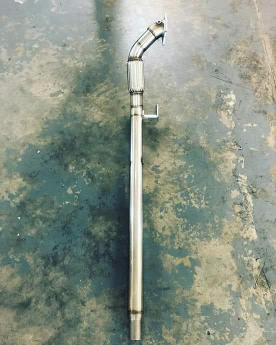

      With that in mind I decided to buy an aftermarket downpipe for the Golf MK6 R.
      The new Golf MK6 R downpipe.

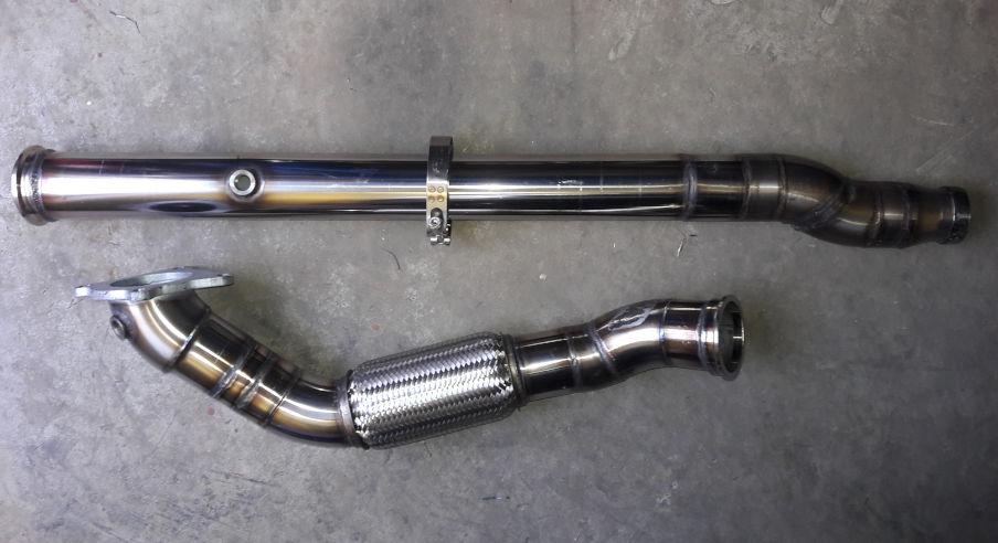

      I did try fit it and it did not. As I suspected the engine sits further to the front than the Golfs.

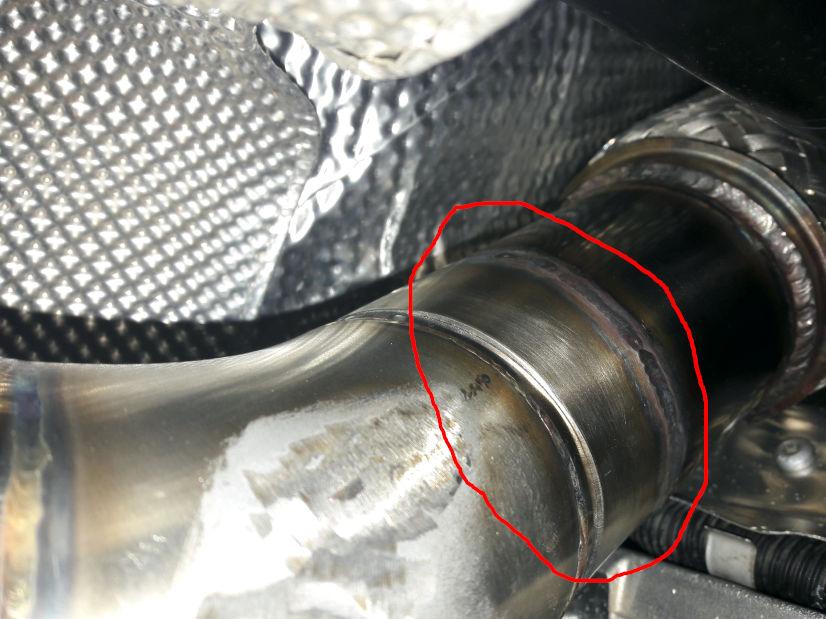

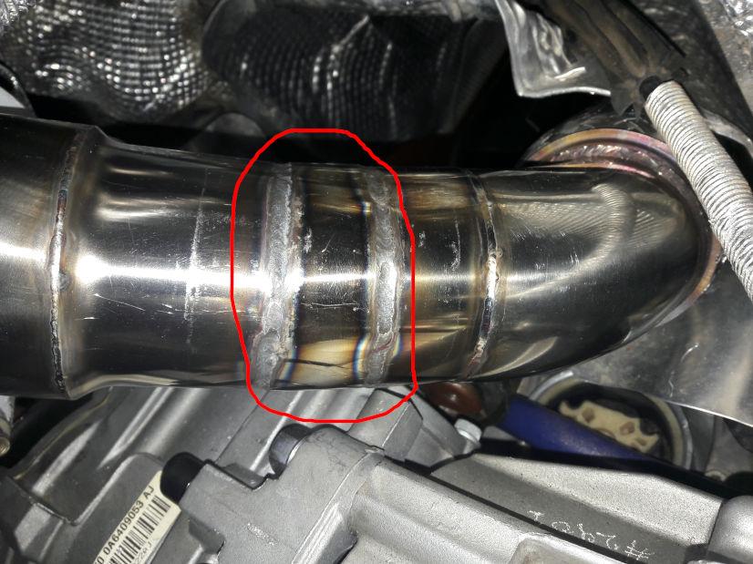

      Time to whip my Tig Welder out and make it fit.
      The little section that I need to add on, just after the turbo outlet.
      Just making sure that the added pipe section is correct before welding the other pipe on that goes towards the stock exhaust, underneath the car.

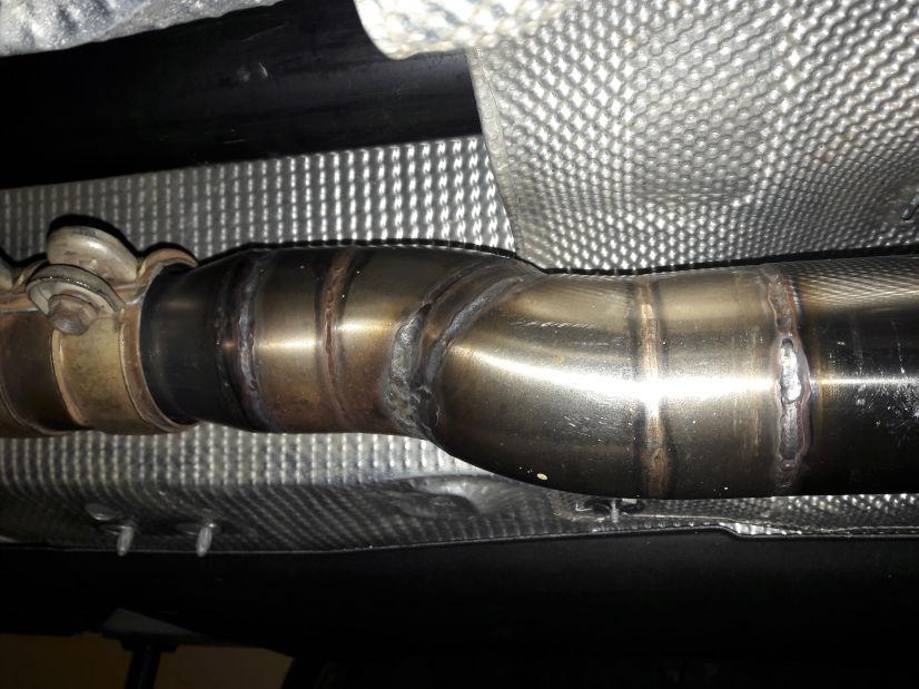

      The pipe that needs to go into the back stock exhaust.
      Need to make a S joint here.
      The S joint made.

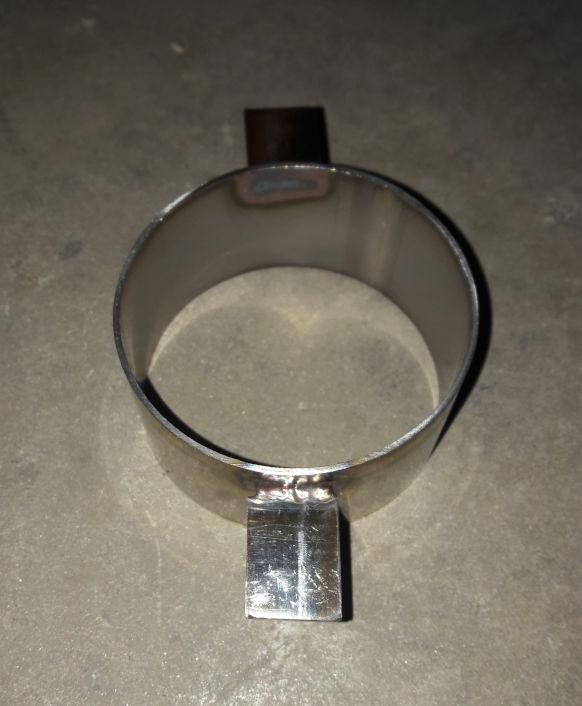

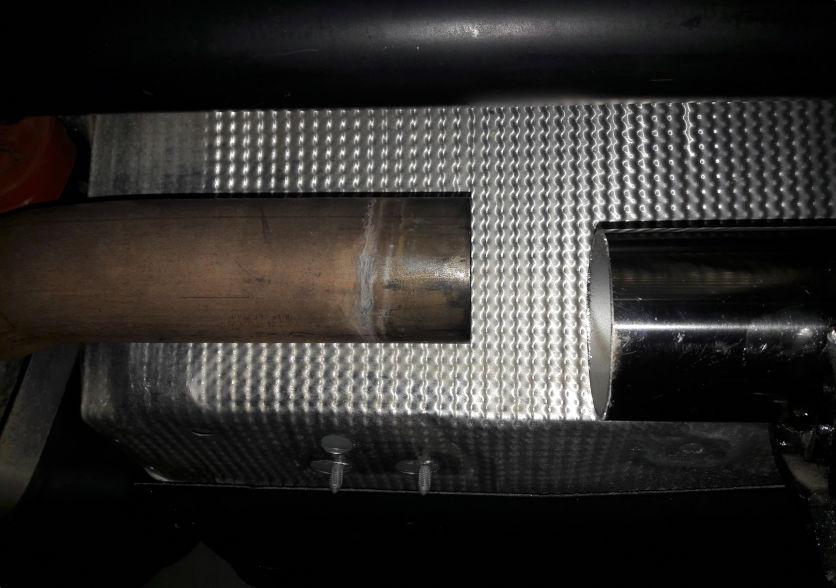

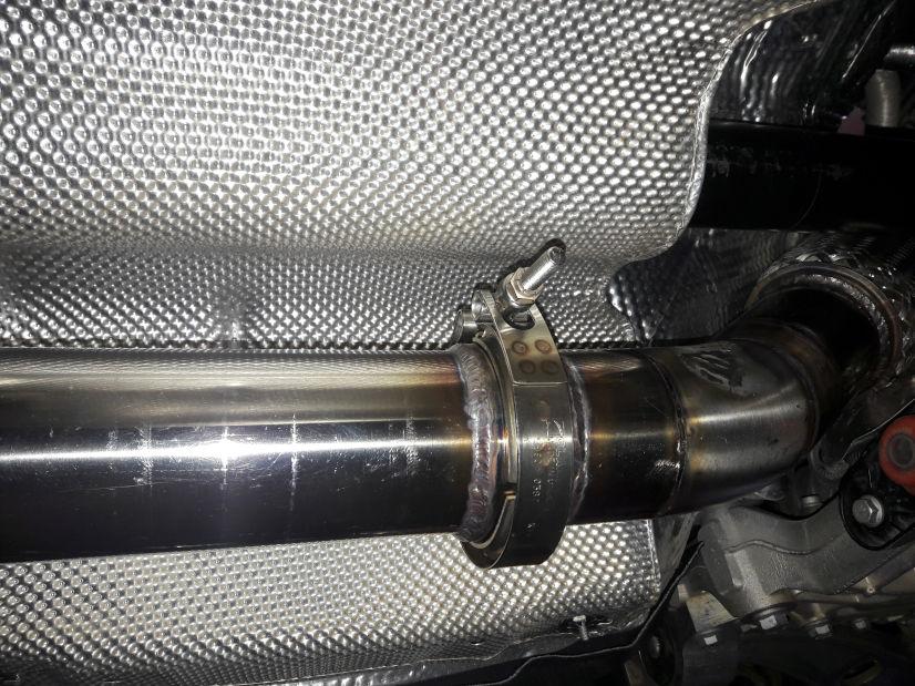

      I decided to install a V-Band connection, so it is easier to remove/install the downpipe.

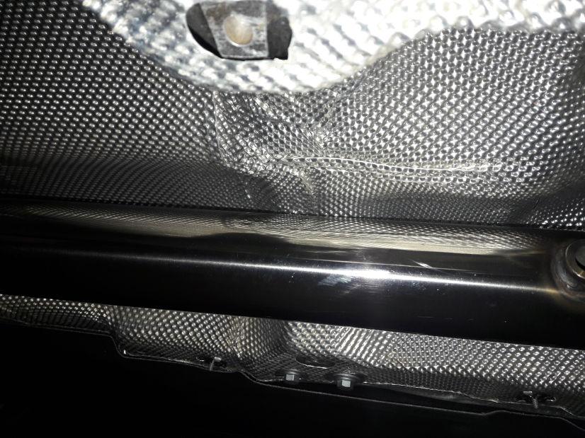

      The straight section is literally millimeters away from the prop shaft bracket.
      The end result of what used to be a downpipe for the Golf MK6 R.
      Installed it and sounds okay, a bit quiet but okay.
      I'll build one in the future sometime to replace the stock back piece.

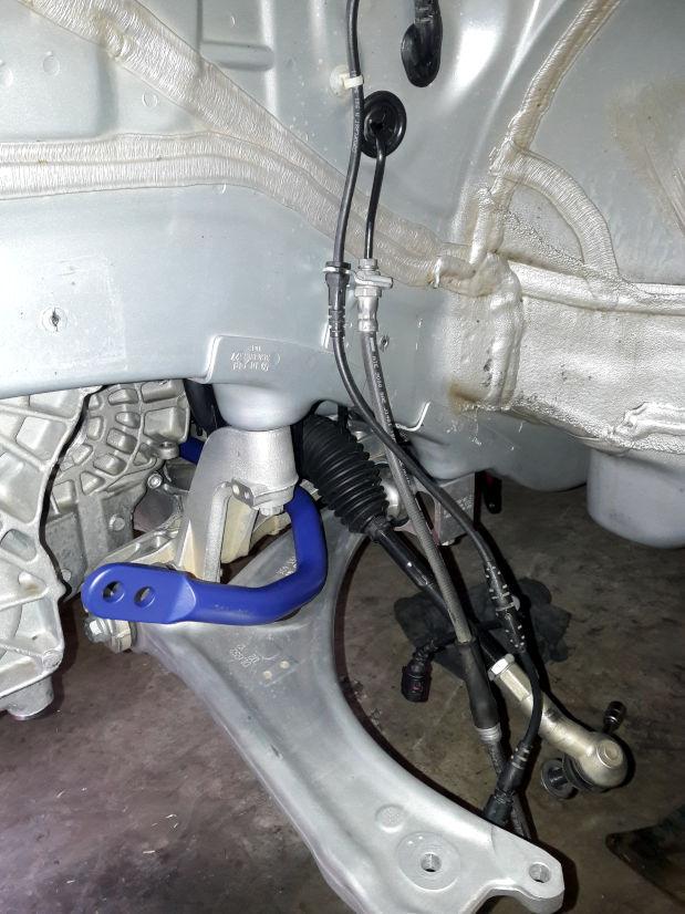

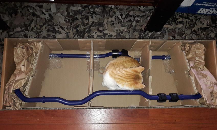

        The H&R front/back sway bars.
        My cat Sniffels approves.

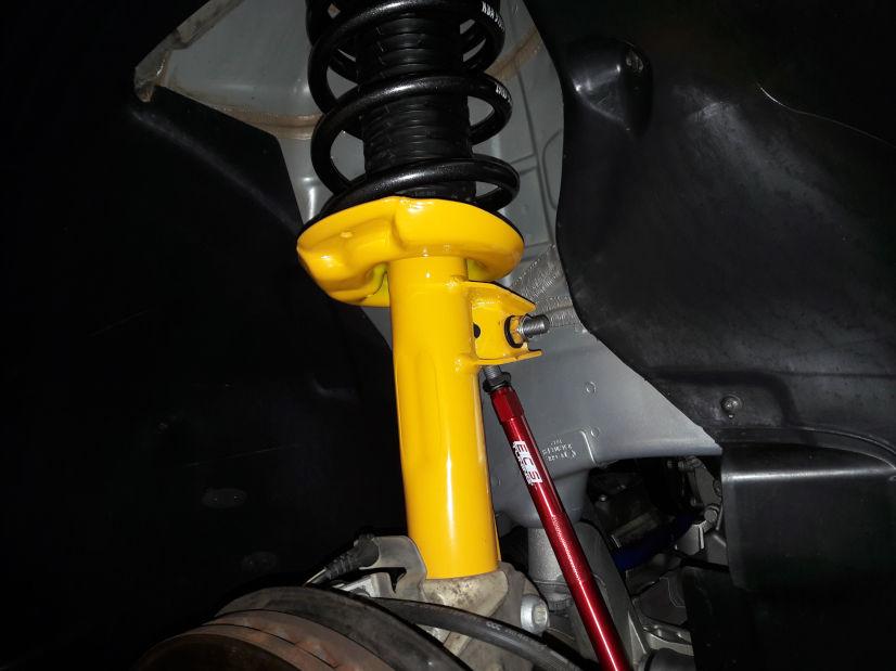

        The front left wheel arch area.
        Cleaned it nicely and ready to receive the suspension components.

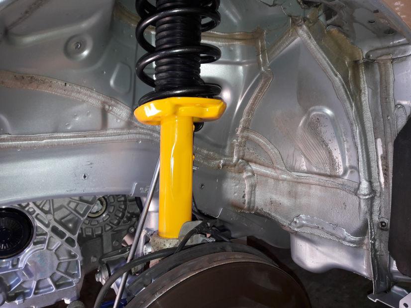

        The Koni shock and H&R spring installed.
        Also installed the ECS end links.
        Notice the new plastic liner.
        I've replace all front wheel arch liners, skid pan and covers.

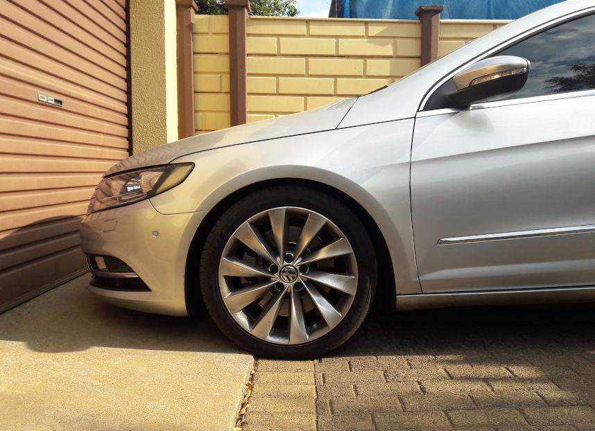

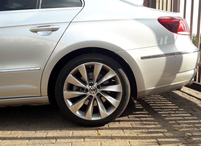

        The end result.
        Notice the rake look. The front is lower than the back.
        The front height.
        The back height.

            The ride quality of the suspension is slightly better than my MKV Golf R32 (R36) on stock springs, shocks and front sway bar. It has the H&R back sway bay.
            The handling is pretty amazing and handles far better than my Golf R36.
            I had to adjust the front shocks damping rate once and the back shocks damping rate twice.
            Originally, I had the back Koni shocks damping rate turned up to about three quarters way of the available one and a half turns. It was harsh.
            Turned it back to about half way of the available one and a half turns. That was still a bit harsh.
            According to Koni the minimum setting is the stock damping rate.
            So on the second try, I decided just to do a 90 degree turn from minimum and was happy with it.
            The problem with the back shock adjustments is that you need to strip out the shock to do the adjustments.
            The front shocks has the adjusters on top of them, which is simple to adjust without taking them off.

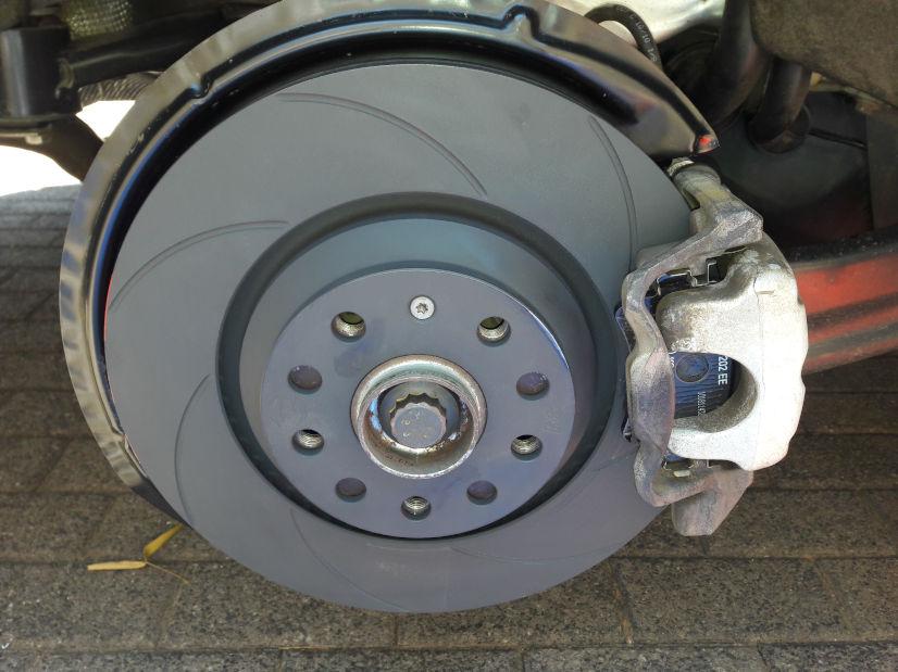

            The next step is to get a slightly better brake setup than the stock setup.
            I decided to try out the PowerBrake setup.

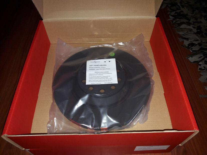

            Got the Powerbrake disks for the front and back.
            Used the Endless pads for the front and the Mintex Red pads for the rear.

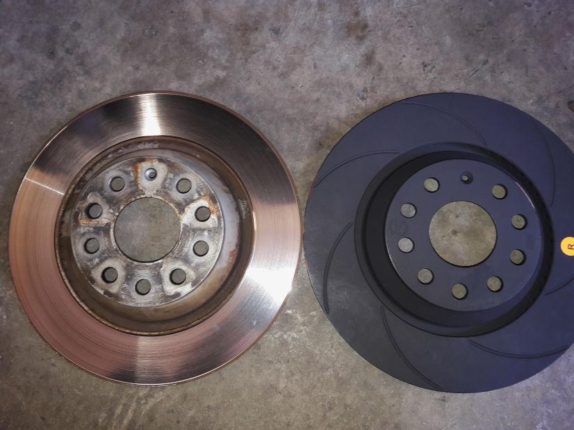

            The rear Powerbrake disks and pads.

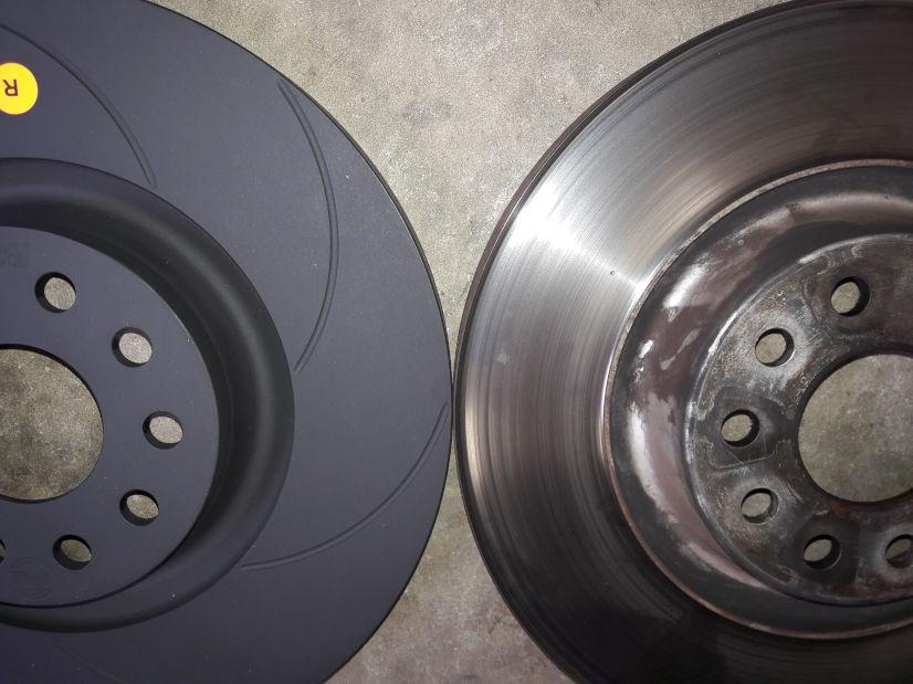

            The side to side comparison of the rear PowerBrake and stock disks.

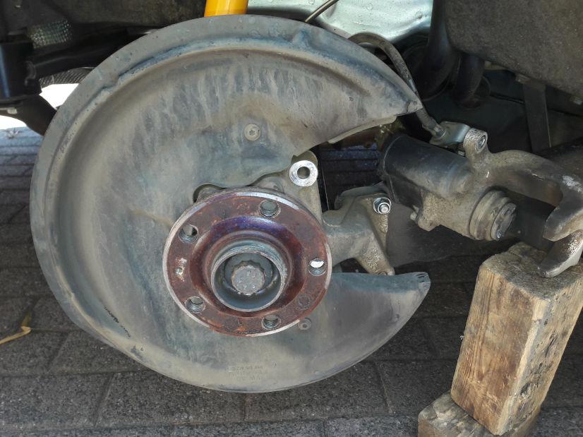

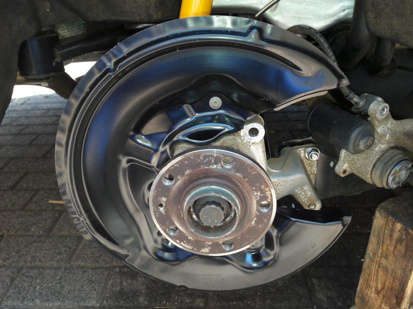

            The rear needs some cleaning.
            Nicely cleaned up and ready to received the new disk.
            The installed rear disk and pads.

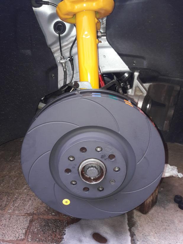

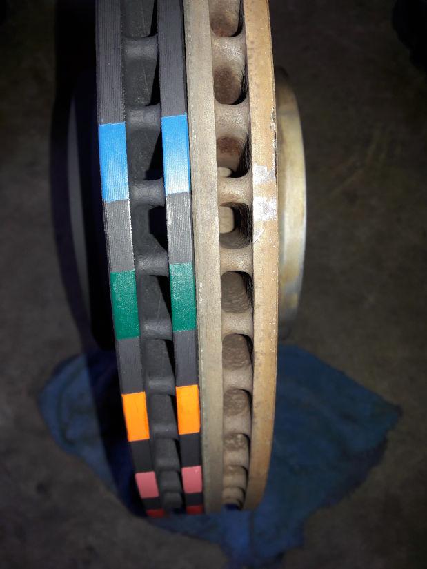

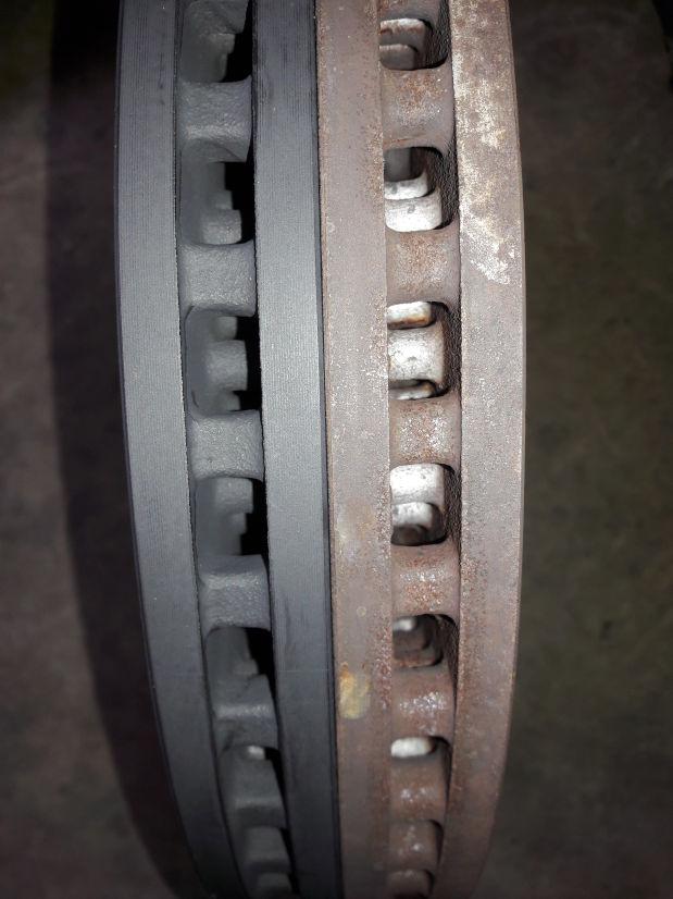

            The side to side comparison of the front PowerBrake and stock disks.
            The front PowerBrake disk installed.
            There's a definitely a big difference when braking heavily from high speeds.
            The PowerBrake is so consistent and doesn't fade compared to the stock setup.
            Really happy with it.

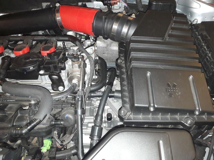

            Since the VR6 CC also had the battery at the back in the the boot, because of the space taken by the big air filter.
            I decided to use the VR6 air. But there was another reason that forced me to use the VR6 air filter.
            With the DQ500 oil cooler placement the original battery cradle of the 2L, were the 2L air also bolts on, doesn't fit.
            The DQ500 oil cooler stands too high.
            The VR6 air filter cradle fits in nicely.
            Since the pipes from the VR6 air filter box to the 2L turbo intake pipe does fit I had make a makeshift pipe from the air box.
            Made this adaptor to replace the VR6 MAF sensor housing that was bolted to the air box.
            The end result. Not a very neat setup but it works well.

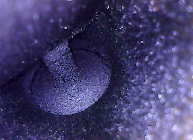

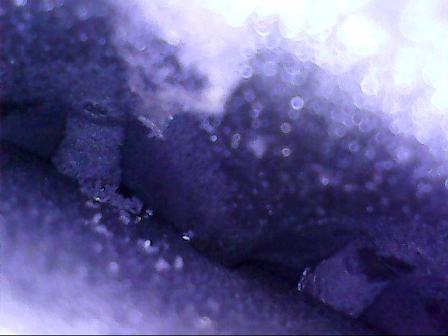

            Before installing the engine I wondered how bad the carbon build up was like in the intake valves.
            So I bought a couple of cheap USB borescopes.
            This is the result, the bottom part of the intake valve. You can see that the flap is in the way on the top left.
            The top part of the intake valve. You can see the that the flap is in the way on the bottom left.
            As you can see the carbon build up is not to bad, so I'm not too concerned about it.
