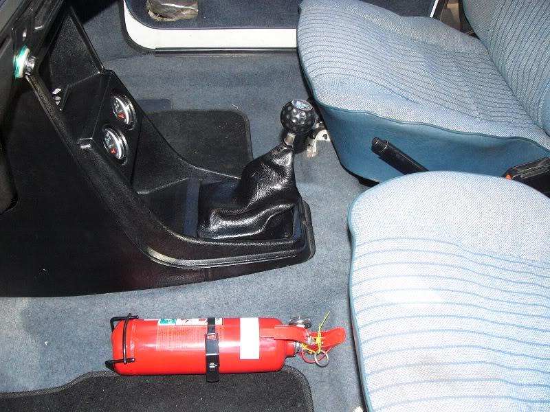

    Both of mine are in front of each seat so in reach of the driver and co driver when they are harnessed in their seats as per the CAMS regulations.
    Wherever you decide to put them make sure they are secure (IE not just cable tied in) as the last thing you want is a 5KG metal missle flying around the cockpit if you have a big off. Pictures below and more general pictures of them in the interior can be seen in my gallery here

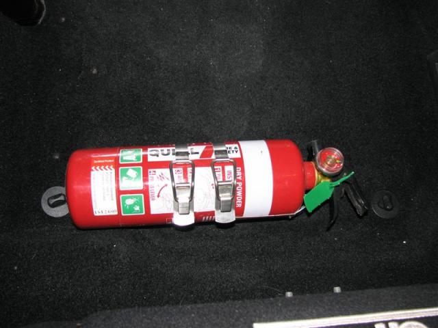

                It looks like i may just have to screw it to the floor somewhere. I was just hoping that someone else had done this to their streetcar already and could give me some tips. Thanks Quozl for the pics, i think i will try the same.

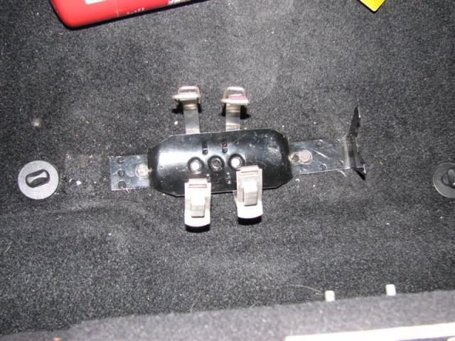

                  Passenger side footwell.
                  Captive end of bracket forwards.
                  Mounted through floor with grade 8.8 M6 bolts and mudguard washers either side of bracket and floorpan.
                  Loctite on bolts.
                  Gauge against tunnel to prevent passenger from damaging it .
                  Passed CAMS Scrutineering @ Phillip Island April 2008
                  Australian Standards approved extinguisher purchased from Autobarn
                  Packaging also indicates CAMS approval.
                  Scrutineers will check fixing, condition, clamps, pressure, safetys and dates.
