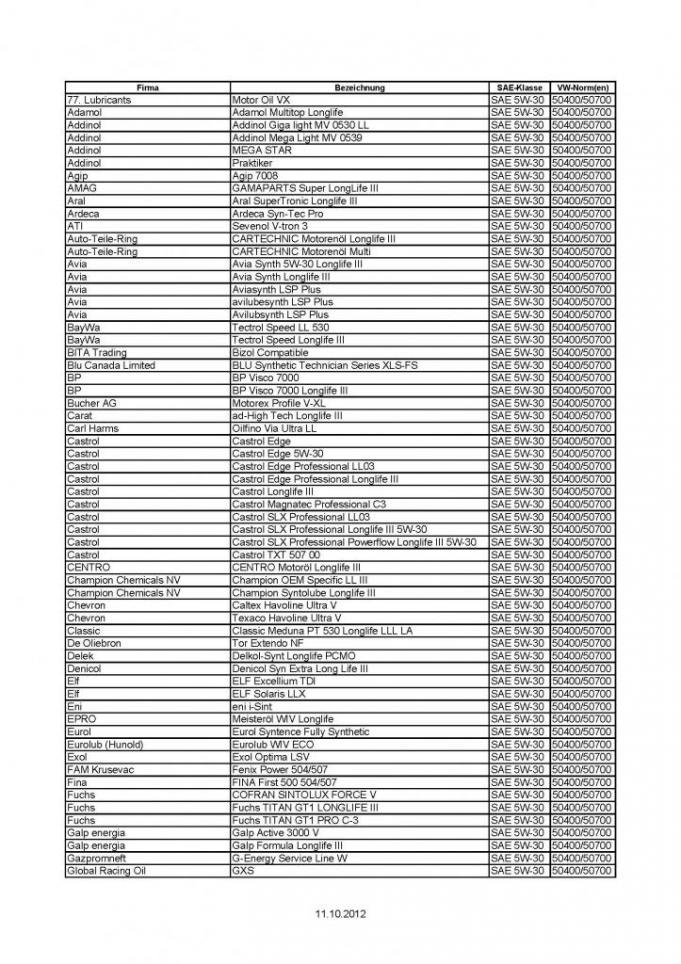

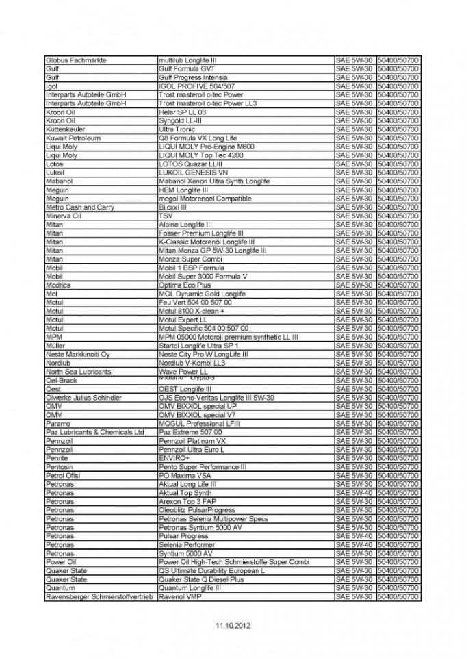

              SUPERCHEAP are selling Penrite ENVIRO+ 5w -30 which is 504/507 VW approved at $69.95 ATM

                  Penrite Enviro+ is on the approved list on ERWIN On second page after Pennzoil Have had it used on my Polo by trusted Sponsor
                  Is this the same as yours

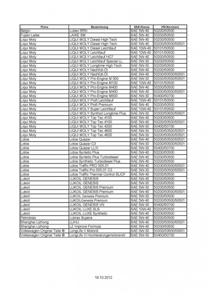

                      Does the Liqui Moly list match yours is why I posted it
                      Mamba Ebike to replace Tiguan
                      • #26
                        TopTec 4200 is what Liqui-Moly Australia stock, to cover 504/507.
