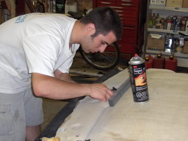

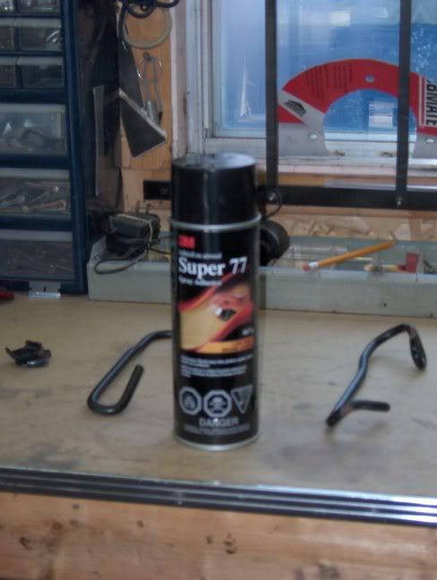

                    1- What I did is that I got 2 BIG cans of 3M Super 77 spray adhesive:

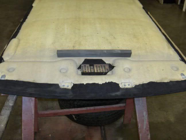

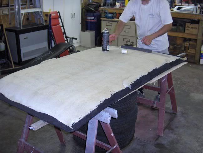

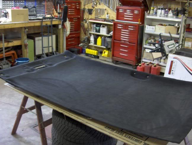

                    3- I started by laying-out the fabric on the headlinner and cut off excess. Made sure I was setting the head linner on a solid surface.

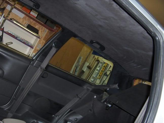

                    4- I left about 6 inches all around to make the final edges and give slack for all the recesses to get filled. Note that the picture was taken after everything was stuck on. The 6 inches I left turned out to give me enough to do the edges.

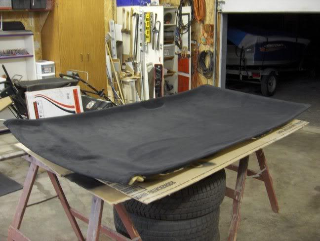

                    5- Once layed out flat and trimmed, I over lapped the fabric on it self, using the rear handle recesses as an imaginary guide line. There fore, I had both suede sides facing each other, folded one on each other, revealling the rear of the head liner from the handles to the back.
                    6- I applied some of the spray adhesive, going from the left of the head linner to the right, moving towards the back only about 15-18 inches. I then added a coat on the back side of the suede in the same motion. While doing this, it allowed the coat on the head linner to cure a little. I then added a second coat going from back to front ( opposite direction ) and did the same on the fabric.

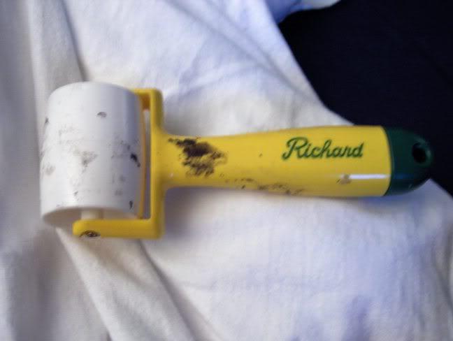

                    7- I used a Richard's yellow handle fabric roller (seen in this pic...) to roll the freshly glued fabric in all the corners.
                    8- Once the fabric rolled in, I proceded to move towards the back an other 1 ft or so repeating steps 6 and 7.
                    9- Once the back half was done to satisfaction, I flipped the other half of the non glued fabric over the newly finished glued back half.
                    10- Repeated steps 6 and 7 for everything done towards the front.

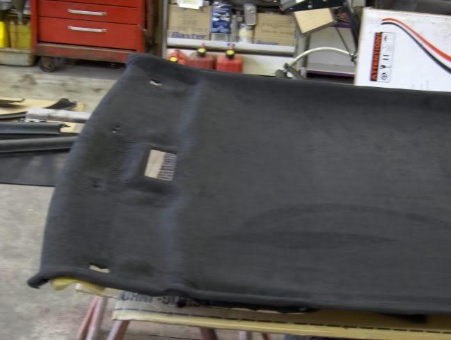

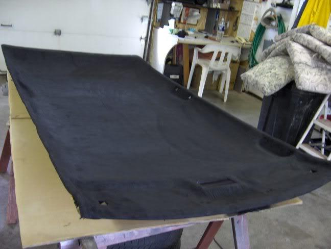

                    11- I started doing the edges and folding them back. By now you should be runnig low on glue. It is important to apply lots of it and wait between coats for it to cure to have optimal results, as I have seen some that have been cheap on it and their ''new'' head linner is already sagging!

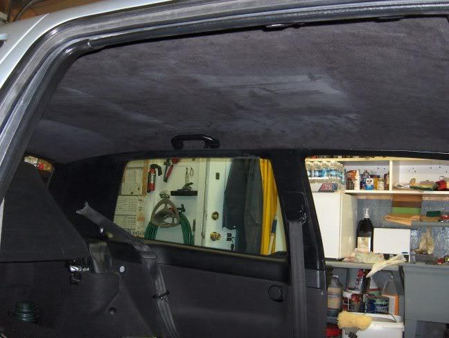

                      12- Cut out all holes and reinstall linner.
                      13- Have a sit in theese...

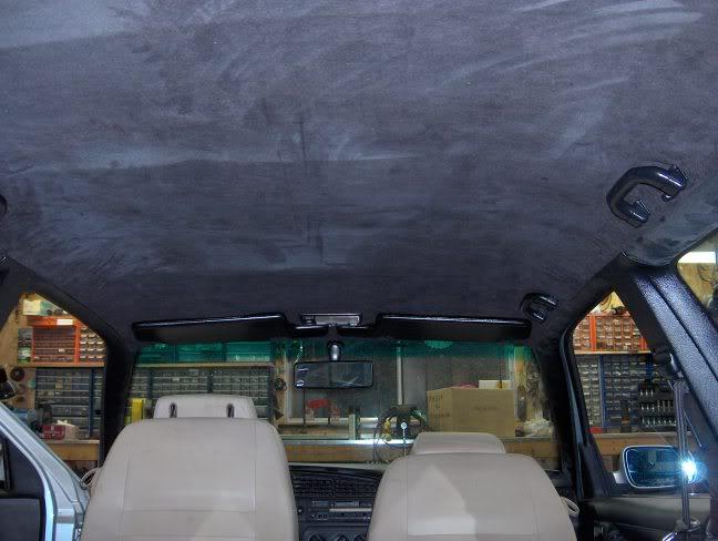

                      Enjoy what you have accomplished!
                          If I can give a hint, it would be wise to cut an X ( corner to corner ) where the Dome Light Switch goes prior to rolling it once glued. It will allow you to roll the fabric correctly into that curb ( right where the miror is, between the switch and windshield ) and reduce the chance of having creasses.
                          Make it a bit smaller that the actual cut-out, cause you will want to make a nice border after. Besides, you don't know exactly how the fabric stretches and you could end-up having a cut in the fabric where you don't want to.
