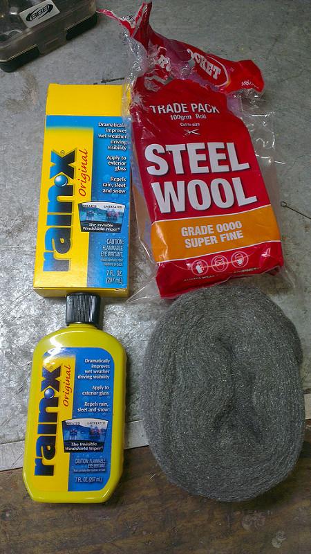

        Another thing to try is either a razor blade or very fine steel wool and rub this on the outside of the glass. Use windex or water as a lubricant. Make sure you clean the glass prior to using this to remove any dirt.
        I regularly use the razor scraper method with windex as a lubricant, and then polish the glass afterwards with Autoglym window polish (although any polish will do).
        Steel wool grade 0000, lots of it, $3.61 at Bunnings.

              The razor blade and/or fine steel wool is safe to use and works well. Dont worry, i wouldnt recommend you use them if they were going to cause damage to your car. I am super mega fussy with both my car's and use the razor blade on the windows several times a year.
              If you scrape the glass at an angle of say 60-70 degrees, the blade literally slides over the glass and pics up any foreign matter such as tar/fallout/overspray etc. Im sure there are some videos on YouTube showing this method - might be worth a quick look.
