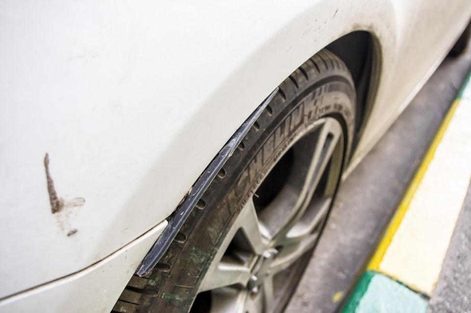

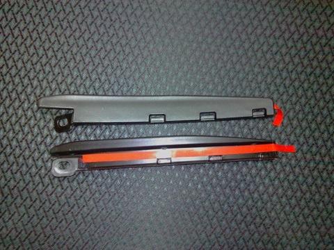

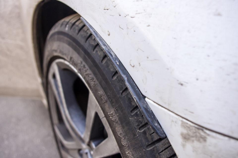

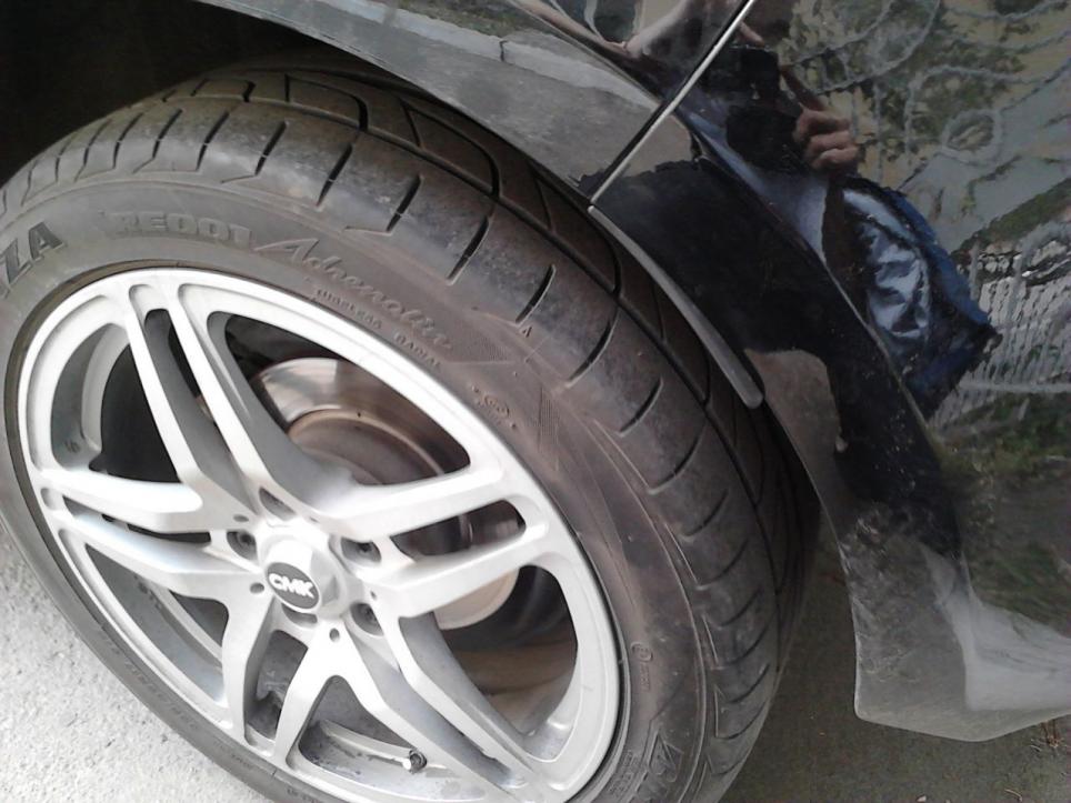

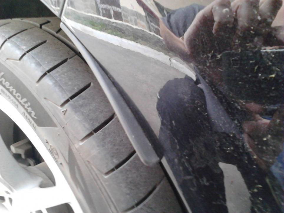

                Info and pics below are showing these little extensions on a Golf R, but i assume this is what the OP is trying to explain.
                Bold-Sport.com :: Golf R Plastic guard/ Fender extensions - Set of 4
                Part Numbers:
                Drivers Side Front/Front Right: 5K0807824B
                Passenger Side Front/Front Left: 5K0807823B
                Drivers Side Rear/Rear Right: 5K0807834
                Passenger Side Rear/Rear Left: 5K0807833
                I lost my driver side rear/rear right one (Part # 5K0807834) and ordered a new one through VW for $44. So they are not cheap.
                Some random photos from the interwebs to be clear on what parts I am talking about:

                  That's what I was referring too. I had the same on my Passat with Sports Pack.

                      yes that is correct - only the Golf R's with the optional 19" wheels have these little plastic guard extensions front and rear. If the car is not optioned with the 19" wheels (standard rims are 18" in the same shape/style) then the car will not have the plastic extensions fitted.
