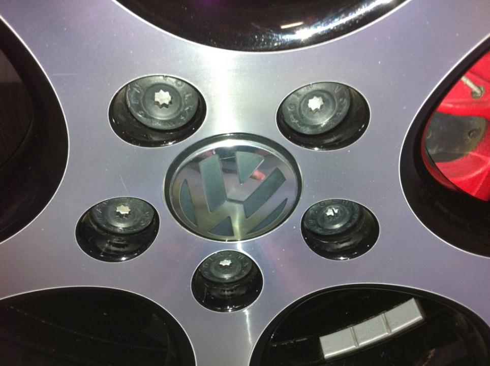

Trap for young players with black rims around where the wheel bolts are......

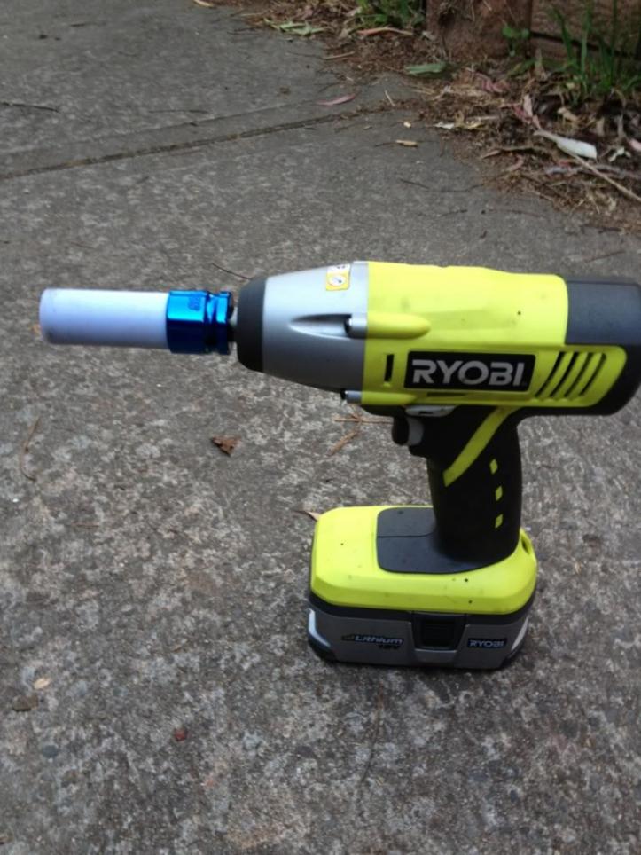

Place a piece of soft tape around the wheel brace/socket to ensure the metal doesn't come in contact with the painted section of the rim and possibly scrape the paint.......see attached pics;
Enjoy!
Stu
