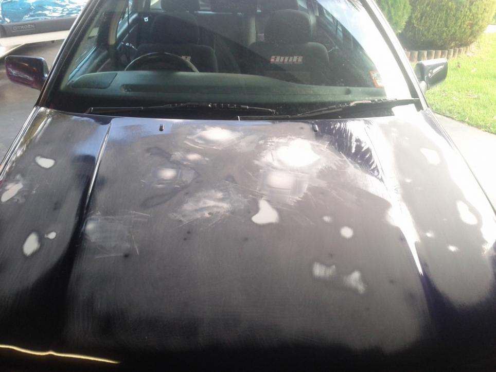

Grab your applicator, and scoop up some Body Filler, then apply to the dents, making sure to go a bit past the edge of the dent so you can smooth out.
Don't put too much on, or else you will be sanding forever!
Once you have applied putty to all the dents and are happy, it should look something like this:
It hurt me to see my bonnet looking like that, but within a few hours it was better than ever!

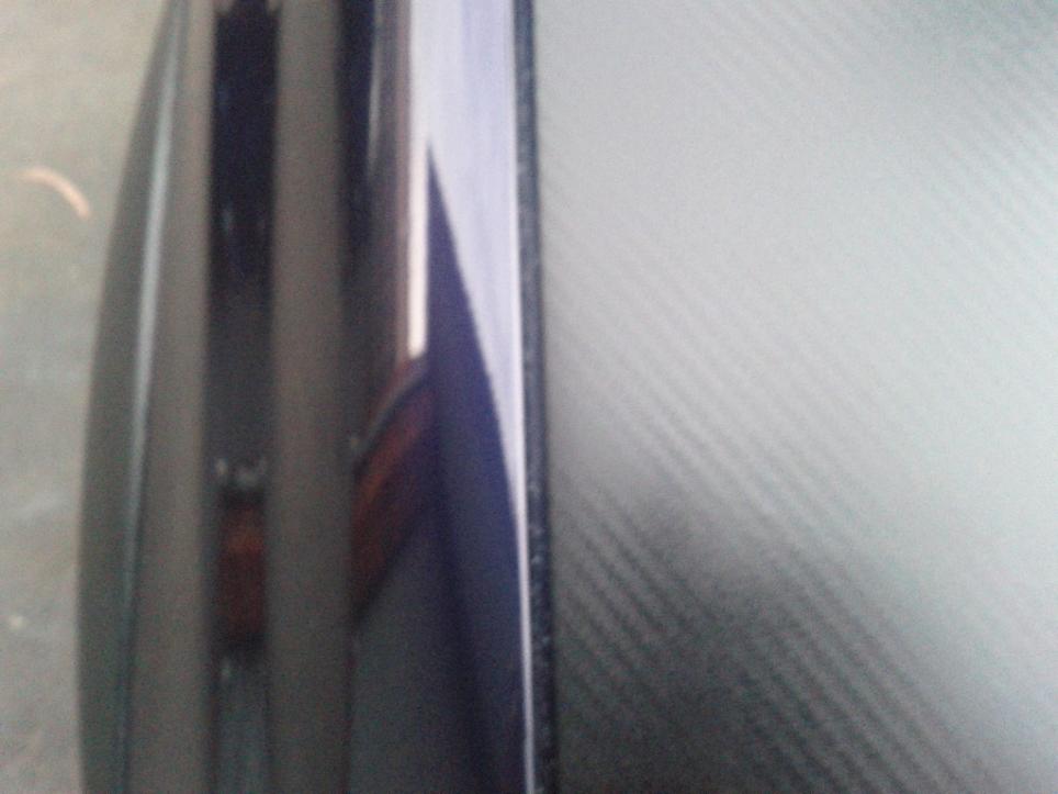

Just spend generous time lifting the vinyl, heating it, and smoothing it, and eventually all your edges will look great!
With the little water jet sprayers for the windshield, heat the vinyl over it, and keep smooth around it.
Eventually the vinyl will mould around the shape, and cut gently around it.
These materials are very stretchy when heated up, so when you encounter creases, just heat the bugger up!

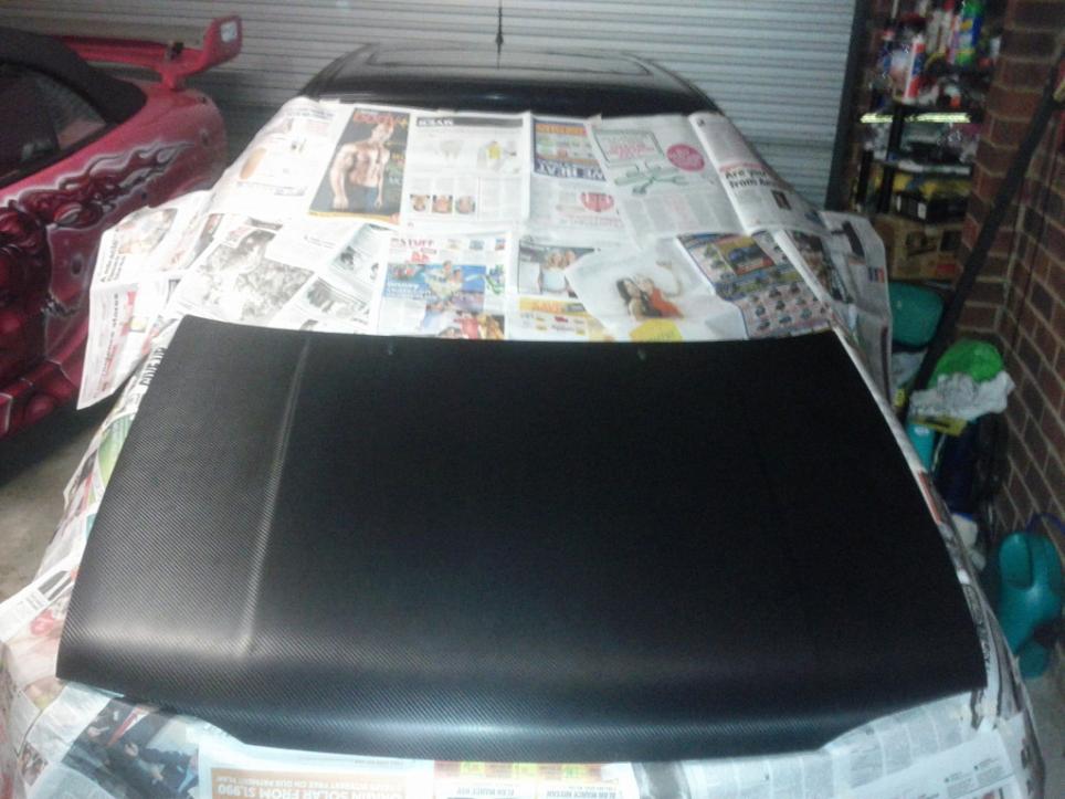

So after many hours of swearing, your bonnet should be looking amazing!
Now, this material last about 4-5 years outdoors, but a way to increase that is apply some clear coat which I did.
Mask up all around your bonnet so you don't get any overspray.
Now, apply 2 or 3 coats of clear. The more coats, the darker it will be.
With clear coat, it will make it look more realistic.
Start spraying with even lines, until completely covered.
Leave sufficient time between coats.
Now your done!
