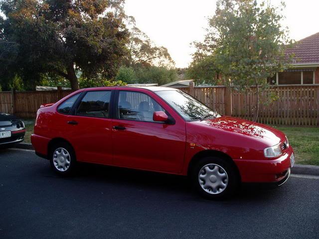

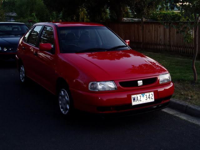

                          I have to agree with hawk, I used AutoGlym products (they were on the seat.co.uk website as the repalcement product) yeaterday to clean up my "new" cordy and couldn't be more happy with them (only thing is the price cost me about $100 on stuff) should last for ages though.
                          Car loked matt red before I got my hands on it, I used...
                          Bodywork Shampoo Conditioner with one of those noodle things, 2 buckets.
                          Super Resin Polish
                          Extra Gloss Protection
                          on the inside - Interior Shampoo
                          well it took me 6 hours all up, but i think its now spotless!
                          I'll post picks when I figure out how
                              Wow - it does look amazing!
