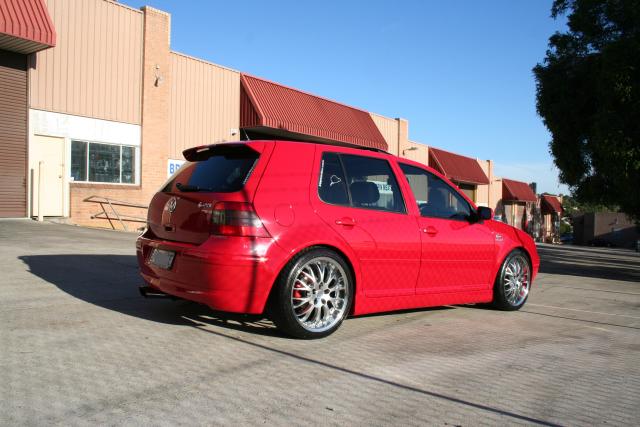

any one sprayed there brake callipars?
  • any one sprayed there brake callipars?
    its heaps easy looks really good. what do you think!!!

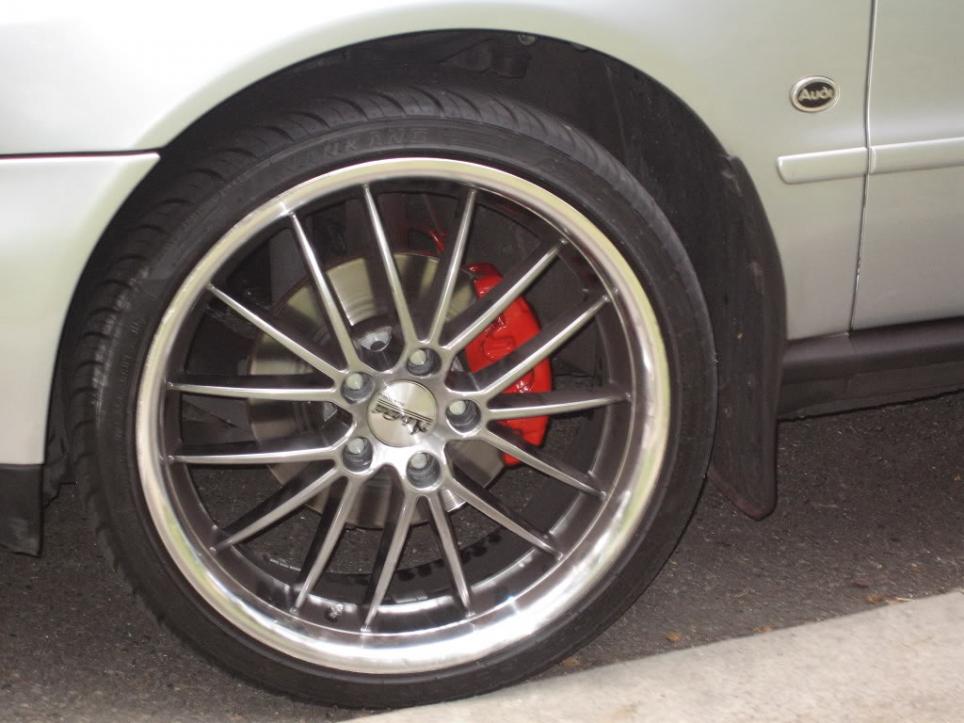

    only got one pic of the front rim! but looks the business!

    should have taken more time in taping up... but still looks heaps good!

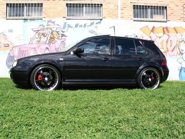

            heres the black gti when i did it, you cant really notice it on mine cuz of the car being so Red already lol
            (Hard to see mine, only one i can find for now)
