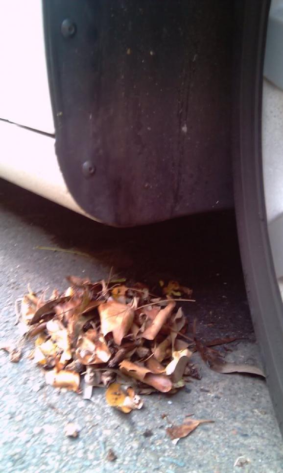

I cleaned mudguard area, again, today after only a couple of months.
You do need to get down and undo the two Phillips head screws at the bottom of the guard, and ease out the plastic inner guard and get in there with your fingers.....
I've taken a picture, and you'll see how many leaves were there just after a couple of months.

I took the pic after I'd done the screws up again.
