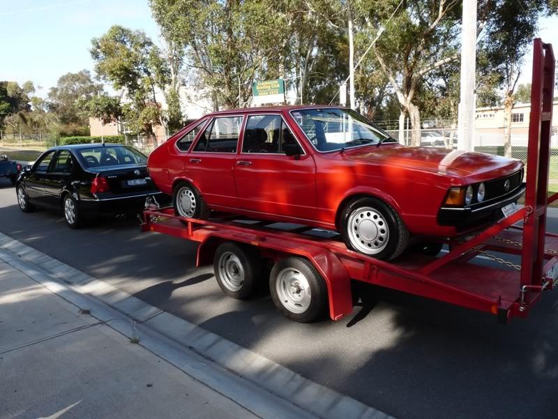

                I sprayed our B1 Passat in acrylic at home in the carport. I wrote it all up too. You might like to read it for some ideas.
                The repaint starts about page 7 of the thread. http://www.vwwatercooled.org.au/f55/...t-24078-7.html
                pics of the colour going start from page 11 http://www.vwwatercooled.org.au/f55/...-24078-11.html
                Preparation is where all the work is, painting is the quick and easy part.
                The paint's a year old now and no issues so far.
