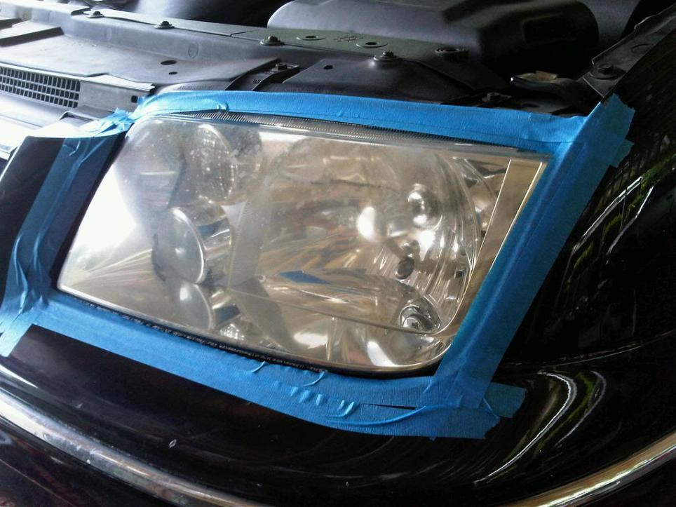

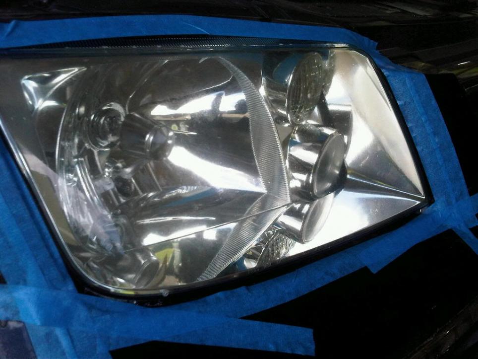

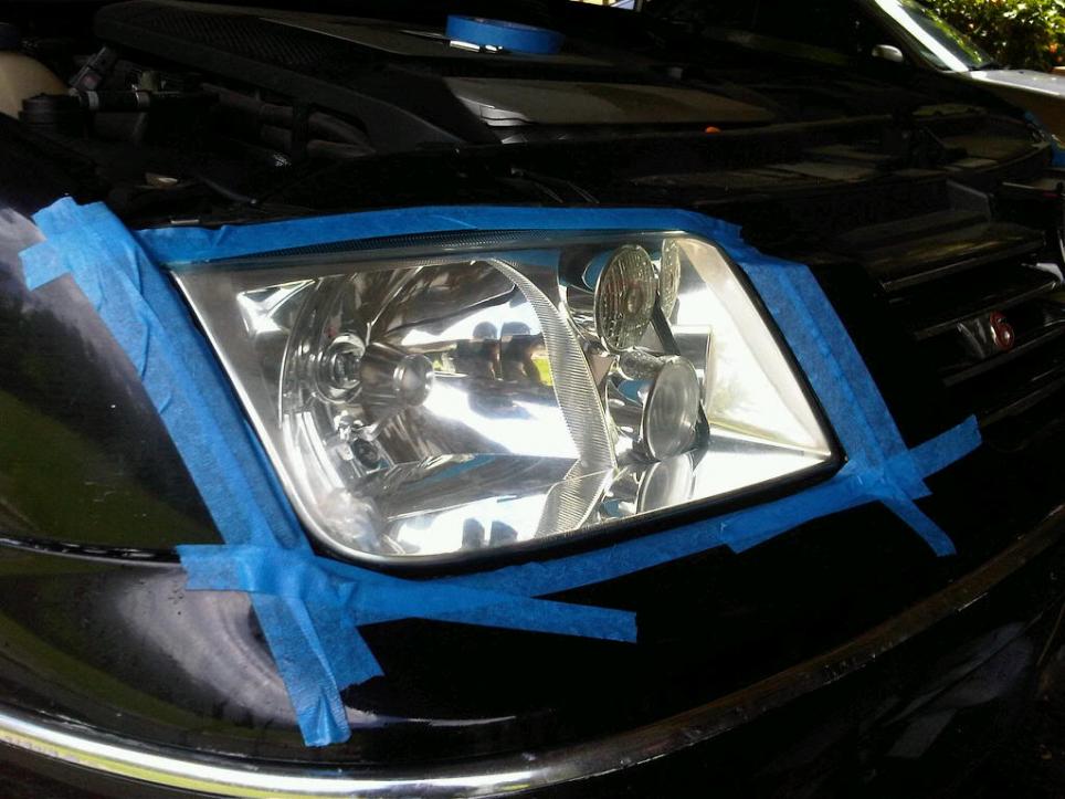

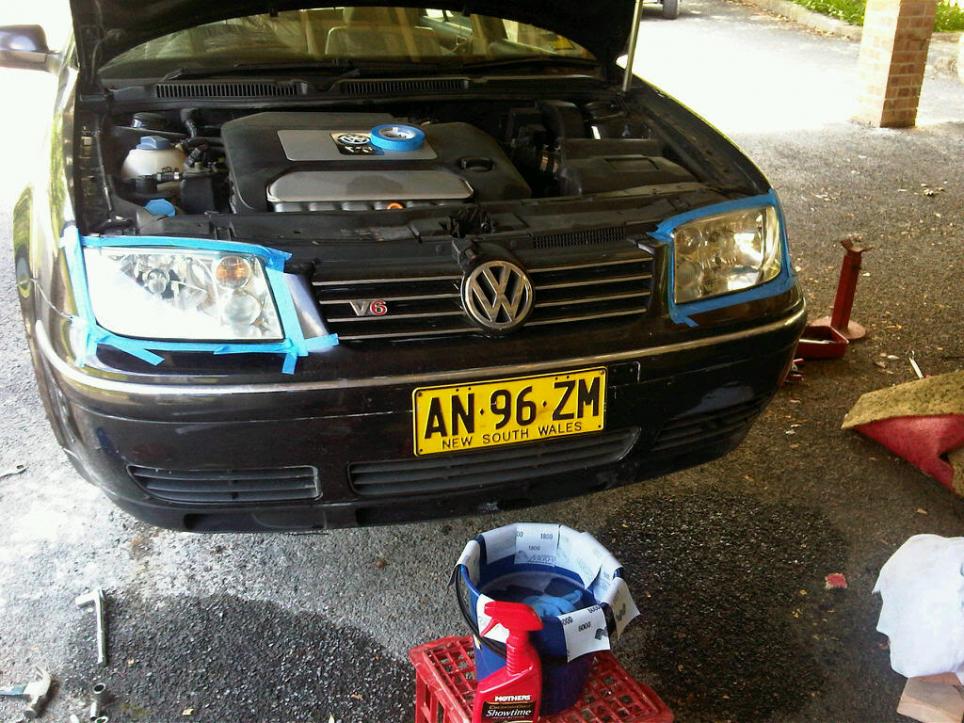

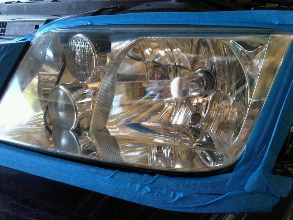

By the way, I did mine today in between suspension frustrations and here are the results.
I wasn't overly attentive with making sure the previous cuts' lines and marks had been taken care of before moving on the next grit, but it appears to have worked. I now think I might have better than 1 candle power headlights
From this (driver):-
To this (driver):-
and from this (passenger):-
to this (passenger):-
final front end:-
