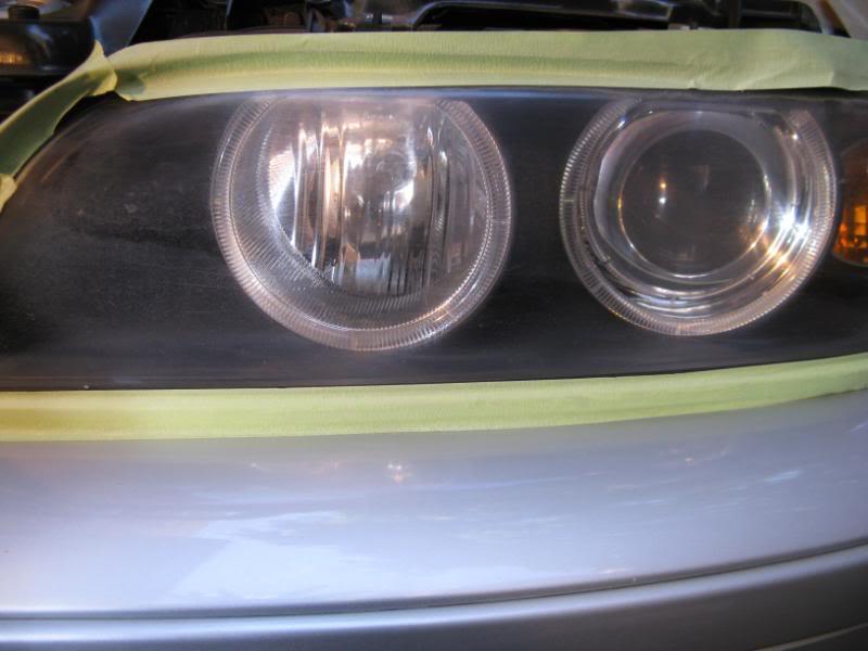

    This car was a BMW E39 5 series circa 2000 (i think)

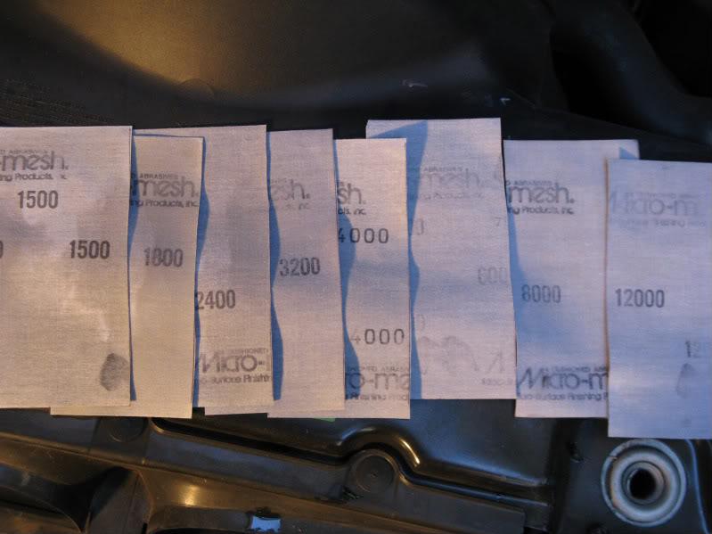

    2. Sandpaper. I recommend the MicroMesh kit. It is what i use due to the grades that it comes with. At the very least get some 1500, 2000 and 2500.
    The micromesh kit comes with all these

    You will be left with this

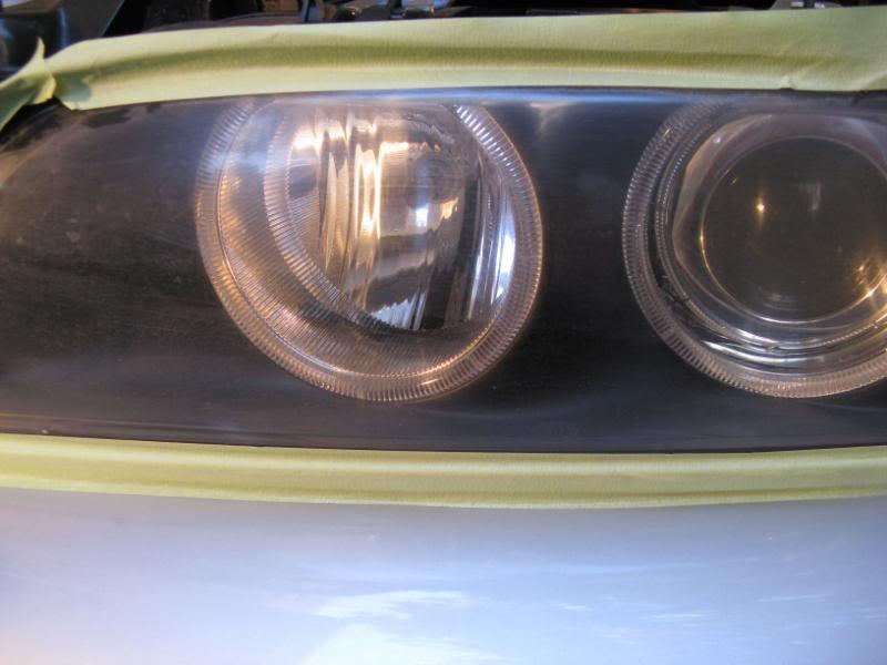

    4. Spray some water or clay lube (i use Dodo Born Slippy) on the lights and using a flexible sanding block rub the lights back with the 1500.
    You are left with this

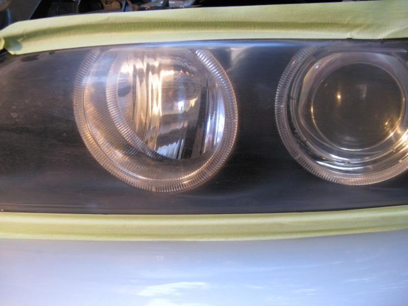

    5. Repeat the process again and again moving onto a finer paper each time. Before you move to the finer paper make sure that all the marks from the previous step are gone. EG dont move onto 2400 unless the 1800 has removed all the marks from the 1500.
    6. This picture is after the 2400

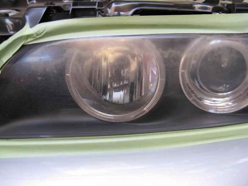

    7. This picture is after the 6000
    8. Once you have used the 12000 rewash the light and dry it throughly.

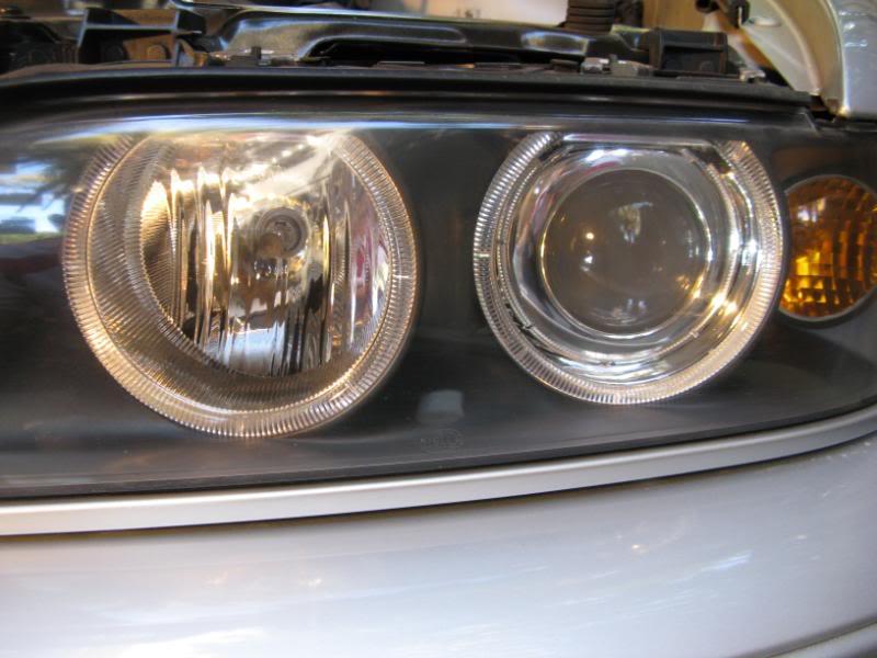

    12. You will be left with this. Much much better and much much cheaper than replacement lights!
