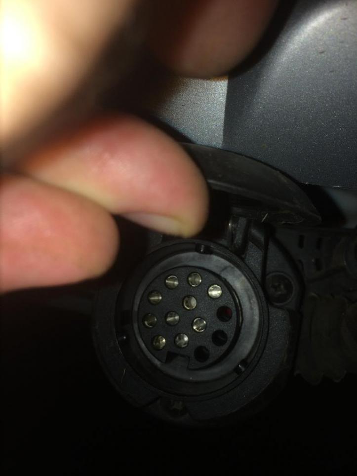

                      • #26
                        Did your kit come wired for 7 pin or was it 13 pin?
                        • #27
                          Pretty sure it's 13 pin but 7 wire.
                          Give me 5 minutes.
                          • #28
                            Yep, 13 pin. They are an awesome plug. Those flat 7 pin rubbish that's so common in Australia is only used in Australia. As we are a little bit limited market, there aren't so many manufactures as no good ones.
                            The 13 pin euro plug being round has the cap screw in from the rear that squashes a rubber grommet around the cable and makes for a water tight seal. Even the connection of the plug from the trailer to the car is water proof. Hope that makes sense
                            All tucks away hidden like this.
                            Happy Days.
                            • #29
                              Oh. Just remembered. They have a left and right tail light so you need to wire these together with diodes. If you just use one side for your tail lights, the canbus will show the other side is out.
