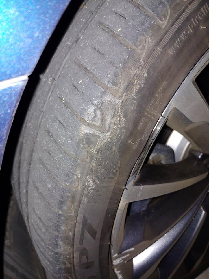

                  Driving in the dark last and I hit a massive pothole, it busted the front tyre.
                  I am gonna replace all 4 Pirelli P7 with Michelin Pilot Sport 4S 245/40ZR19.
                  From what I understood from this thread, this is legal and shouldn't cause any insurance issues in the future.

                        Well you would have to swap them around in pairs as the 245's are 8mm larger diameter but if its a 2wd it wont matter. Would a little bit if is an AWD

                          It is AWD... I am gonna replace all 4.
                          Could you please explain why it would matter in AWD, if you have the time.
                          Many thanks.
                          Sent from my LM-V405 using Tapatalk

                            Don't listen to the noise or the haters mate...
                            Go for the 245/40R19 tyres!
                            I have the same on my Superb and my Passat Alltrack. I run 220kpa (32psi) for a comfortable ride on both cars...
                            The Arteon also uses a 245/40R19 tyre.
                            (On both cars) at an indicated 100km/h read 97km/h on the GPS (BlackVue Dash Cam).
                            Around 103km/h on the dash is 100km/h on the GPS.
                            All these cars share the same chassis and components (to a degree), so you will be right!
                            Due to the Haldex AWD System, you would not want different rolling diameters front to rear...
                            If you are keen, you can also fine tune via VCDS (not sure if available on OBDeleven as I haven't gone looking yet); Wheel Circumference Change YouTube

                              Well Im not one of the haters as was trying to help both him and the idiot on WP If you look at the tyre comparator I linked the photos of you will see the exact difference which at 100kph is 2 1/2 % closer to accurate.
                              I changed the tyre circumference in my Tiguan with OBDEleven and where it was 104 at 100kph it is now dead on the 100. You beat me to it to say that with a Haldex or any transfer case you dont want different sized tyres as it makes it work like a diff all the time and hastens wear.
                              However running tyres below recommended pressures will cause them to heat up more and possibly wear faster as well The recommended pressures are probably that for a reason
