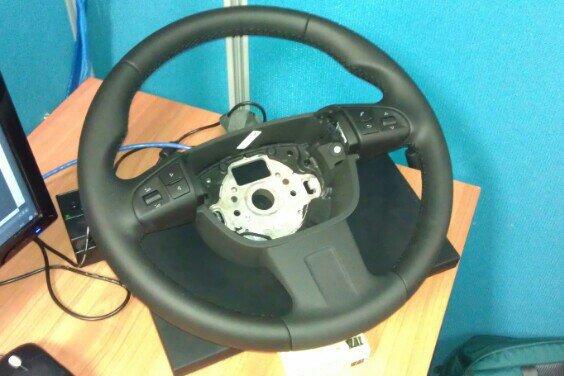

                          After a long delay, during which I was sure it was lost in transit the steering wheel finally arrived today. Now to sort out the install.
                          MY13 118TSI DSG Superb Elegance Sedan in Candy White with MFSW + Paddles

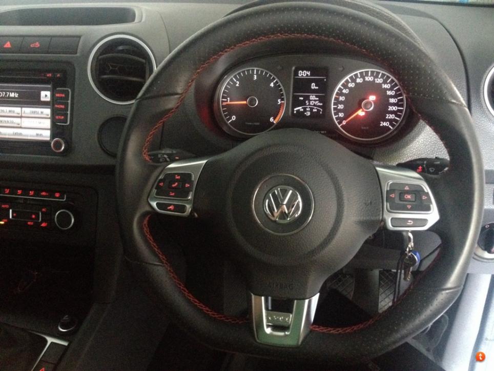

                            Enjoy VAG vehicles were made for retrofits haha
                            Amarok GTI..
                              That took quite some time to arrive!!
