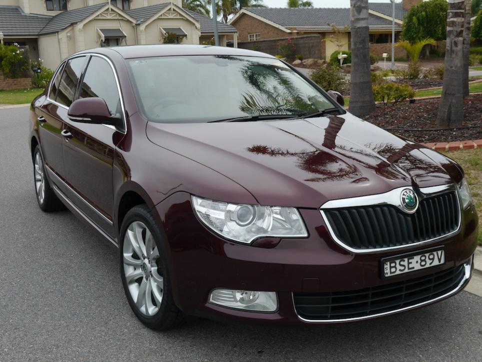

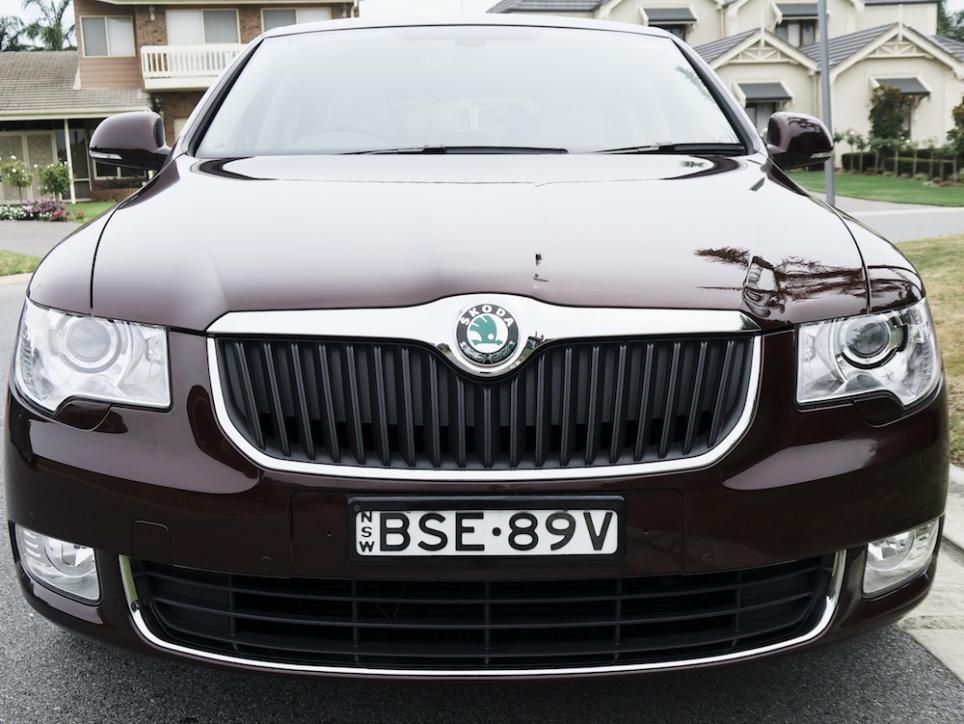

couple of photos, first and maybe the most thorough wash I ever do on a car. Took about 5 hours:
1. wash with APC
2. dry waffle weave
3. clay
4. Nanolex paint sealant
