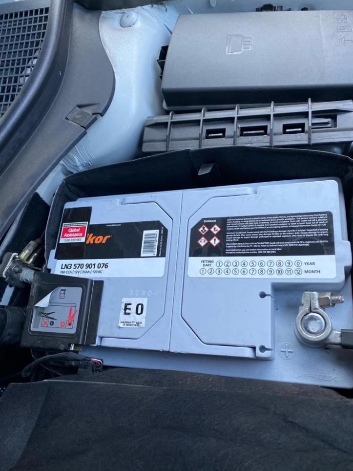

    MY2017 battery changed today by Roadside assistance under warranty. It was purchased in March 2017.
    Delkor AGM

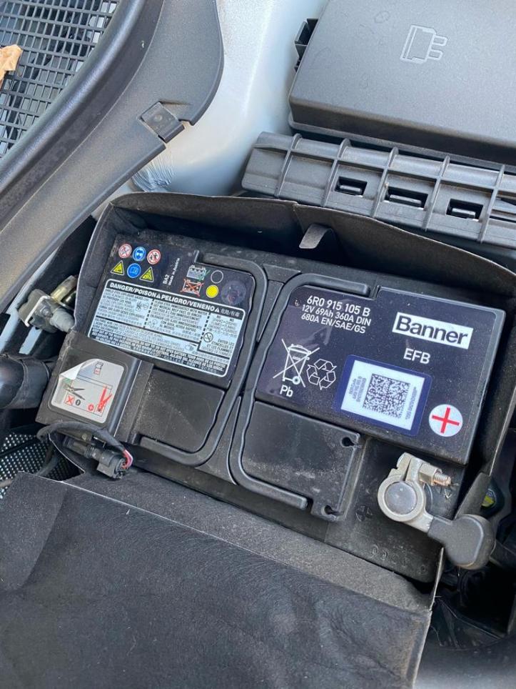

        That's fkn hilarious. April 2017 was the first registration of mine but it was handled differently, what a mess. Even though I'm booked for the replacement, I still have to travel 40km to get this done ...
        Btw, where are you located?

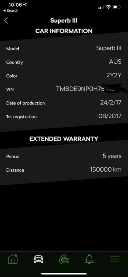

          My apologies, it was registered in 08/2017
          • #65
            Ok, that explains it, still within 3yrs. good on you, I wish my battery died a month ago
