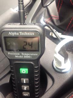

                      Yesterday I drove from Melbourne to Albury and back, around 7 hours of driving with a couple of short stops in between. On the way up I had no issues, but I had the temperature set to heating for the majority of the trip up.
                      On the way back it wouldn't cool properly on and off for the whole trip. I got fed up and one point and set it to max Lo temp and got a digital thermometer I had in the boot.
                      Here you can see that the air temp coming out of the vents is slightly higher than what the car measures outside. The probe is inside the centre vent.

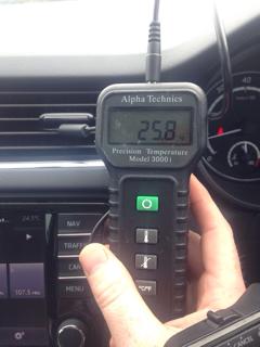

                      Later after the system deciding to respond and actually send cold air through the vents:
                      I didn't stay cold though, after a few minutes I set it back to 18-20 deg and warm air started to come through again. I tried setting it back to max Lo and couldn't get it below 16 deg. I gave up after around 15 mins of trying between auto and manual settings. The same sort of cycle repeated every half hour or so.

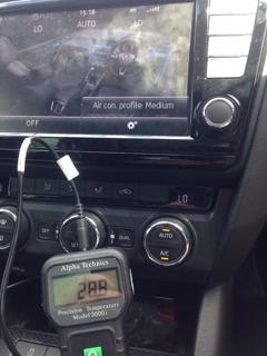

                      The temperature measured inside the car about 30 cm back from the centre console was approx 26 (varied around 1 deg during the time I was messing around trying to get cold air).

                        Can you post a pic of your aircon "setup" settings?

                            I don't have a pic of both setup screens but it happens when set on strong, Medium and light profiles.
                            I tested with auto recirc on and off makes no difference either.
                            This weekend I drive about an hour trip mostly freeway and some suburban streets. After a few minutes drive with the temp set at about 19 (22 deg outside) I noticed it wasn't blowing cold air. I tested again and found that the air out of the vents was hotter than ambient, even though the setup screen graphic showed cold air coming from the vents. I then set it on Lo for the remainder of the trip and the air never got cold. At one point I measured this....
                            I set the profile back to medium because I was sick of getting hot air blasted at me when on the strong setting.
                            On the drive home I put the temp back to 19 and I started getting cold. I checked the air temp coming out of the vent was between 5-8deg which I would expect to be normal when trying to cool.
