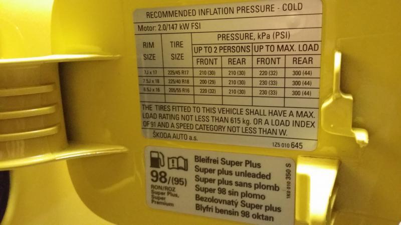

                            i just checked my (liftback) tyre placard - min load rating of 615 kg, or load index of 91.
                            interestingly, the build plate states an axle weight of 650 kg.
                            load index & speed rating listed here.
