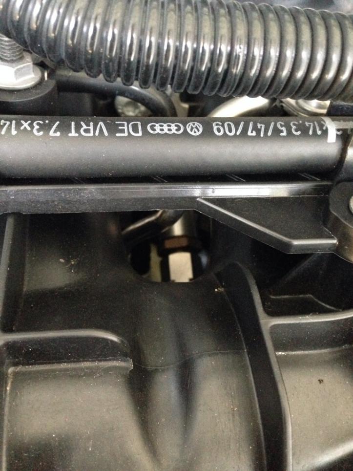

              Id be very surprised if the TSI engine didnt have one. In fact ill check my GTI in the morning.

                There you go....theres your fuel rail valve. I recon thats your problem right there. Not a common failure, but ive read of a few of them playing up.

                  Thanks for the pic Lucas. Went and looked at my engine and I have the same valve. Oddly enough while researching the fuel rail valve to see if it is the issue I came across the symptoms of stuck open injectors which sounds very similar to what I am experiencing. Unfortunately I just went and ordered a hpfp from a vw dealer today at $560 and when I rang them up an hour later to cancel they said they couldn't. I'll try again when I go to pick it up tomorrow but at the moment this is proving to be a very expensive exercise. At this stage I might give the self diagnosis a miss and just take it to Essendon Skoda. I'll have to fork out for the tow as well which sucks and I'm sure the final bill won't be cheap. As much as I love my car I'm beginning to regret buying a Skoda at this stage. The parts prices are beyond belief.
