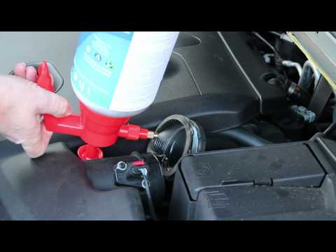

    Posted this up over at the vwgolf forums but thought this was pretty cool...
    1,8 TSI verkote Ventile SELBST REINIGEN Valve cleaning Carb Cleaner Audi VW GTI BEDI Liqui Moly - YouTube
    Any takers on making up the same rig? Haha
    Sent from my GT-N7100 using Tapatalk
    I'm actually liking this one better. You don't want to be pulling out that sensor too often. Steel screw - plastic manifold
      Looks pretty good. So in our case you would be shooting that into the intake pipe before the MAF? I.e. after disconnecting airbox etc...
      I only tried today a similar method as to my posted video using a hose and an air pump needle. Used about 500ml whilst idling the car at temp around 2000rpm. Almost nothing came out?
        This is what came out, would you say its anything significant? I've got the nulon air intake foaming spray can waiting to be used before my next service in about 4,000km...
                      I was faffing about the other day & disconnected the flexible pipe from the MAF. You really don't want to be shooting too many chemicals through the MAF IMO. I discovered that the chemicals pool in the ribs of the flexible pipe (not a huge issue - they'll be sucked in or evaporate eventually). I think a better way would be to disconnect the flexible pipe from the pipe that runs along the back of the engine and mist the water / chems in there.
                      That 2L sprayer in the Revive video can be bought for about $5 at Bunnings. The bigger sprayers (5L?) with the spray wand are about $12. You can shove the wand down the pipe a bit.
                      edit: I barely get any smoke / carbon coming out of mine. Never used to get much on my Subaru either.
                      Keep in mind that you are trying to push the rubbish through 2x 800 cell cats, a humongous pancake muffler & the rear muffler. I'm surprised any exhaust gasses come out with that lot to contend with

                        Agreed with Brad,
                        I would not be spraying anything except contact cleaner on my MAF.
                        If you could get the spray after the MAF into the UP pipe that would be ok, I just wonder how much crud would be left over in the bottom of the Inter cooler?
