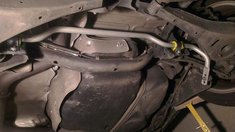

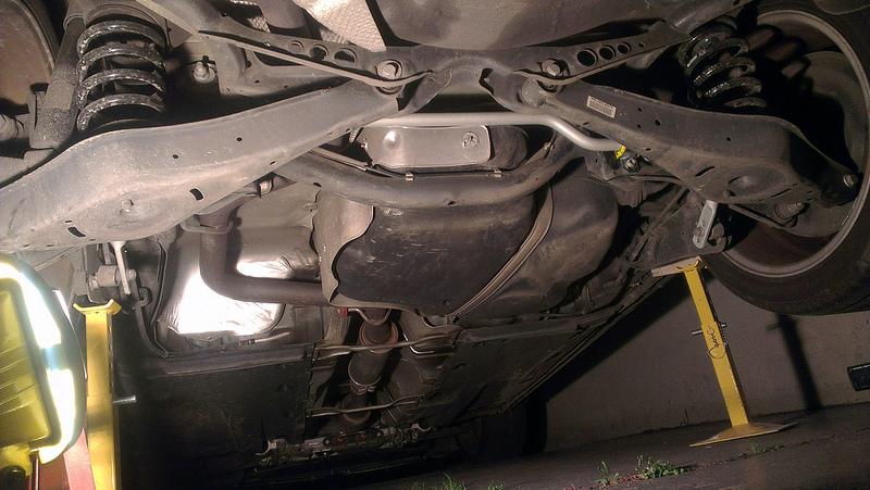

 The swaybar went in tonite in just over an hour. How amazing when jobs just work without hiccups! I ended up using the stock end link bolts rather than the ones supplied. I really couldnt see any point in the new ones. Does anyone have clarification on that part? Its a whiteline adjustable 24mm

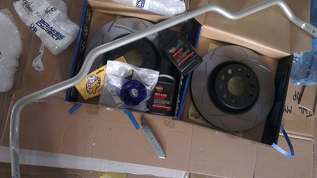

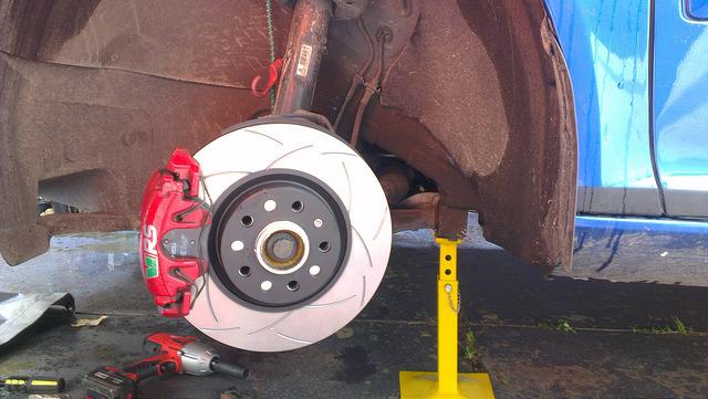

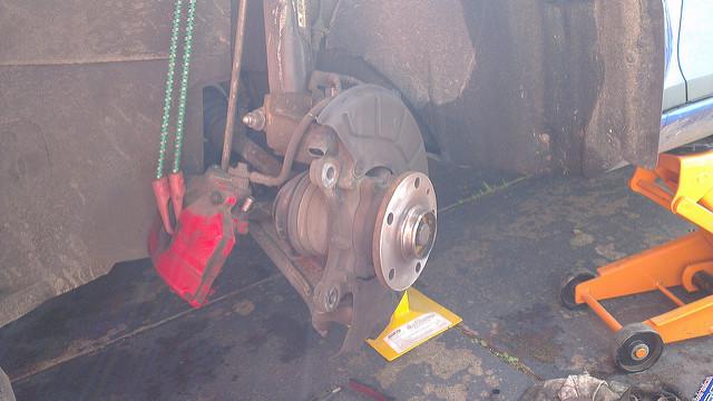

 Out go the old rotors and a bit a rust
 Remsa pads. $209 shipped from GSL. Not bad. Looking forward to less brake dust finally!! Zomg
 DBA T2's. Was a bit stingy on these and couldn't see the benefit that much going for the 4000's, they just last a bit longer for $50 more a corner..
 I wish they were bigger.. nether the less. I AM IN LOVE! Need to clean those wheels again

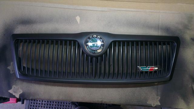

 Today I also bit the bullet and plasti-dipped my upper grill. I've always loved the chrome look and only liked the black on some cars... I'm still not sure whether I like it, but time will tell. At least it goes well with the eyelids. Matti is a big fan on his Race blue octy!www.TheRapidWrench.Melbourne

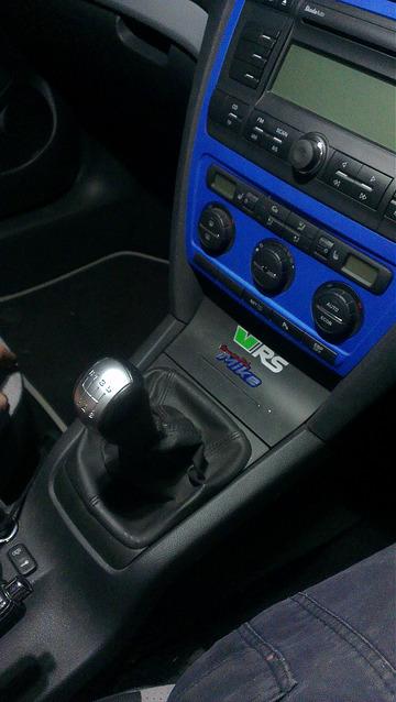

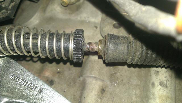

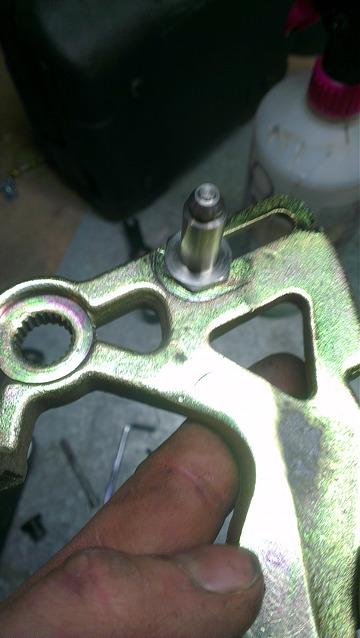

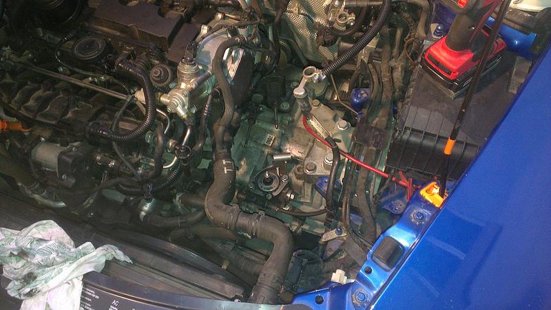

 A couple weeks ago I received a short shift kit for the Octy, and today I installed it.
 I bought it from gexperformance_au on eBay brand new for $46. >HERE< is the item:
 This is what the item listing says:
 - Roller Bearings For Long Lasting Hard Driving.
 - Designed for Motorsport use.
 - This Will Reduce Throw up to 40% and Give you a Faster Shift Throw Through The Gears.
 Battery and battery terminal removed and in we go!
 After so much struggle re-setting the gear location when I did the 42DD bushings, I made sure to take photos of the notches for reference later
 So here is the new shifter on the right, next to the stock one pulled out of the car. FYI stock one was roughly 850grams and new one was roughly 550grams. I thought that having the extra weight in the lever would aid the motion and make it feel chunky, but it actually hardly changed anything that I can tell You can see the slot for fine adjusting the length. Towards the left makes it shorter, towards right is closest to stock, but not longer than stock. You can see the slot for fine adjusting the length. Towards the left makes it shorter, towards right is closest to stock, but not longer than stock.
 Installed the bushing rod at the shortest point
 I got very concerned when the edge of the plastic slider almost comes out of the lever sleeve, and even falls down a couple degrees, but it only sits there in-between gears. Hard to explain, but the plastic sleeve is only moving up and down when fully engaged.
 So here is the forward/back movement, roughly 7-8cm measured. Unfortunately I didn't measure the stock distance so if someone could do this I'd like to know
 So I would say this upgrade is a major success. I took it for a short drive and it feels great. It needs getting used to, but it made the 42DD bushings feel even better than before. It feels super short, but not ridiculous at the same time. This mod doesn't change the side to side length, but I like it the way it is.

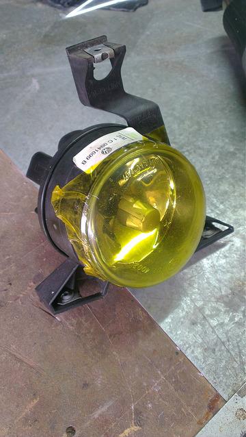

 Next I got around to what I've wanted to do for a while: Tinting the fogs!
 Just some $3 vinyl wrap from ebay

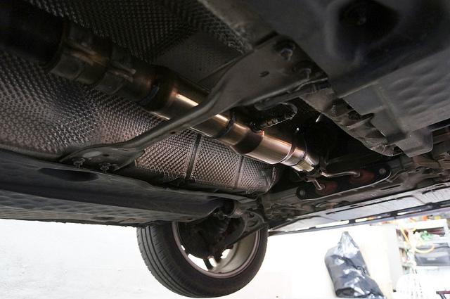

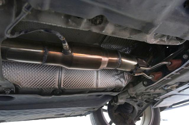

 Got the new (catted) down-pipe made up today finally by Trevor @ Muffler Man Prahran! Portaz also got his done with me. The welding was a little rougher than I expected and the sub-frame mount is slightly crooked, but it does the job well.
 Throughout the rev range it just sounds deeper and tougher, even though the resonator wasn't deleted... Getting rid of it is questionable, and I might do it for a bit of extra bwaahhhh... At WOT there's slightly more power above 3000, proving the restriction in the crappy stock pipe, which unfortunately he hacked out the turbo mounts from so there's no point of switching and selling the new pipe when I sell the car oh well. oh well.

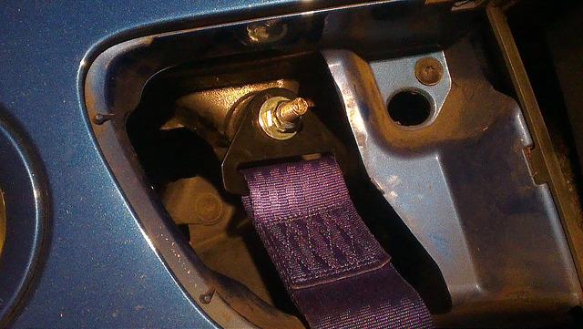

 Finally got around to mounting the tow-strap. Cos, you know... racecar
 I bought it on eBay for $19 shipped and its CAMS approved, but I had it lying here for weeks because I couldn't be bothered working out where to mount it or drill the chassis. Nek minnit, I acidentally pull on this part of the grill and find out it simply pulls out!! Low and behold, the factory tow point behind! LOL. So I made up a little bolt on assembly. However it wont be strong enough, so I'll re-do it at before track work with a bigger bolt to actually thread in properly as intended. Theres even a little slot for it to poke through!
 Wallah! Such racecar. Many pro. So track. Wow

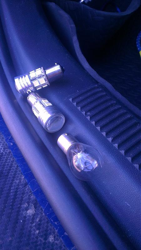

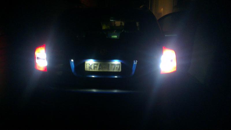

 As advised in a thread on here, $22 reverse LEDS from ALI Express..
 Left one is the LED, and thats in the day
 Both new

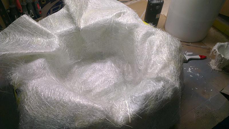

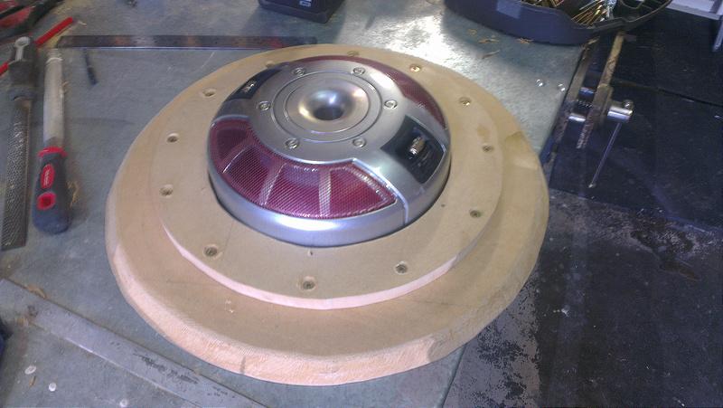

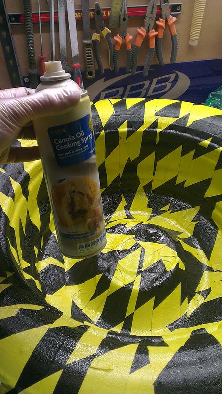

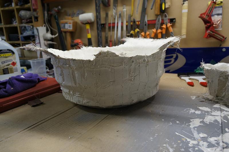

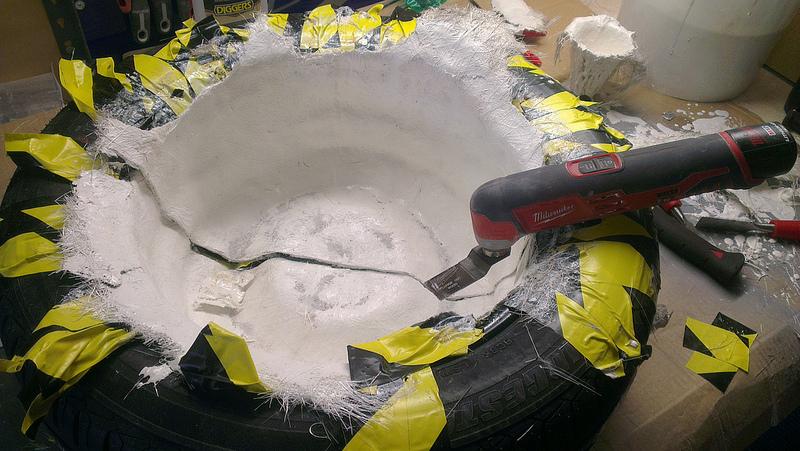

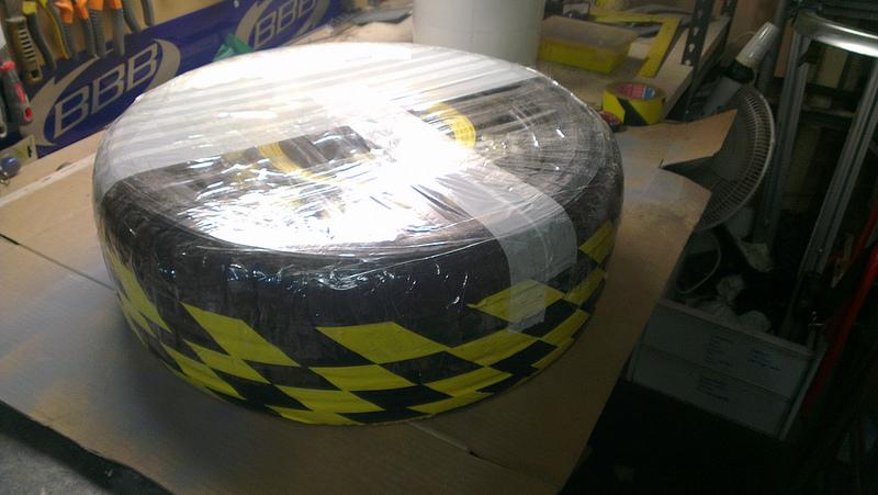

 So I decided I wasn't completely happy with the sound of my sub. Its a little boomy as I ended up building it too big for the slimline driver. I had three options: Either I make an internal fibreglass wall to reduce the inside size, OR, shove a couple blocks of wood or polystyrene in there lol, OR, put a full size non-slimline sub in there :p Option three sounds best but I didn't want to blow up the box either!!

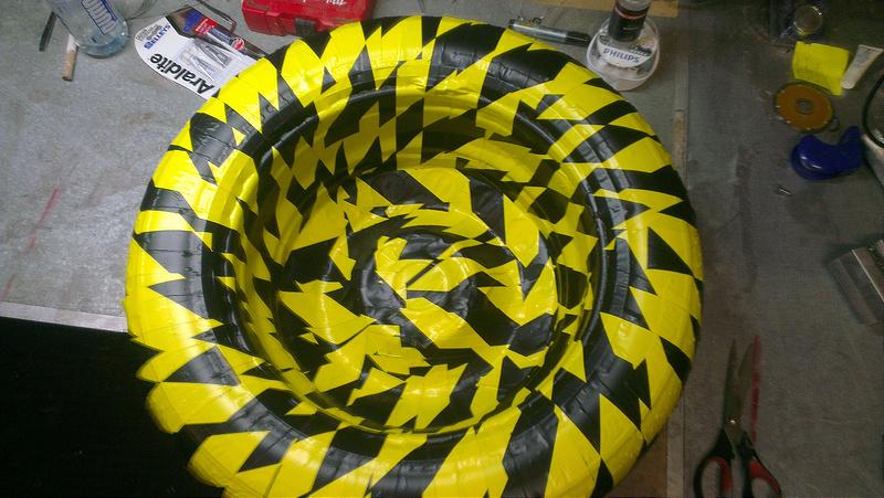

 So I ended up doing what I've wanted to try for a while: Make a sub out of the spare wheel
 This is what I had to work with:
 I taped up the entire thing...
 Taped the inside really well...
 Hit it with lots of oil...
 Started the first layer of fibreglass
 Couple layers done

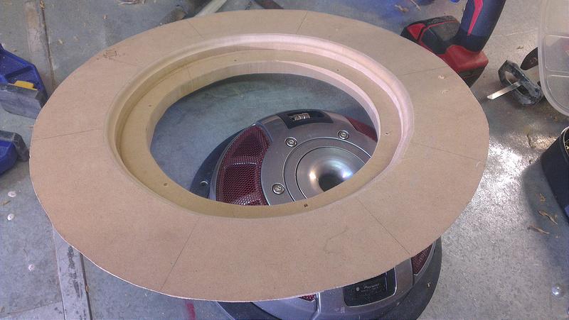

 Made the top sub support ring out of MDF, used a router on the inside edge for a nice finish. Two layers deep, with the second 16mm layer routed to 8mm to lower it even further. Lots of screws to make it secure and airtight

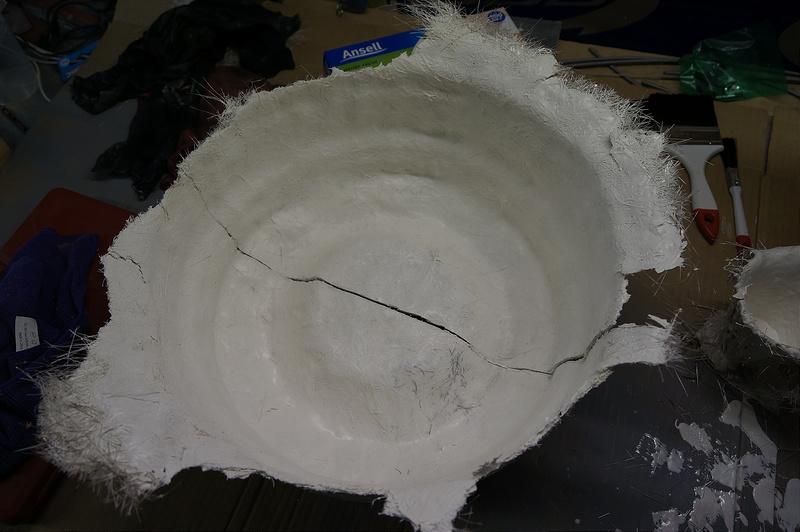

 Now the fun part... Trying to get the bastard out! Holy crap is this material strong. COULD NOT get it out! Tearing pulling hammering the top and bottom, pulling the tape etc. Nothing worked. Could not dent it! Ended up having to saw it out with the intention of glassing it back together outside the wheel
  Last edited by MountainBikeMike; 20-11-2013, 08:24 PM.www.TheRapidWrench.Melbourne Last edited by MountainBikeMike; 20-11-2013, 08:24 PM.www.TheRapidWrench.Melbourne
