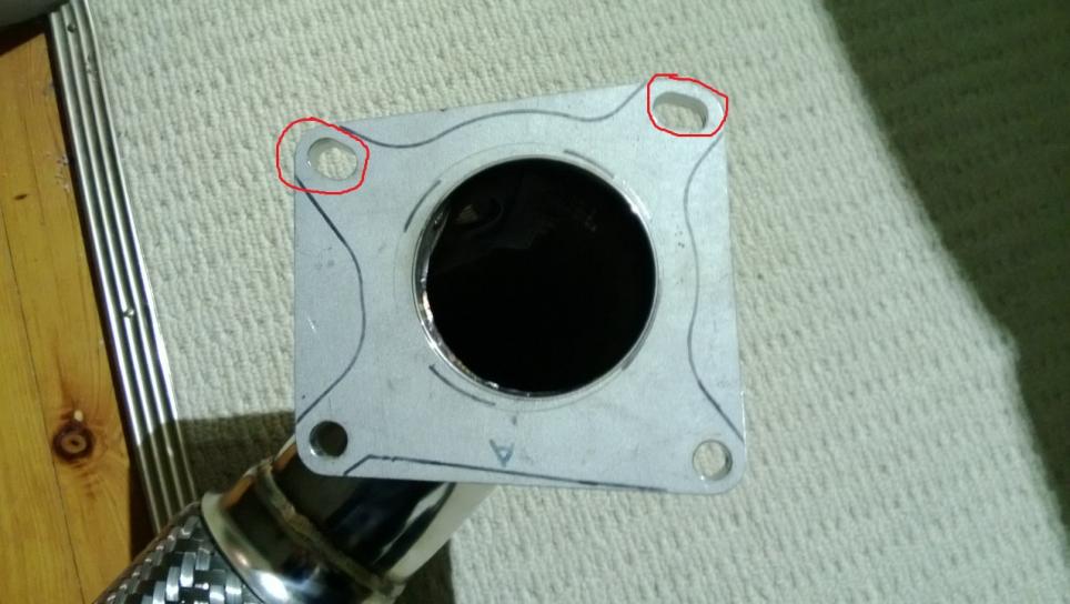

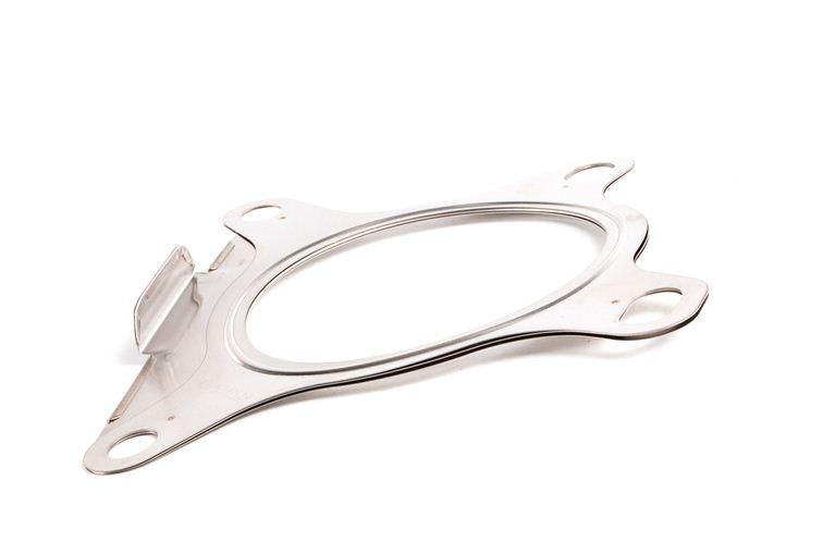

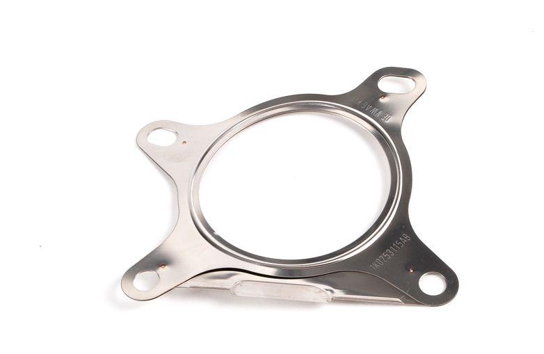

      cant find a copy of the flange, but ill go take a pic of mine.
      here is the gasket to suit the TFSI and TSI turbo. note the two elongated holes. all the MK6(TSI) ones are like this:
      EDIT:
      OK here is my flange. it was laser cut, and then the gasket drawn on it. hopefully I don't need to trim it down, as something that size will have less of a change of warping. doesn't look spectacular, but it will work.

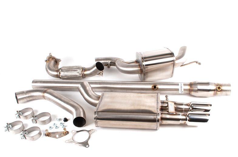

      • #18
        this is what i'm getting installed on thursday. its designed for the mk5 jetta GLi.
        u'll notice at the bottom of the pic the adapter/gasket thingy.....
        MY17 Superb 162TSI, Business Grey, Tech+Comfort Pack, APR ECU+TCU Stg 1, SLA, Rieger Splitter + Side Skirts, Eibach Pro-Kit Springs, Hardrace Swaybar, TPMS
        • #19
          the gasket is the same for the TSI and TFSI
          but that down pipe (just by looking at it) doesn't look like it will fit. none of the MK5 ones appear to fit.
          that said, im sure it could easily be modded to fit
          it will also go so much better after!!

              • #22
                The APR one gets trimmed to size during the fitting process unless they are pre-trimming them before shipment.
                It also has an adjustable hanger so suits the slightly different path it needs to take.
                FOLLOW US ON FACEBOOK
                • #23
                  as previously stated - same length, piping & route with a mk5 jetta gli.
                  had mine installed today. there was no need to trim or adjust
                  • #24
                    I didnt see the post above.
                    If you fit the entire turbo back then its a direct bolt on. If you just go the DP route then it needs to be trimmed to length to mate up with the stock Octavia cat back

                        • #27
                          How come the APR website has the same part number for the Occy as the Golf GTI if according to the above the GTI is too long for the Occy? APR also confirmed the Golf GTI MK6 downpipe will fit the Occy MK2. I'm confused by the above stating things need to be trimmed for the Occy?
                          • #28
                            APR probably assume you are using the APR catback from the Jetta.
                            • #29
                              not sure, maybe its to do with the position of where the apr downpipe ends up with respect to the stock octavia catback.
                              the golf catback is entirely different design to the octavia catback.
                              when i got the full apr exhaust, for a jetta, there was no cutting/trimming required.
                              • #30
                                I'm using the APR hiflow CAT and downpipe from the Jetta - into the stock Octavia CAT back exhaust system
                                2012.1 Skoda Octavia VRS DSG Wagon - Carbonio cold air intake and pipe - HPA Motorsports BBK 355mm rotors 6 pot calipers
                                APR Stage II ECU - APR 3" exhaust down pipe & high flow catalyst
                                APR/HP Roll bars - Eibach springs and Bilstien shocks
