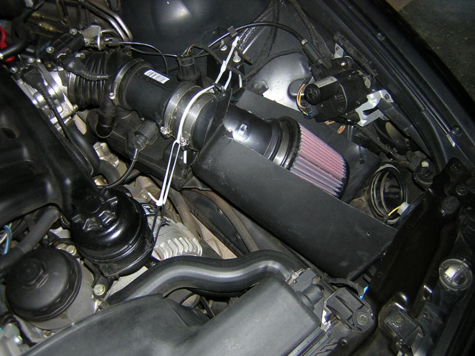

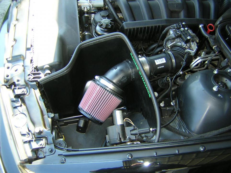

                        I mentioned a unit I had on an old Bimmer. The hoses were insulated, and when the bonnet closed it came down on seals on the top of vertical insulation panels that sealed between the inner wheel arch of the front guard and the underside of the bonnet, so totally isolating the already insulated filter box from the rest of the engine bay. Afterall the whole idea is get cold higher density air into the manifold. The spaces under bonnets today don't allow what I've tried to explian to be done.
                        There's a pic here, http://www.bimmerwerkz.com/forum/5-series-e12-e28-e34-e39/cold-air-intake-5312.html that gives the idea.
                        It's OK for track, or long distance, but is more efficient when the car is moving. Like any insulation, once the R value has been reached then the insultion is no longer efficient. For city driving I don't see any benefit from CAI's or panel filters, and even on the open road I don't consider spending money to mod one component of the intake system, but leave everything else on the intake side and the exhaust stock standard to be worthwhile in attempting to achieve perfomance gain.

                            Originally posted by BottomScratcher View Post
                            The boxes that connect to stock induction hoses may be partially insulated from engine heat, but everything between them and the intake manifold isn't. The moment you pull up at a set of lights the under bonnet temp shoots to 60C+.
                            There's a pic here, COLD AIR INTAKE - BMW Forum - BimmerWerkz.com that gives the idea.

                              That's pretty average... a real airbox should be air tight from air within the engine bay.
