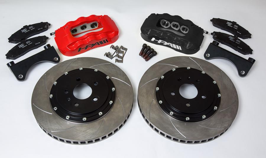

Octavian's, lend me your eyes, feature this really bad ass big brake kit!
I was rather shocked and very impressed when I opened the box!
So why a BBK for the Octavia?
I'm a little unhappy with the brakes, they are powerful and do work fine, for a production car
I just don't like the contrast between the slow round town over powered feel (but it saves effort and is comfortable)
and needing to apply very large force when pushing hard elsewhere (but that does give good granular control of the braking)
I intend to do track days - can't stand production brake fade, happens too soon!
(Yes, put a set of DS2500 pads in and it will probably hold up for quite a few laps)
As I've taken my Octavia to Stage II, it's getting to higher speeds rather quickly,
the stock braking capability is good but now does not really match the performance of the car
Ultimately this car will become a dedicated track car, getting the necessary gear now to spread cost over time
I've been researching big brake kits for some months now:
Didn't like the R32 brake option, can be fair bit of money if you're unlucky, unlikely to yield significant improvement over the VRS brakes, very heavy, rotors not much bigger
Looked into using Porsche calipers - they are a little hard to get and could be 10 years old (sometimes expensive)
At the end of the day I found out they would foul my wheels (unless I use spacers)
Again, rotors not that much bigger, ~330mm
I know rotor diameter is not the defining factor, but if you're going to pay these $ you may as well get really big and bad ones, right?
Started looking into more serious kits with two piece rotors for decent weight savings
Looked into various other BBK's options, all were ~330mm disks, all needed wheel spacers to clear the calipers - arggg!
Then I found the HPA big brake kit which fits numerous VAG vehicles
HPA Motorsports Inc. - Big Brake Kits
355mm rotors - hur hur hur - 6 pot calipers - hur hur hur
The rotors are 32mm thick, two piece hat, slotted rotor face
But they are designed to fit under stock 18" wheels without a spacer - we have a winner!
(You have to remove the factory rotor dust shield however - I'm fine with that)
Apparently these save 14.5kg of unsprung weight
So stay tuned for installation and road test reports!!!
