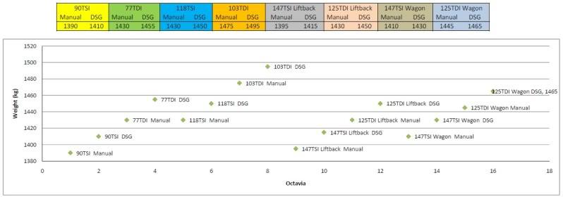

                            I put 2.0TFSI VRS springs in my 1.9TDI and the front ended up about 5mm higher than stock.... like I said in an earlier post - theres a big difference in the tare axle loads for all the different octavias, so the rates are all quite different.
                              thought just as much.
                              i did some number crunching, and it turns out the 147tsi liftback is "lightweight" in comparison to the other octavia models!!
                              the 103tdi takes the belt for heavy weight champion.
                              weird though, as it contradicts the weight loading for the springs & the tyres aswell..........
