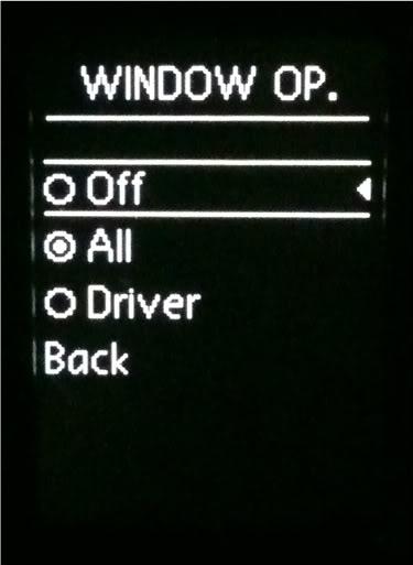

by default, its set to operate the "Driver's" window only. i changed mine to "All".Originally posted by k_rider View PostI do seem to recall though, that it affected the driver's and nearside rear window (simply because these are the ones I usually open).
but thats usually associated with the long press (unlock) to open all/driver's windows.
the auto-close works all the time, every time for me.
sometimes too much. if i open the windows using the remote, then relock it without opening any of the doors, the windows will automatically close after a set time!! sux when u feelin too lazy to go out & physically do it.MY17 Superb 162TSI, Business Grey, Tech+Comfort Pack, APR ECU+TCU Stg 1, SLA, Rieger Splitter + Side Skirts, Eibach Pro-Kit Springs, Hardrace Swaybar, TPMS
