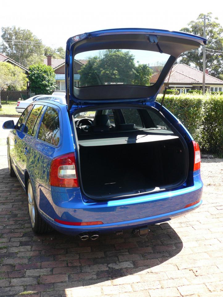

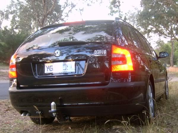

        I would definitely follow this one up if I were you, and contact Skoda Australia if the dealer gives you any grief. A factory fitted bar for a wagon should have the plug fixed to the rear bumper, alongside the towbar as per the photo.
        It would have been minimal effort to bring the cable and plug through to where it should be so I don't know why they didn't do it in the first place, other than to avoid drilling a couple og holes in the bumper.
