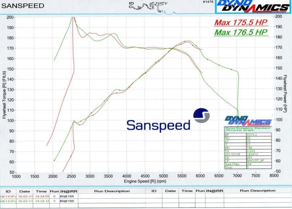

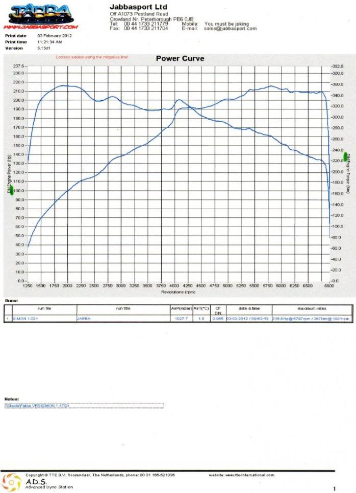

Had it dyno'd with only 192 miles on the clock
180ps=177hp, so pretty muhch bang on the money

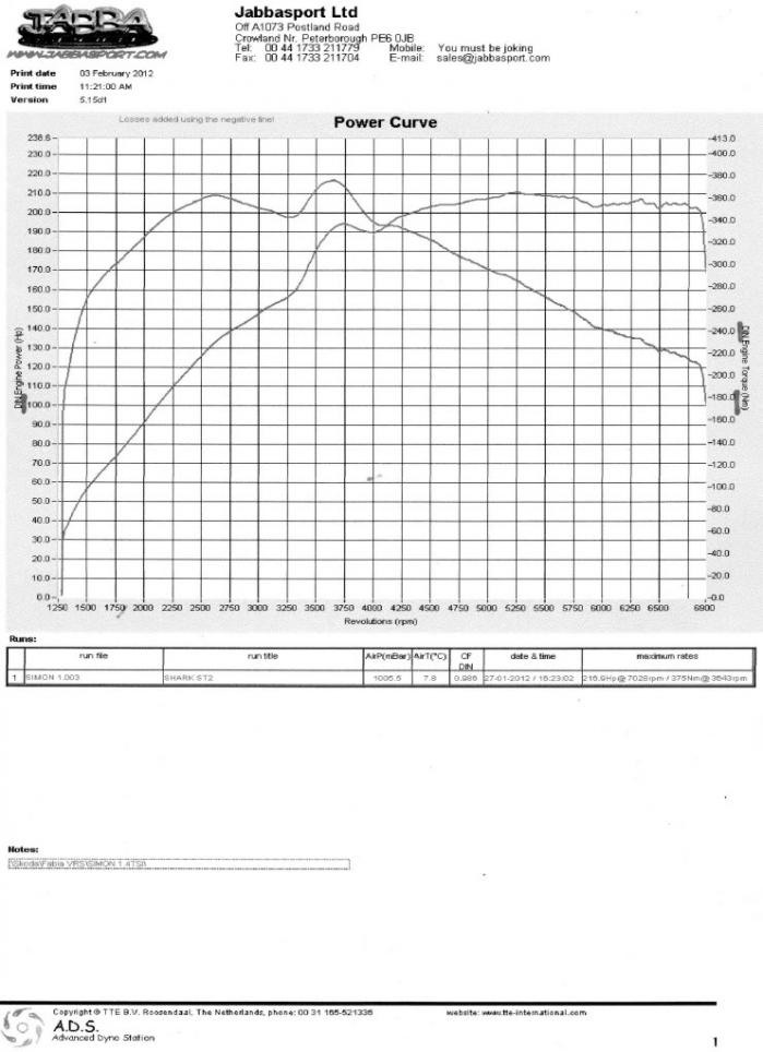

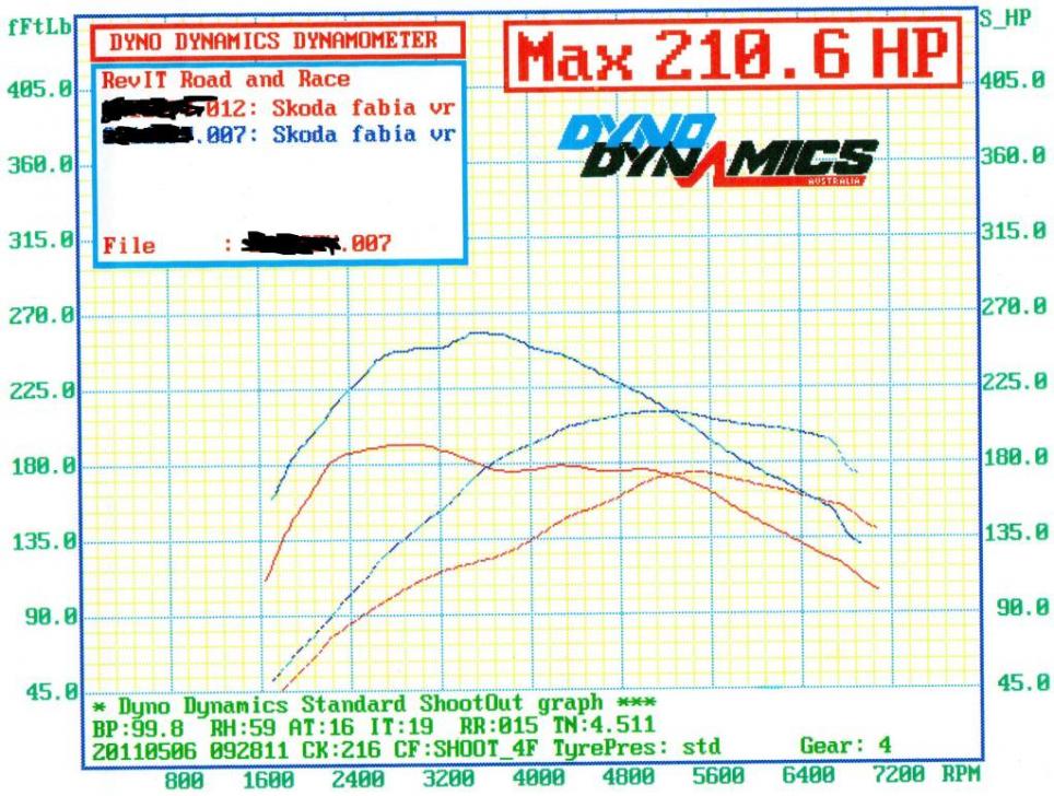

Dyno'd again on DD rollers.
Red Curve = Stock software with Decat OEM downpipe
Blue curve = Stage 1+/2 remap with decat OEM downpipe
Chuffed to bits with the gains although not 100% on the accuracy of the torque as it was substantially higher on those DD rollers compared to my most recent run @ JKMs DD rollers.

Most recent rolling road day from JKM
Also got marginally better figures than an Ibiza Cupra with stage 2 revo & full TBE on the day as well *as well, so considering his outlay of around £1700 im chuffed to bits with my results for what is only a total of £80 outlay by myself.
