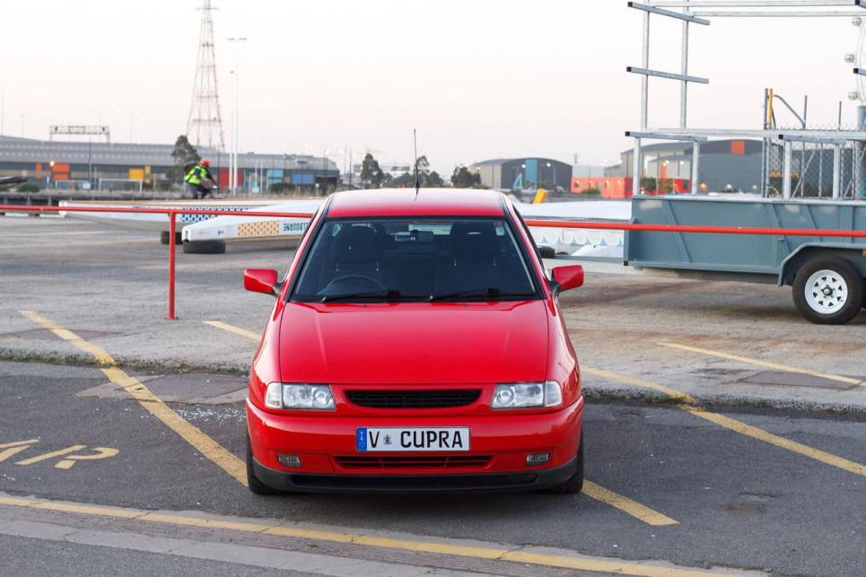

    Cupra waits for some new shoes and bonnet gets a face peel
    • #17
      Updates:
      I had the rims powder coated before fitting new tyres as the original clear was flaking off.
      The urge to pick white was strong, however a pain to keep clean so I decided to go with a light silver with metallic specks.
      Really happy with the result as it's somewhere between stock and white!

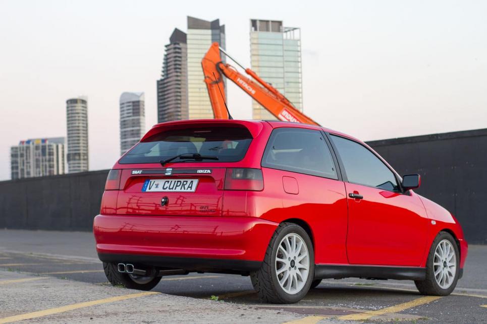

      During the wait I detailed the car, got rid of the ancient CD stacker system, installed light sensing auto on/off headlight system, fit the Remus exhaust and swapped my Neuspeed 28mm rear sway bar over.

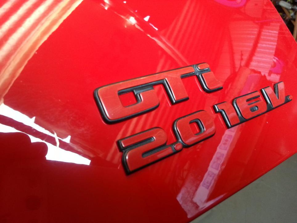

      Badges removed, polished, re-attached:
      Clean!

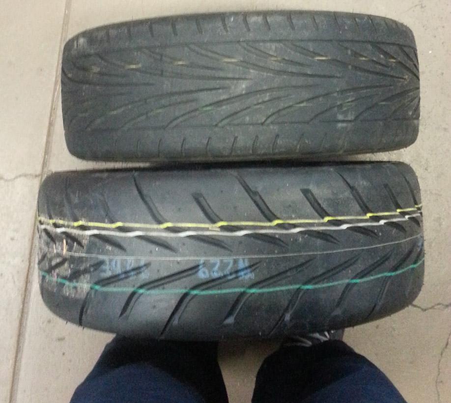

      New tyres, big size difference!
      Adjusted speedo needle higher up to account for the bigger rolling diameter.

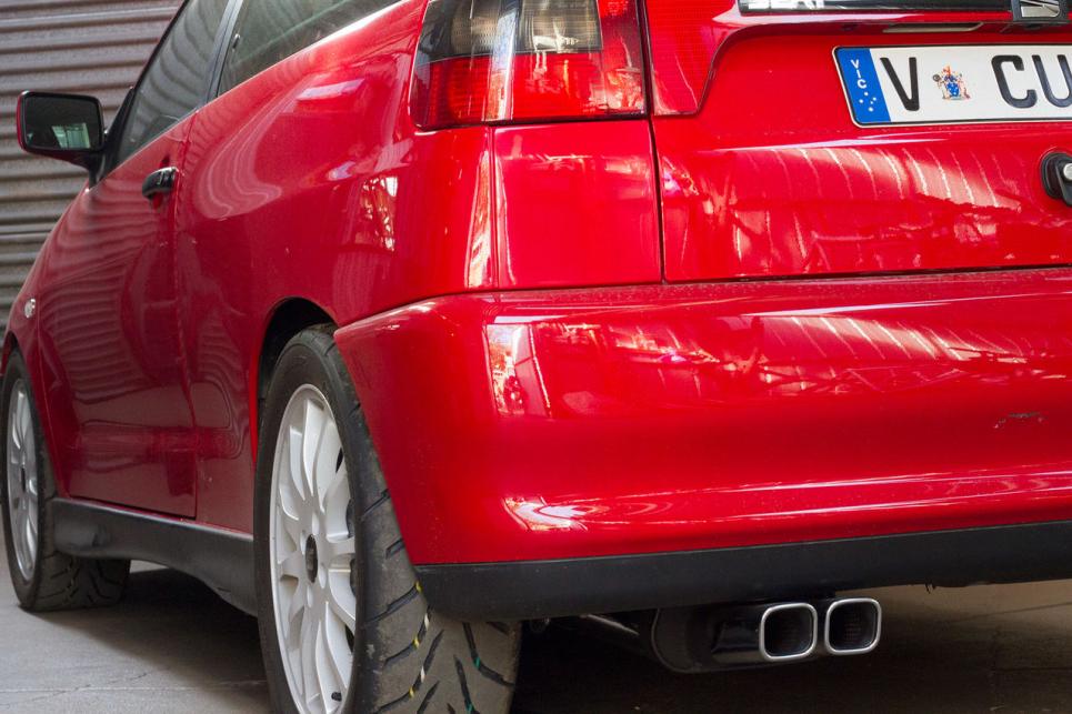

      Exhaust new vs old. The stock tubing looks a bit more restrictive as it bends over the rear axle.

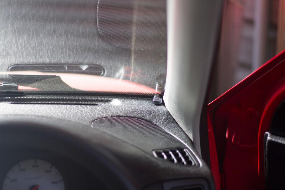

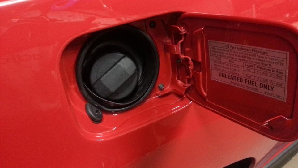

      Headlight sensor, turns parking/tail lights on at dusk and then headlights as it gets darker (or entering undercover parking).

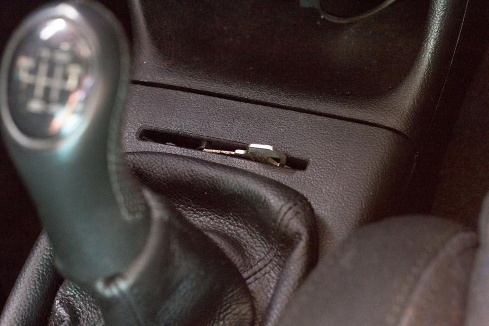

      The once-was CD stacker interface, gone.
      A neat place for my tyre pressure gauge.

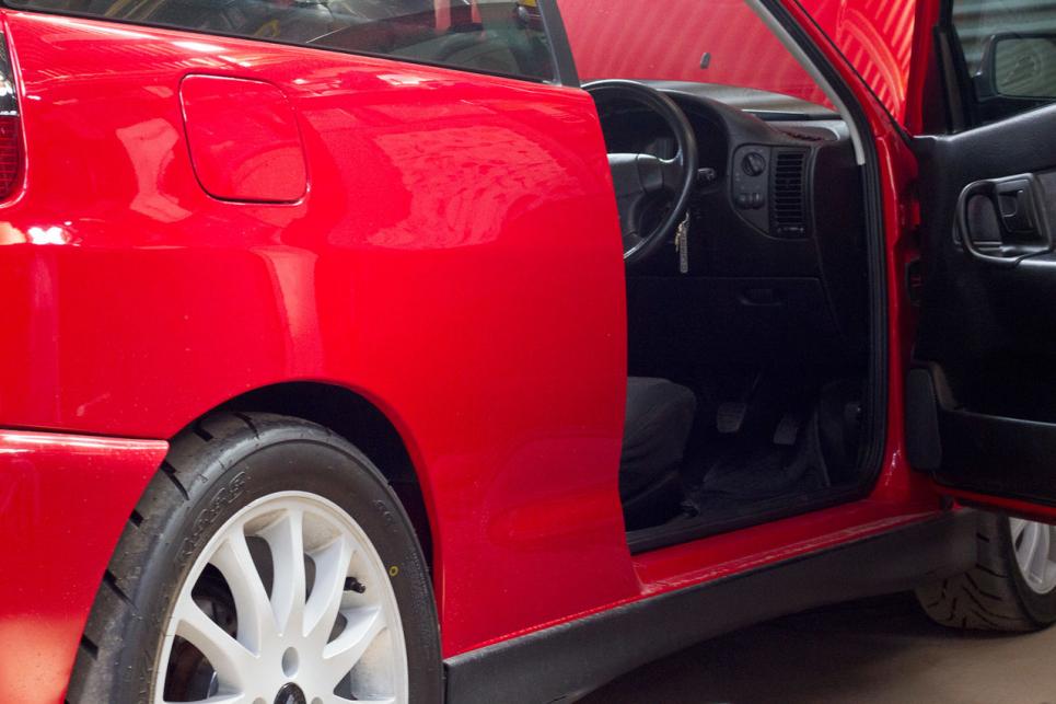

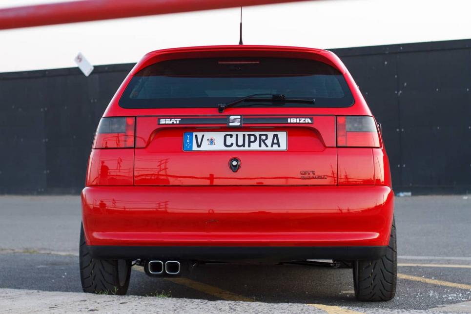

              Waxed the car and snapped some pics before it gets dirty again.
              Rims in the pics are not washed so looking a bit dark.

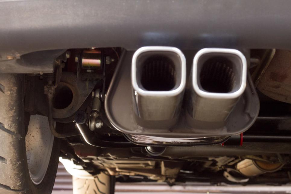

                Looks good Toni, although I'm not a fan of the pipes.
                Phil
                Red 99 Seat Ibiza Cupra Sport, coilovers, K&N (Gone but not forgotten)
                2012 BMW X3 MSport 2.0D
                • #23
                  Sooooooooooooooooo clean!
                  • #24
                    Car is dirty now
                    Pipes too showy you think Phil?
                    I've got the same exhaust on the black cupra so I've grown to like its squareness. Its sound is tuned specific to the ABF engine too.
                    After installing it I was confused why it wasn't as loud as the black cupra.
                    I was kinda pleased yet disappointed at the same time. Because the black car sounds mental. Something didn't add up...
                    Turns out the black car had its cams swapped! No idea what they are.

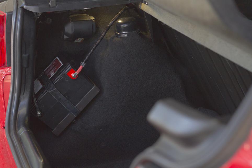

                    Solution: Install 2nd battery to run all electrics inside car and keep main battery fresh for starting.
                    Deep cycle AGM battery, designed for deep discharges and can be mounted sideways. Still waiting on terminal covers to arrive.
                    It's basically hooked up using an isolator which lets the alternator charge up both batteries, then seperates them when ignition is turned off to prevent draining the start up battery.
                    It was quite a bit of effort to put it all together (custom tray/bracket) but I'm happy I was able to install a 2nd battery without compromising any space.

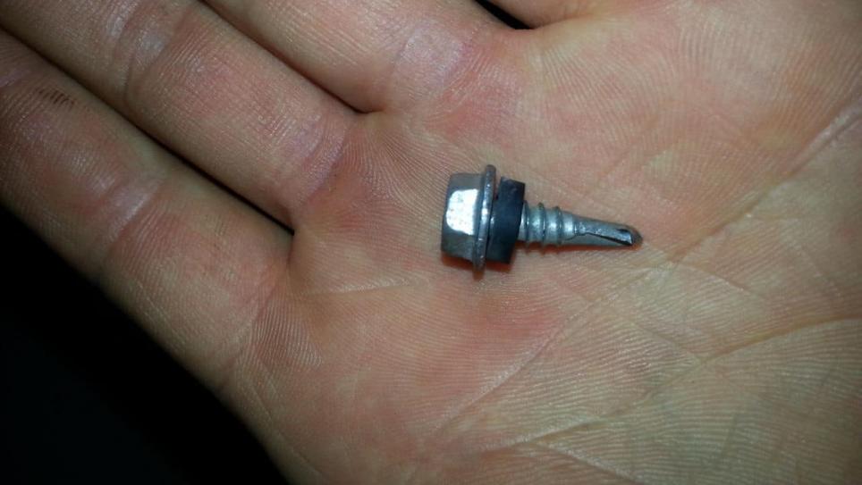

                            So my new tyres picked this up driving along, went in sideways though so disaster averted thank god!

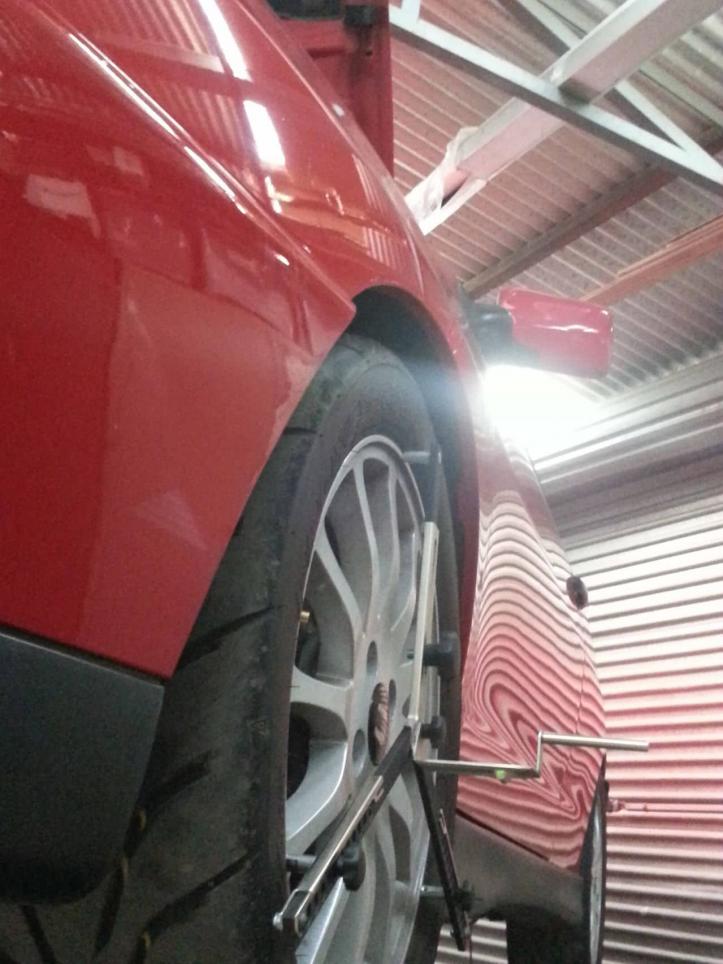

                            Did a few more tweaks to the car.

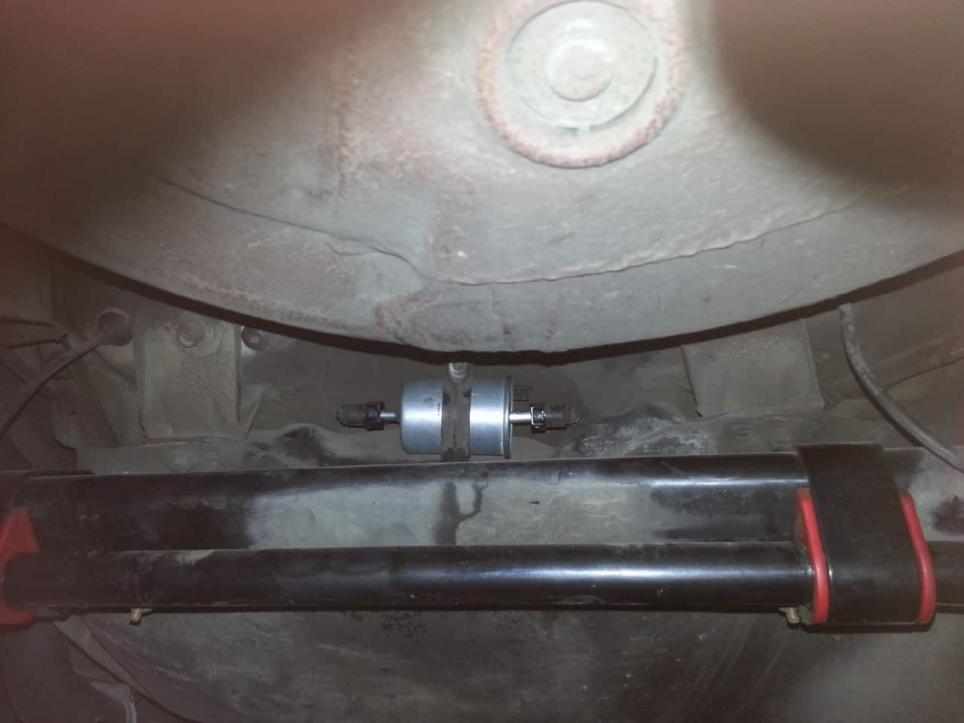

                            Washed and re-oiled the air filter, replaced the fuel filter, redid the corner balance (yet again) and a new wheel alignment setting.
                            Real happy with this new setup the car feels like it's ready to pounce now.
                            Castor +2.7° (thank you adjustable top mounts)
                            Camber -2.1°
                            Toe-out 2mm
                            The car has put on a bit more weight from the 2nd battery install, heavier muffler and chunky rear sway bar. But its good weight! More to the left side and rear.
                            The scales confirmed this,
                            Considering this balance was done with around 25litres less fuel, front to rear weight ratio still improved from 65.5:34.5 to 64.9:35.1
                            Estimating that to be around 20kg worth of rear weight, it would have looked something more like 63.8:36.2
                            A small step closer to that ideal 60:40 weight distribution...
