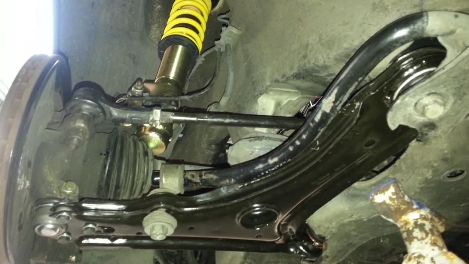

    Encountered a pothole driving unfamiliar roads one night. Hit so hard steering wheel changed position 45degrees.
    Weitec coilover died as a result shortly after so it was time for a suspension overhaul!
    -new coilovers (ST suspensions)
    -new strut bearings
    -new top mount bushes powerflex black series (go hard or go home)

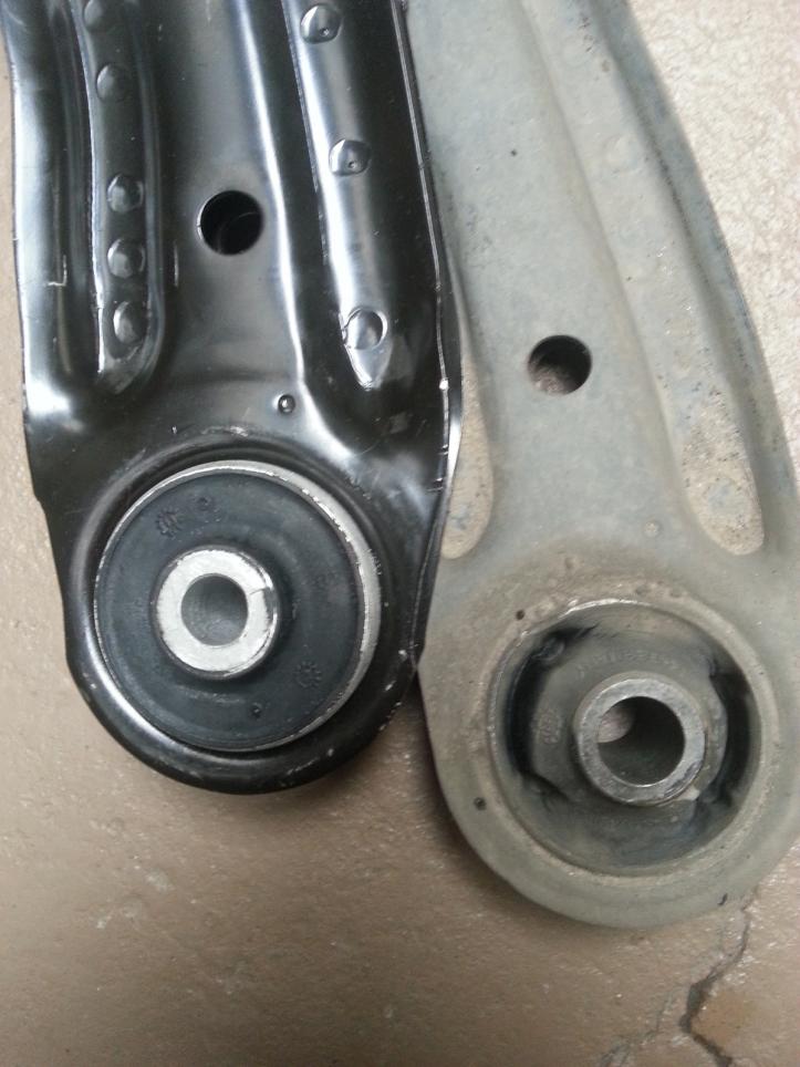

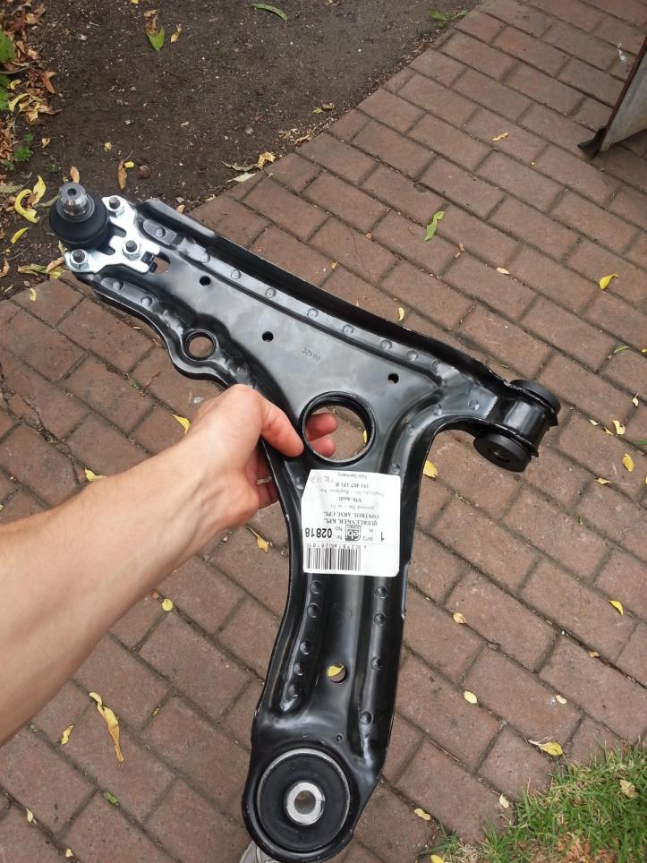

    -new wishbones (Febi Bilstein) fitted with new ball joints, powerflex black front bushings and Audi TT solid rubber rear bushings.
    Steering now felt firmer, smoother and more accurate.

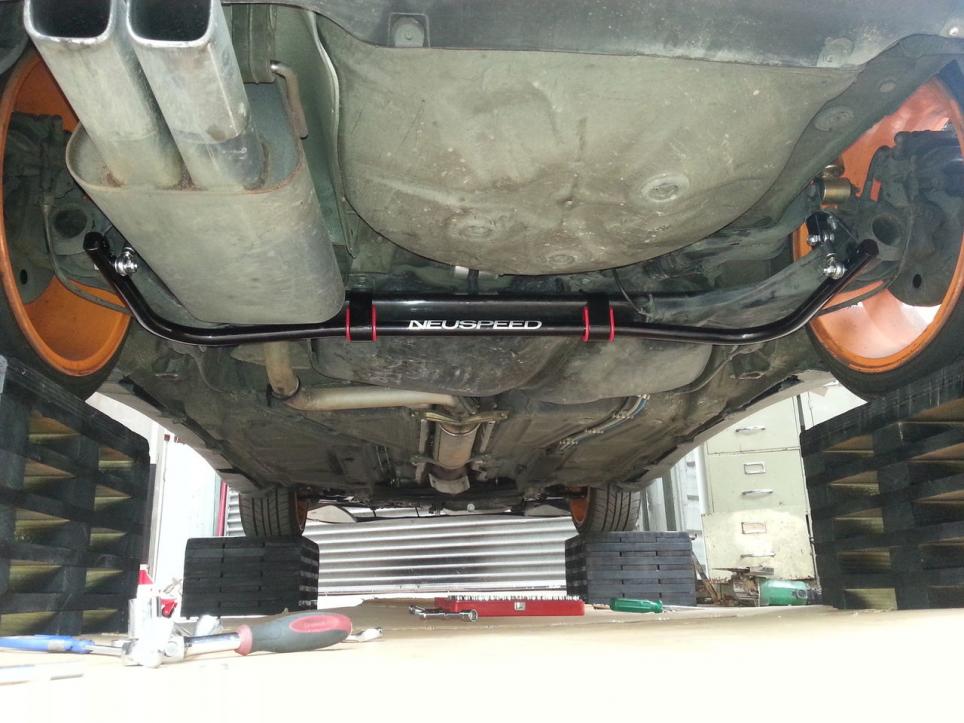

    Then I fitted a rear sway bar to the Ibiza and what a difference!
    The front wheels now dig into turns it's crazy.
    The bar used is a Neuspeed 28mm designed for a golf mk2/3 and made to fit with some simple L shaped brackets.
    There really isn't anything else available for the 6k Ibiza, this bar has 3 settings for stiffness but I'm only able to use the stiffest setting with this setup.
    No complaints!

    Hasn't anyone ever told you how much better a FWD car is with a rear bar? It's my #1 suspension mod. You can adjust the stiffness a little bit by moving the 2 middle mounts closer or further apart. The closer you put them the softer it is.
    I prefer as stiff as possible and with a 28mm bar you've got the thickest/stiffest on the market.
    What are you doing with your old rear shocks?
    Cheers
    Paul
      Cheers
      Paul
      Should have been my first mod too it's made the car come alive!
      Rear shocks are still Weitec, only replaced the the fronts to ST suspension.
        Looks bloody awesome mate. Im jealous!
