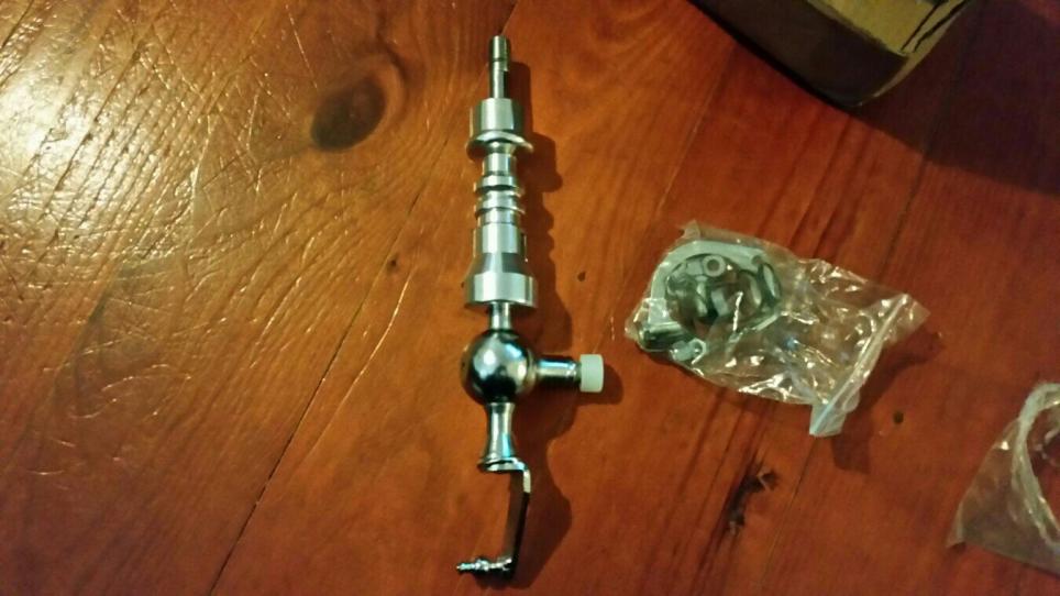

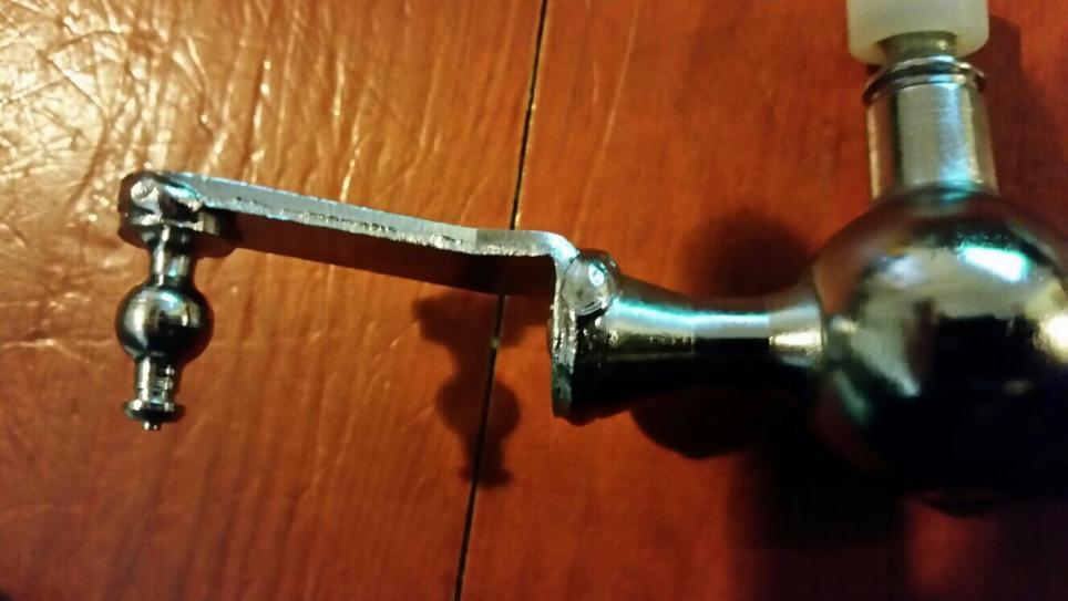

                        This came the other day. Quality seems to be good....Does not come with installation instructions but im sure you could download the b&m instructions. Still going to wait for gruvenparts short shifter before I install it tho
                        Sent from my SM-G900I using Tapatalk
