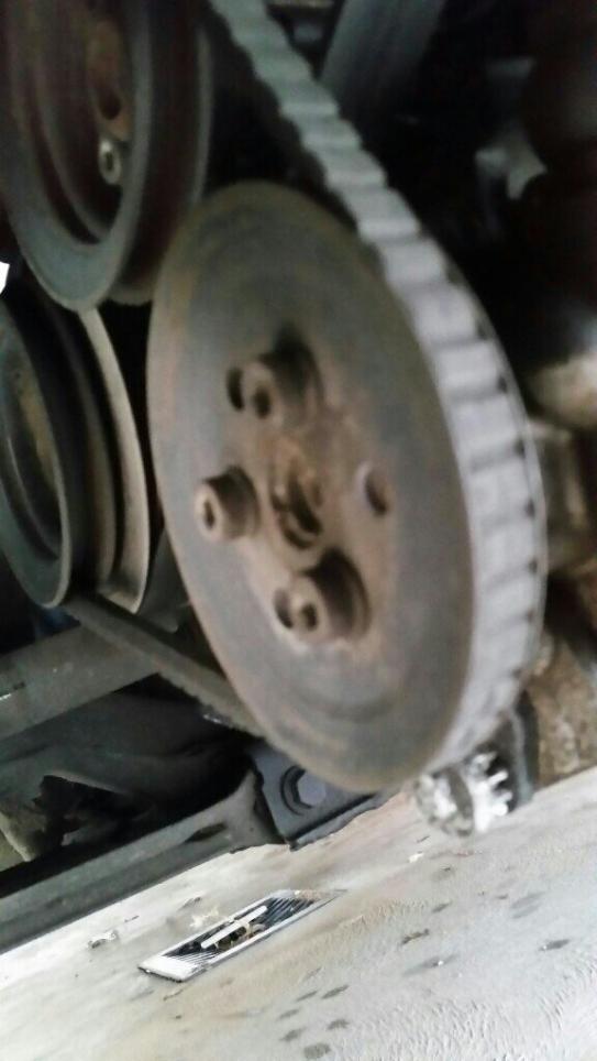

I noticed that this belt is looking in pretty bad shape. I am just trying to get my head around how im going to change it. My abf repair manual doesnt really show how to change it.
would I be rite in thinking that I have to undo these bolts and refit a new belt
I havent done heaps of work on cars before but im not gonna pay someone to do it

Normally there is a bolt that you undo (but not remove),
that enables one item to be swung on the bolt you loosened to release the belt tension
You can then change the belt and re-tension (don't over tension)2012.1 Skoda Octavia VRS DSG Wagon - Carbonio cold air intake and pipe - HPA Motorsports BBK 355mm rotors 6 pot calipers

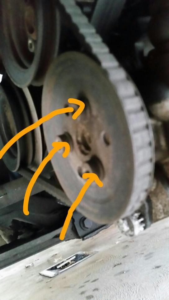

No mate not those. They hold the pulley to the pump. and there's one missing too.Originally posted by Redgti16v View PostThanks for the quick reply....Just to clarify one of these 3 blots you undo and it will allow the belt to come lose and be changed
excuse my mechanical vagueness

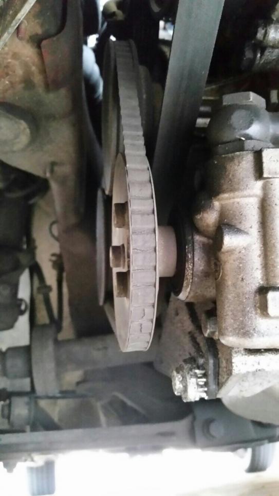

It looks like the adjuster is in your picture but out of focus. There's a 13mm bolt through it. It just needs backing off a touch then you get a bigger spanner on the next bit back and this has teeth on it mated to a bar. That is the adjuster.
Gavin
Nah, bottom right of your picture.Originally posted by Redgti16v View Post
so this bolt here I believe.. What is the chances of finding a replacement bolt for my missing bolt..... When I bought the car it came with the replacement belt how can I be sure its the correct belt?

You can't be sure about the belt, except by taking the old one off and trying it.
The other bolt you can get from a wreckers off a MK3.
Gavin
Okay got it.... just cleaned up around the bolt to see what I am doing I have noticed some of the teeth have been chewed up......Half the bolt is still good. I have tried to adjust with the good teeth but didnt budge. I dont want to destroy anymore of the teeth

Use a file to clean up any burred corners
Try an impact socket (they are the black ones)
They only have 6 six sides and hug the head very tightly
Otherwise you're in a spot of bother for sure
When you get the belt off, compare it's size to the replacement2012.1 Skoda Octavia VRS DSG Wagon - Carbonio cold air intake and pipe - HPA Motorsports BBK 355mm rotors 6 pot calipers

After abit of research I think I have to undo the belt tensioner so there is more play in this other belt.
I dont think I should have to apply that much force make it move. I really have no idea..... someone must have done this before surely

That red arrow is in the wrong place
The bright silver two part bolt at the bottom right is what you need to focus on2012.1 Skoda Octavia VRS DSG Wagon - Carbonio cold air intake and pipe - HPA Motorsports BBK 355mm rotors 6 pot calipers
