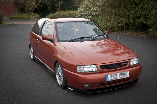

        Does anyone know where I could get one of these lips from?
        I've looked all over ebay, no luck
        Looking for a new project! PM if you have a Golf Mk2 in need of some TLC.
        On 12 month suspension for enjoying my Ibiza GTI too much... 2 months left!
        • #19
          Thats a Cupra lip. I have funny feeling it wont fit on your car as the Cupra runs the face lift smooth one piece bumper.
          • #20
            That's a shame I really do like the look of that lip.
