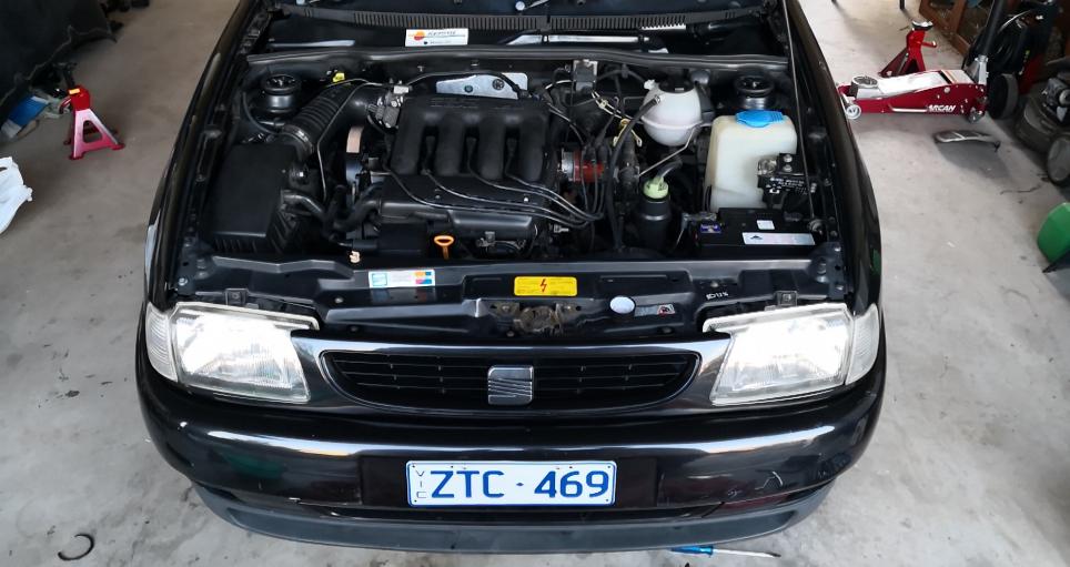

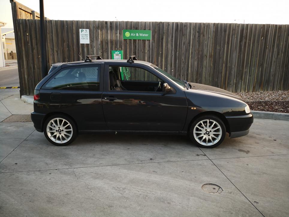

    Waterboy gave me a whole pile of bits and pieces that he'd collected over the years. Of those bits was another bonnet and front bumper with better paint. So I fitted them along with the fog lights.

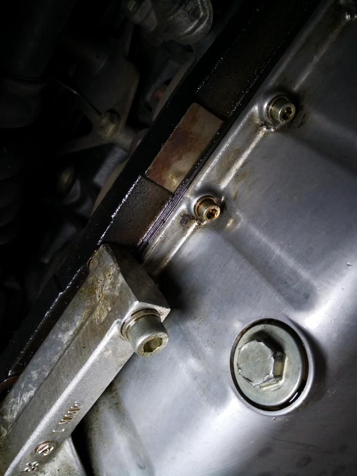

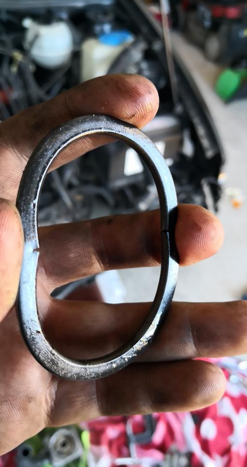

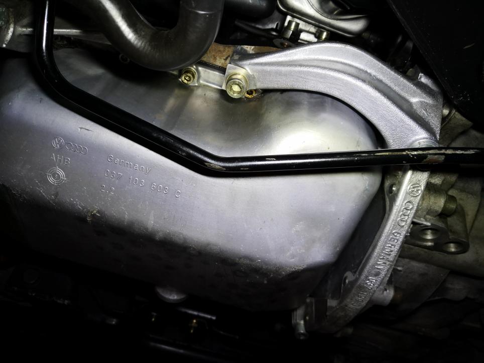

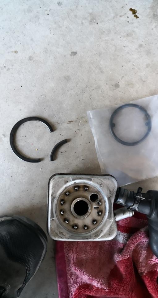

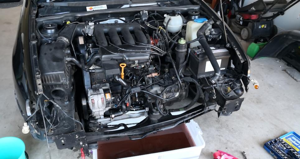

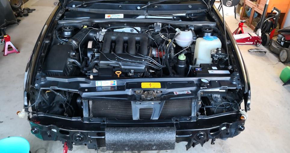

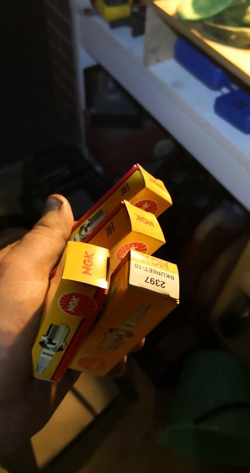

        Whilst getting the car ready for RWC, I had to remedy an oil leak that seemed to be coming from the sump gasket and the oil cooler housing.
        Considering the whole coolant system needs to be drained for this job - May as well replace the hose clamps!
        ...And maybe some new plugs...
        You can see the 'wetness' of the gasket in this pic.
        Something also tells me a new main seal might be in order when the clutch is done.
        All back together!

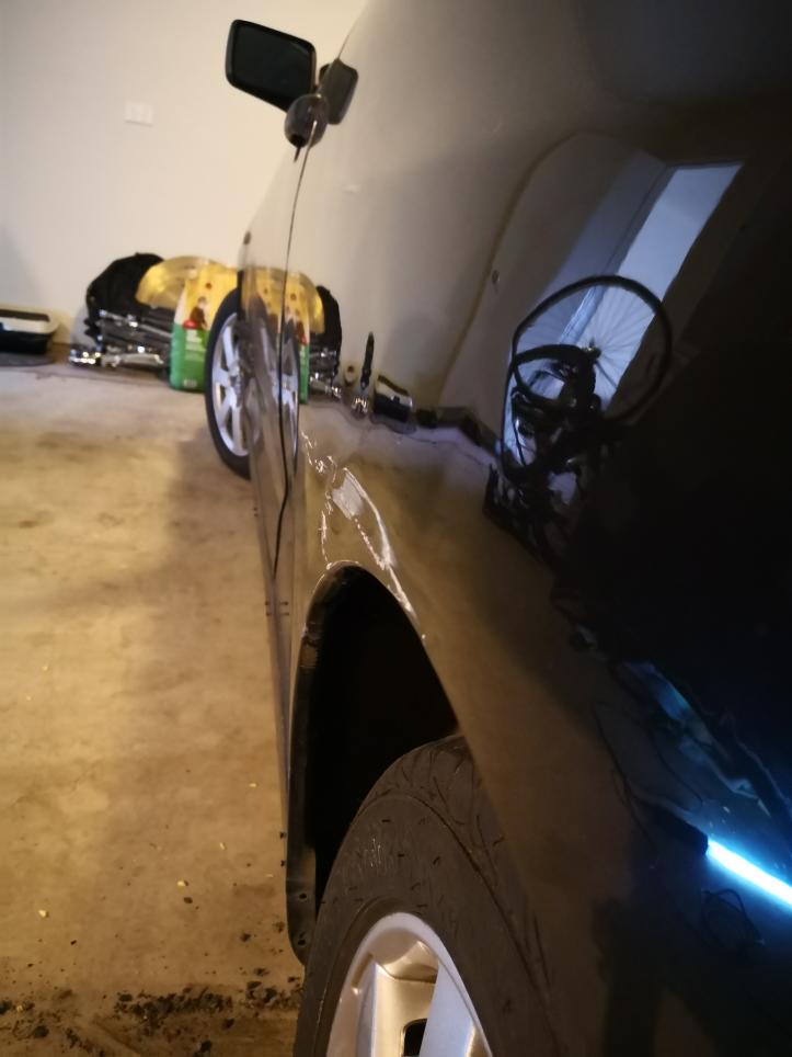

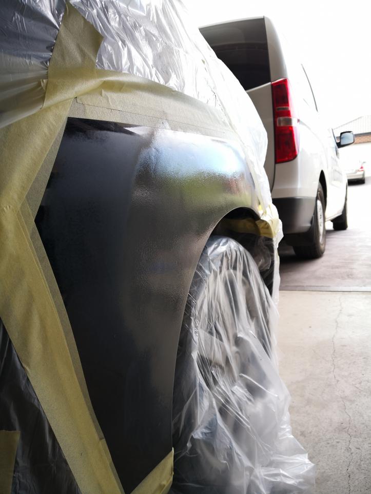

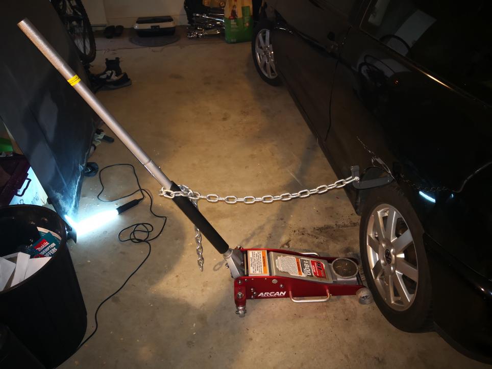

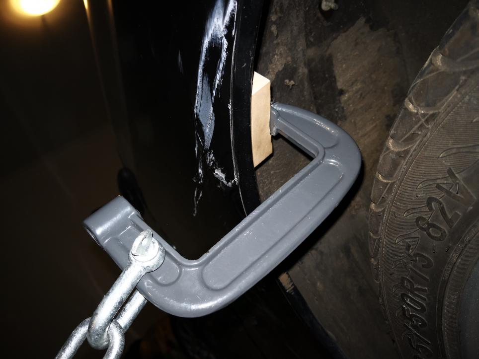

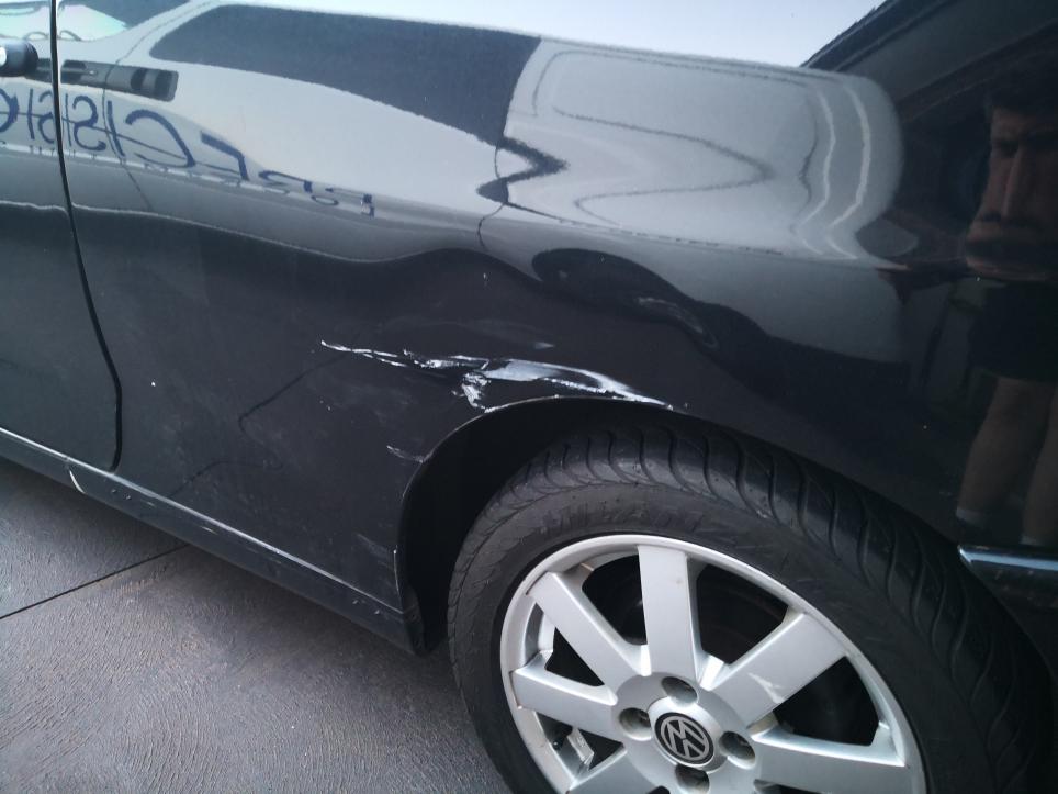

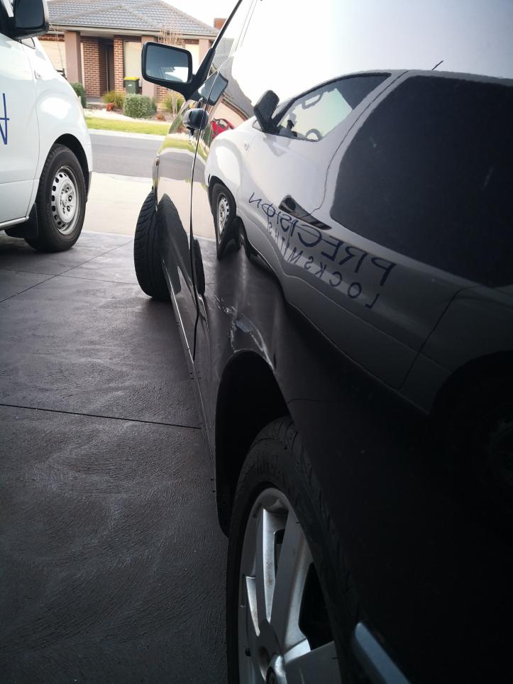

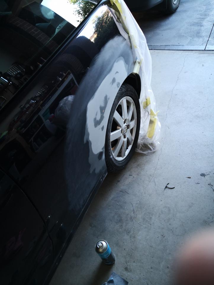

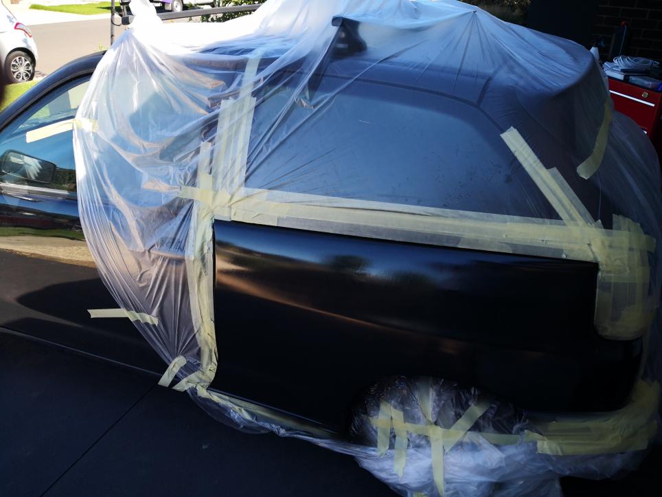

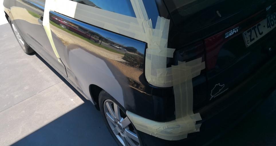

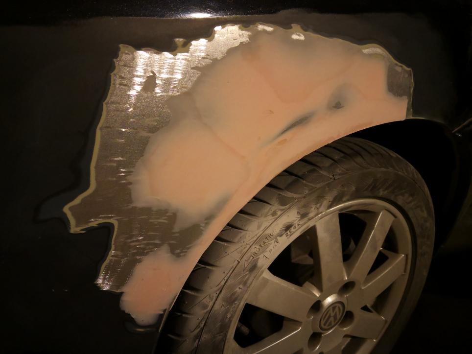

          Dark day... A certain member of the house hold in a rush to go to work did something a little inconvenient...
          With a 'cash' quote given in excess of $1200 to repair, I figured I'd take things into my own hands...
          I rigged up a dent pulling system with my jack. That's just a $15 craftright G clamp with the thread cut off it and a piece of timber screwed onto the pulling side so it doesn't scar the metal/panel.
          The clear needs a good wet sand and polish - Which will definitely be a good learning experience for me. All in all I think the repair has turned out quite well, although I think in the long run a full respray of the car (considering the condition of the paint on the roof and hatch) may be in order.

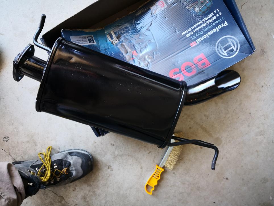

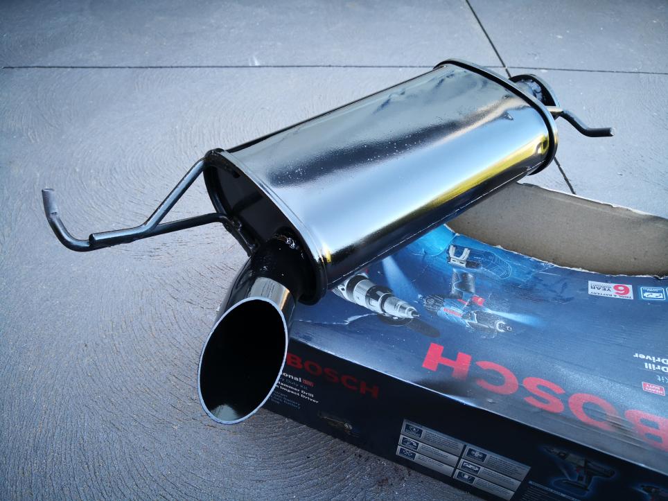

            Good News! Exciting things to put onto the car.
            A bolt on muffler from woody (I stripped it completely and repainted it in high temp enamel gloss black)
            AND
            Ronals!!!!!!! OEM for the win!
