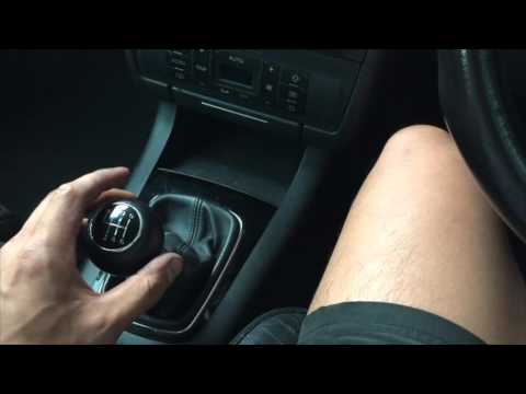

              Stock shifter linkages
              - dieselgeek sigma 6 short shift kit. What a lovely, high quality piece of kit this is! Easy to install (should've just gone with instinct with the bolt off and on process) & adjustment instructions were easy to follow. Excellent reduction in shift travel, no notchiness to be felt and looks great! If only all the rest of the crud wasn't ruining the shiny new metal.
              will link to a video once I figure out how to superimpose the two together.

                stock shifter throw compared to dieselgeek sigma 6 throw. reduced? yup! notchy? nope! easy to get into all gears? yup!

                    woooooo! have finally been able to have some fun with the car and al i can say is that the sigma 6 short shift makes a WORLD of difference. I need to teach myself to push the pedals faster with the MUCH shorter throw. i love it.
                    Handling is most noticeable when turning and the car is a lot more eager to take the turn and feels like it pushes into it. I read some information saying that upgrading the rear swaybar only to anything more than 19mm = skittish front end when driving straight but i can't feel any of that. All is solid there.
