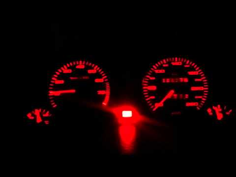

So I've had this car for a bit over a year now, and I've slowly worked out all the kinks and issues with it.
Car in question is a '94 Audi 80 V6 2.6 (ABC Engine) - Same as the early A4's, A6's, VW Passat's which had the 2.6 engine.
Right now I'm down to the last one essentially.
Basically whenever the car is cold started (that is the engine is cold) it will run really rough, as if it's stalling or misfiring until it warms up (about 50-60c) going by the temperature gauge on the dash.
I do get a check engine light too but that dissapears really soon after starting. I have a feeling this is unrelated though, not sure.
