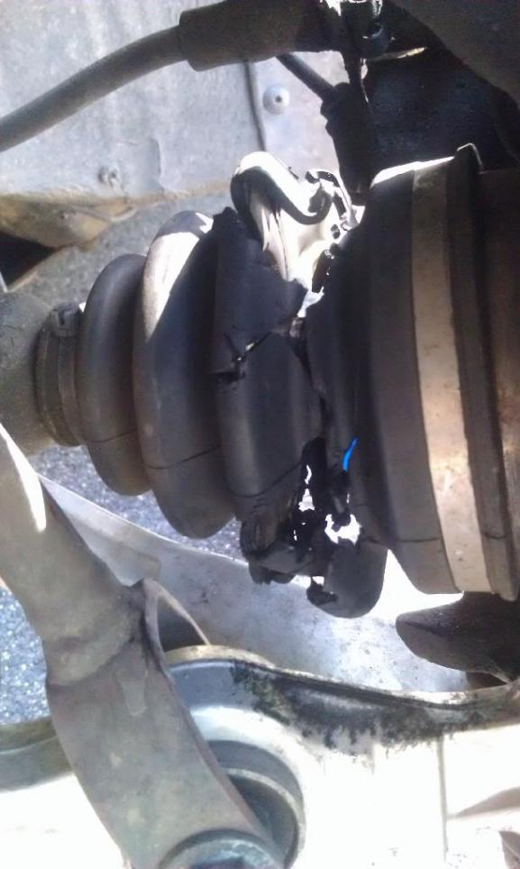

    After having a couple of recent dramas with our B5 wagon, I thought I'd let you in on them. After doing a few 100km one weekend, the following morning, the driveshaft "fell" out of the left CV while my wife was at the shops. SO I fixed that in the street. Luckily I had a spare boot at home.

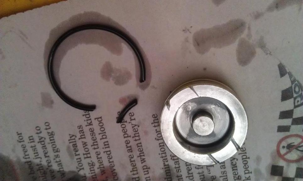

    And behold, when I dropped the oil pan I found the missing piece of this clip.

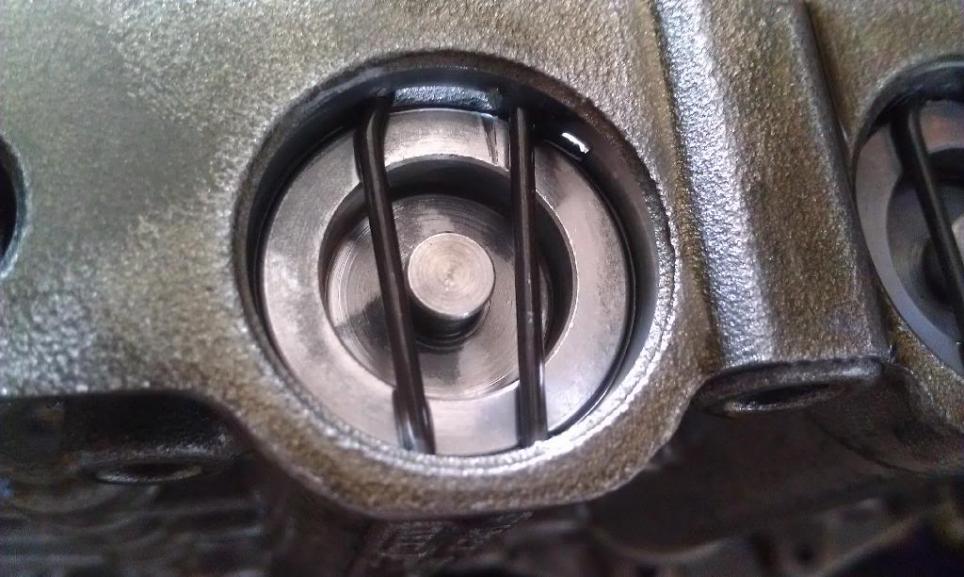

    Dead O ring poking out from valve body at 1 O'clock.

          You can just see the O ring sticking out at 1 oclock
          The clip that holds it in had snapped/broken off and was stuck on a magnet in the oil pan.. So maybe there was some stress on one side that caused the O ring to pop out?

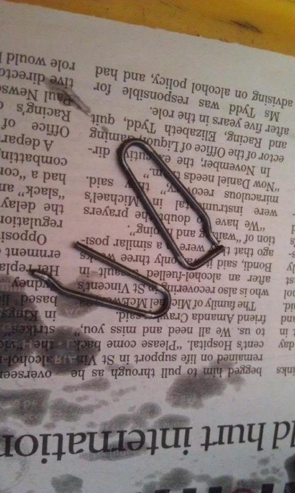

          Picked up an O ring from transmission shop and he gave me a piece of steel to fashion a clip from.
          Pictures of this to follow.
          Looks horrible but I am a function over aesthetics guy
