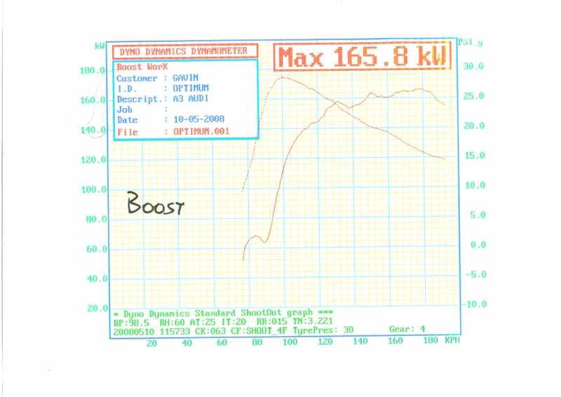

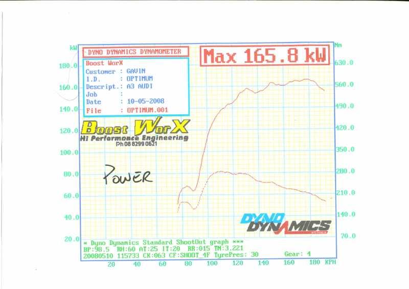

      good work!
      27psi i hope the shaft has been upgraded unlike the eurospec e05 that used the regular k03 shaft with upgraded cold side impeller.

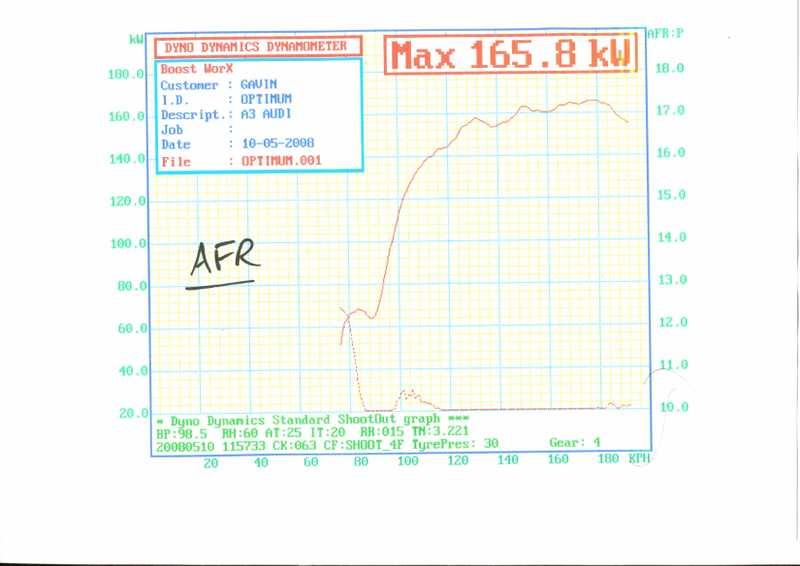

      can that AFR graph show anything below 10:1?. you'd think that on the base map it'd be running lean even with 380cc/2.75" ID maf and 4bar. 380cc at 4 bar would be more like 420 or thereabouts so i guess thats why its rich, but still your maf is sort of "scaled" to go with the bigger injectors, hmmmmm. vagcom it and see what you lambda readings are, it looks like your afr drops well below 10:1, its just the graph isnt showing it. anyway.......
