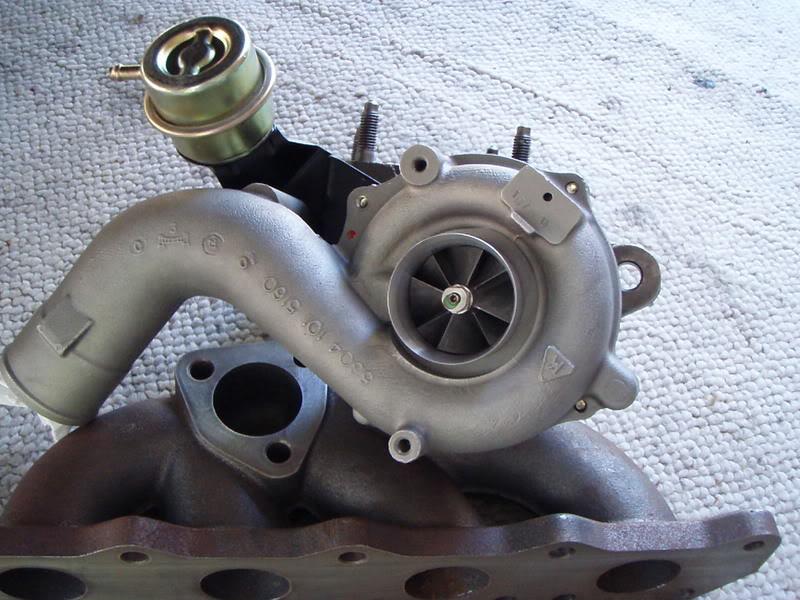

          New turbo

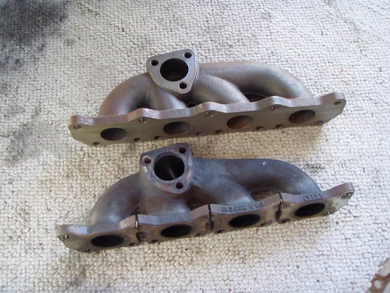

          New and old manifolds.

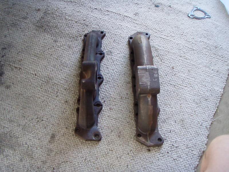

            Left to right. New S3 injectors, early S3 injectors and std ones.
            The new S3 ones were about 12mm shorter so had to reduce the height of the fuel rail mounts on the manifold to make them fit.
            Better flow in the ATP manifold, I think so!

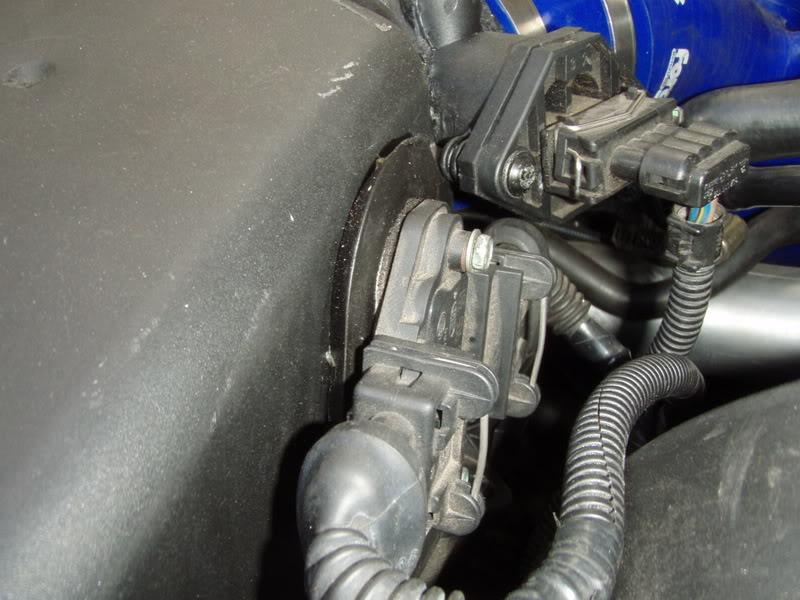

                AGU MAF element grafted into S3 housing.

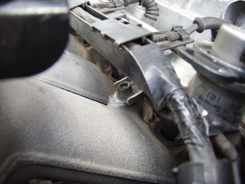

                Fuel rail mount that had to be shortened to get the injectors to fit.
