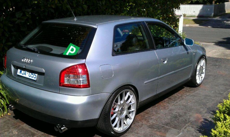

    Bought this car in 2009 after owning a toyota soarer for one month and a civic for two months
    originallycame with some cheap looking angel eye headlights, LED rear lights and TT 17" wheels.
    Since then
    Revo stage 1
    Dyno'd 117kw atw
    Engine
    -Mahle Motorsport pistons - INA SPEC 82.5mm
    -DM Forged H-Beam Connecting Rods - 144/20mm
    -ARP Headstuds
    -ARP head bolts
    -ARP crank bolt
    -Calico Coated Connecting Rod and Main Bearing Kit
    -INA Engineering Master Gasket Set
    -INA Fluidampr
    -INA TFSI coilpack with adapters
    Turbo Setup
    -Frankenturbo F23 Hybrid K04
    -Frankenturbo Exhaust Manifold
    Cooling
    -Wellycooler intercooler with 2.5" piping
    -Mocal 8 row oil cooler with sandwich plate and thermostat
    -BM sport gearbox cooler
    Fueling and Intake
    -044 Bosch fuel pump
    -034 Motorsport surge fuel tank
    -Bosch 440cc injectors
    -3" MAF
    Exhaust
    3" stainless steel downpipe
    High Flow Cat
    2.5" cat-back with quad exhaust outlet - custom
    Chassis
    -ECS Polyurethane Dog-bone Mount
    -Quaife Limited Slip Differential
    Suspension
    -Weitec HICON Gt coilovers
    -H'n'R Front and Rear sway bar f-22mm,r-25mm
    Wheels
    -19x8.5 et35 BBS CH reps
    Electronics
    -Pioneer 7" Single Din DVD
    -Cadence 12" sub
    -NewSouth Performance boost guage
    -AEM AFR guage
    Braking
    -Porsche Boxster Caliper
    -312mm rotors
    -Brembo pads
    -HEL Stainless Steel Brake Lines
    Cosmetics
    -Facelift Headlights
    -LED brake lights
    Wish List
    -RS4 Flat bottom steering wheel, in alcantra
    -Recaro bucket seats
    -water and meth injection
    -roll cage
    -strip interior
