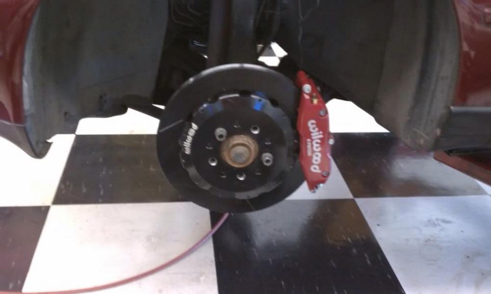

    Haven't done anything to the engine yet as I'm saving up for the engine bits and clutch etc.
    I have purchased this directly through a friend who works for wilwood and should get it installed this week if not the next
    They're wilwood 332mm two piece rotors with 6 pot calipers.

        they look sweet, should be a massive difference and probably necessary based on the turbo your running

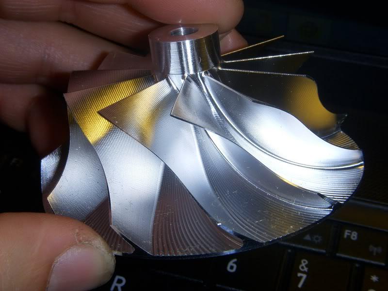

                        Power? Well, to be honest..I'd be happy with 290-300hp at all 4 wheels at around 22-24psi..my TD05H 20G's compressor is rated to around 42lbs/min ie 640cfm. Was said to make as much power as a GT2871R...just a tad lazier on the spool.
                        Once I've achieved that...I'm aiming 330-350whp with a hybrid MHI turbo I'm planning to build once I've sort out some sh*t I've gotta go through with my work visa.
                        Here's a pic of the billet compressor wheel for that hybrid turbo:-

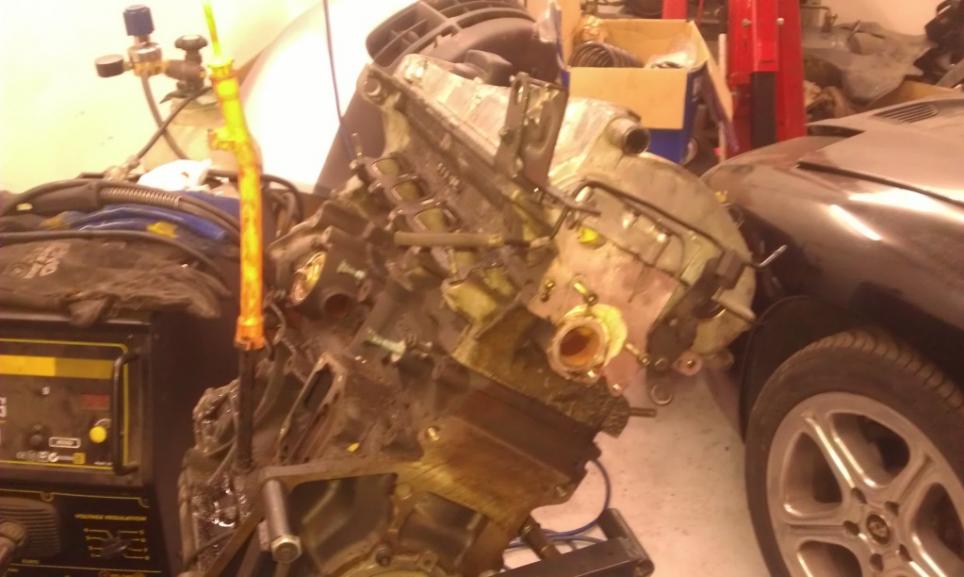

                          old vs new
                          block is stripped, next stage is sending it to machinist and boring pistons as well as balancing all the parts
                          and cleaning all the oil caked on the block from the last 12 years

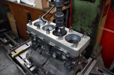

                            Are they gonna use a deck/torque plate when reboring the block?

                                All high performance engine rebuild shouldn't skip using this when reboring(even honing for some).
                                What a deck plate/torque plate does is simulate distortion as if a cylinder head is torqued to the block.. The whole idea is to get a true "roundness" when the bore is cut open with the deck plate/torque plate in place..
                                The engine builder should know this but I'm not surprised he doesn't have a deck plate/torque plate as a high performance 1.8T engine rebuild would be pretty rare unlike RB26, SR20s etc which means no point in making one.
                                Here's a pic just to give you an idea
                                Integrated engineering sells them but shipping rates should be interesting lol
