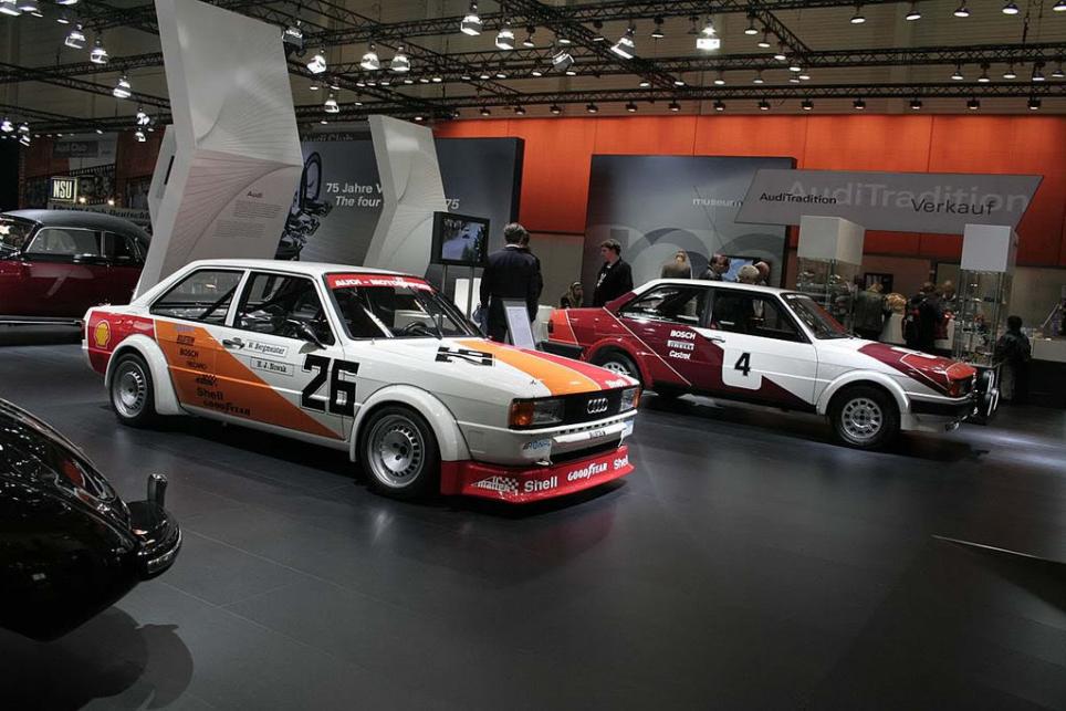

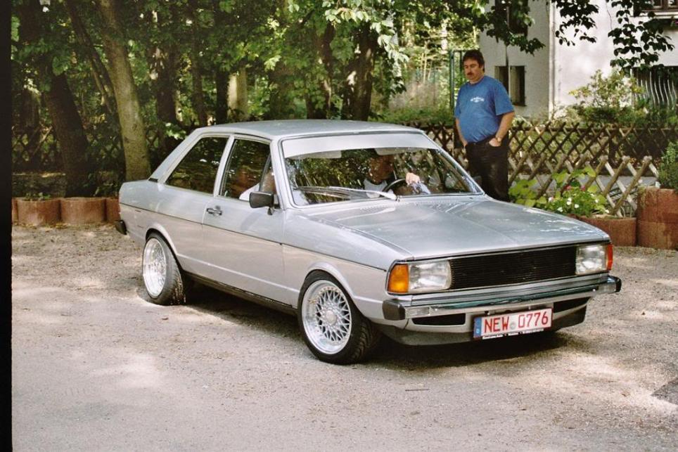

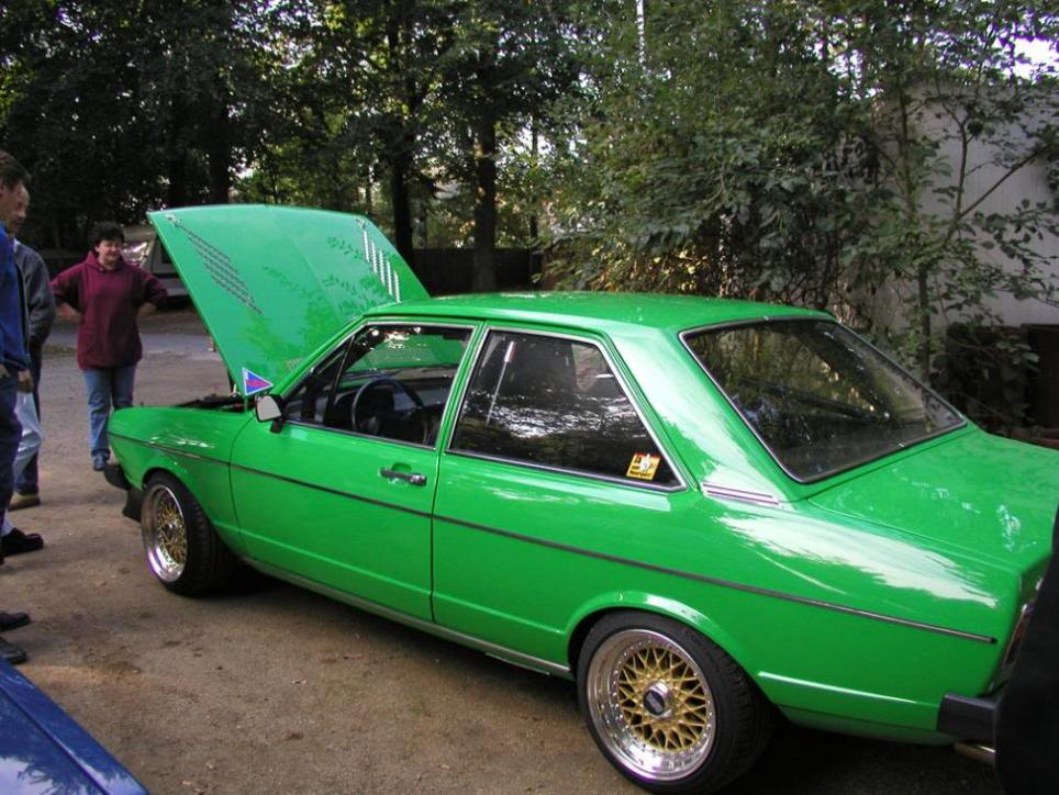

        good thinking agent 80. I jsut rememberd i had a couple pics I found from the other day,. THough I'd put em up.
        btw not that I even know what models they are!!
        I so want one of those orange ones!!!

          Great Pics Nick80, I never knew there was a two door Fox!!! And am so glad to see a 80 (aka 5+5) 2 door in race spec!!!
          My uncle used to own a VW Audi BMW specialist years ago and he told me how the 5+5 (80) came as Quattro before the 'Quattro' came out, but you were only able to buy that model in Germany. (The Quattro was based on the 5+5 (80) floor plan)
          I wonder if the 80 (5+5) came in a 2 door?
          And, where can I get hold of the bits to convert my 5+5 (80) into a Quattro. (My uncle has told me its posible by just bolting the parts straight up) Does anyone here have experience in that type of mod, ide really appreciate some feed back on this before I start buying parts from over seas. Thanks
          Again, great pics Nick!!!!

              No way that was awd he obviously shopped the floorpan

                    Well sort off, what he did was put the type 81/fox body on a shortened type 85 quattro chassis,
                    What the owner did is quite mad, you should see the build photo's
                    There is a huge build up thread, will look for it
