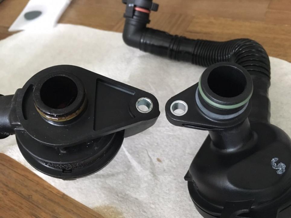

    So turns out I had a hole in one of my pcv valve diaphragms and was making a complete whistle sound when at idle.
    Started out thinking it was a warn bearing somewhere but as it got louder in time I had to do something
    Unfortunately Audi or any other company don’t make a service kit with new seals and diaphragms, and a new PCV valve will set you back from $400 to $600.

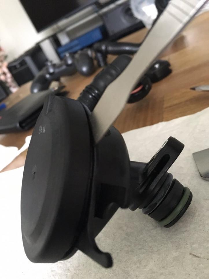

    But after opening one up and seeing if it’s possible to fix it I couldn’t help notice that they look very similar to what you would find on a Mercedes M156 6.2 V8
    So I thought I go and buy one and compare the two being that a Mercedes valve cost only $130.
    Not sure if I’m the first in the world to discover this but it’s definitely a money saver. And your using basically genuine parts.

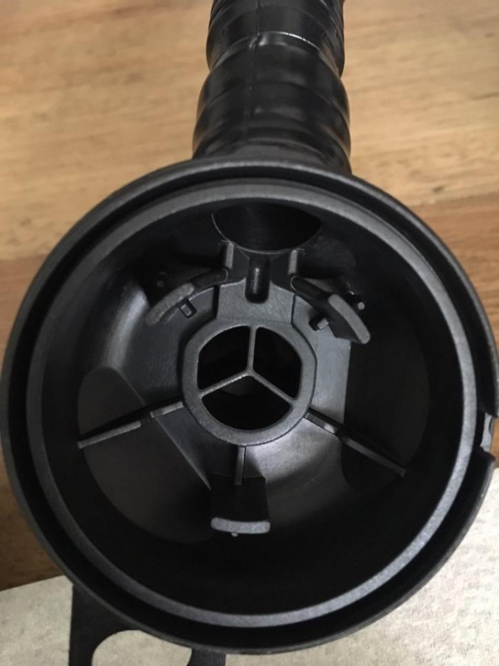

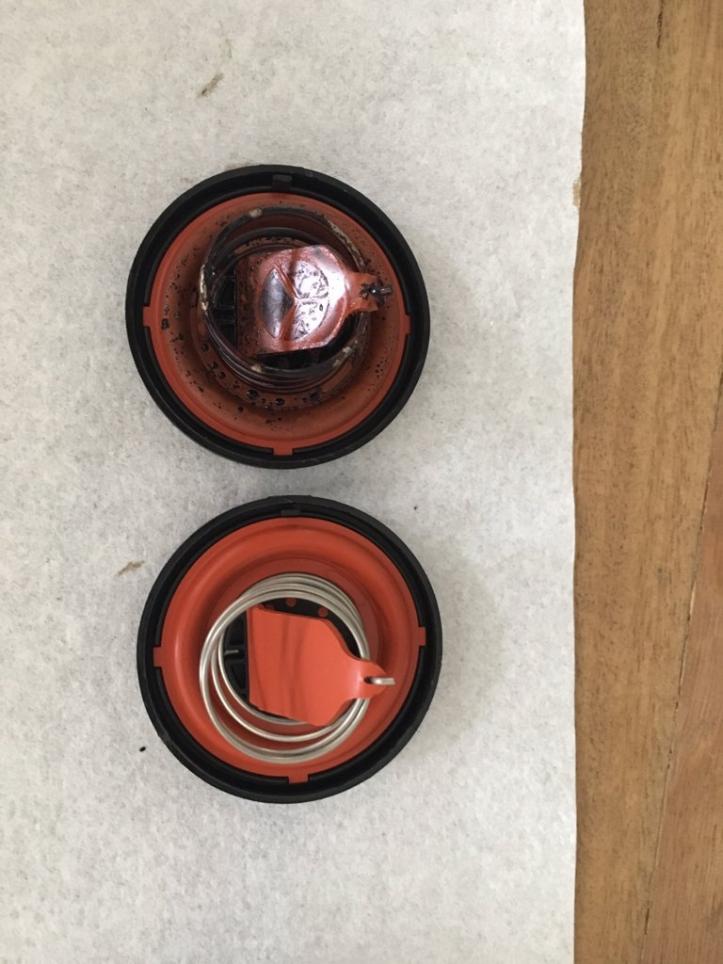

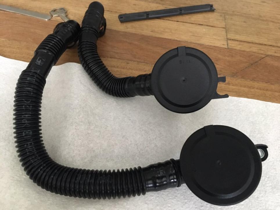

    “The Mercedes valve is the top one”
    As you can see ones opened they are completely identical!
    Audi valve
    Mercedes valve

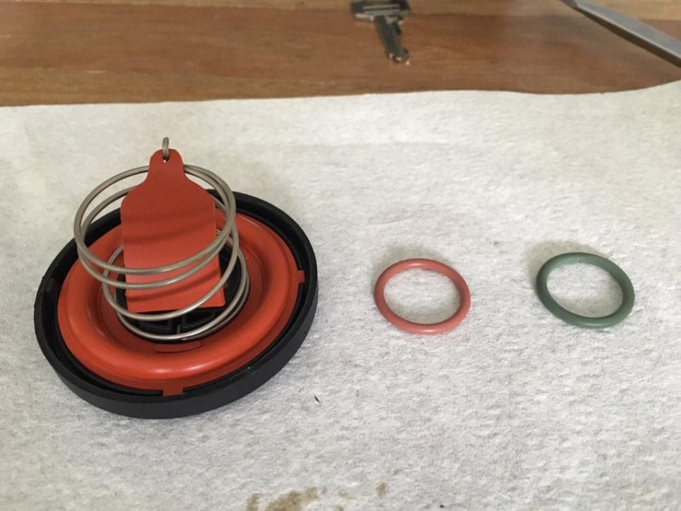

    Ones you strip off all the seals, cap and diaphragm you have a full Audi RS5 PCV valve rebuild kit for a fraction of the cost for a new one

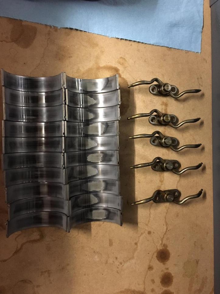

          look at the AMG M156 engine. Head bolt issues, cam lobe issues. Internal oil seal issues. And let’s not forget the BMW rod bearing issue, throttle actuator failures, VANOS failures, oil pump failures omg the list goes on.
          My point is, they all have issues and if I was to chose what ones to go wrong, I’d take the Audi problems any day.
          I’m going to hang these up in the garage to remind me why I’ll never by a BMW ever again
          These where only 100,000kms

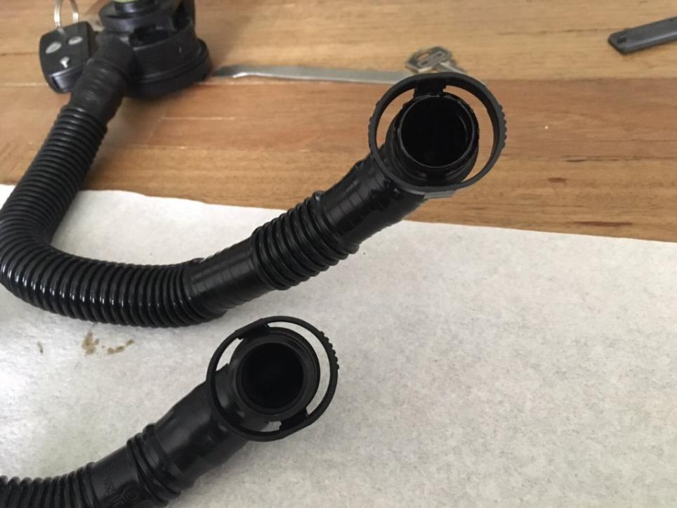

              I have to admit it was my fault why the PCV vale’s failed.
              I taped up the breather holes when I was cleaning the engine and forgot to take the tape off.
